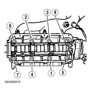

Can i get the torque specs for the head bolts and intake manifold bolts for my 1992 audi 100 cs v6

Hi there, Inlet manifold bolts are 15 Ft/Lb or 20 Nm Head bolts are 1st step. 44Ft/Lb or 60Nm 2nd step Additional 1/2 turn. New head bolts should be used.
