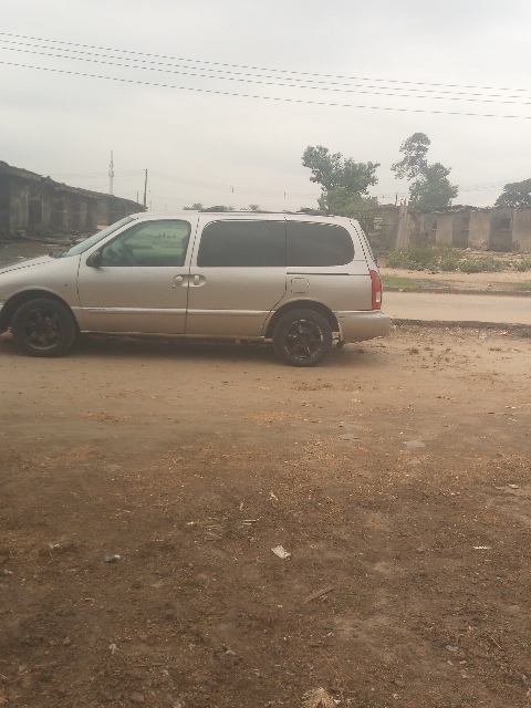

Good day,
The van's engine start well but it cannot move when i put the jar and raise it.
What is the course?

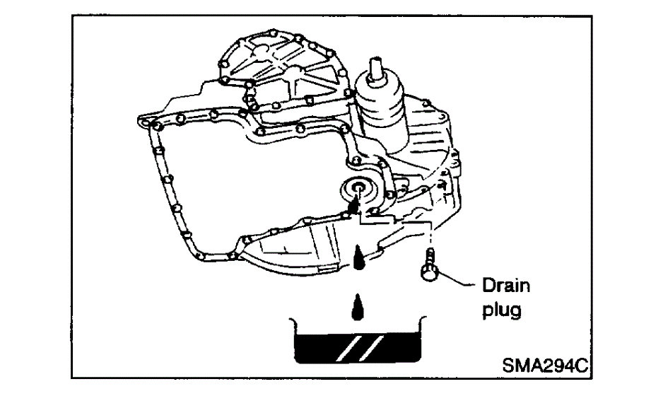

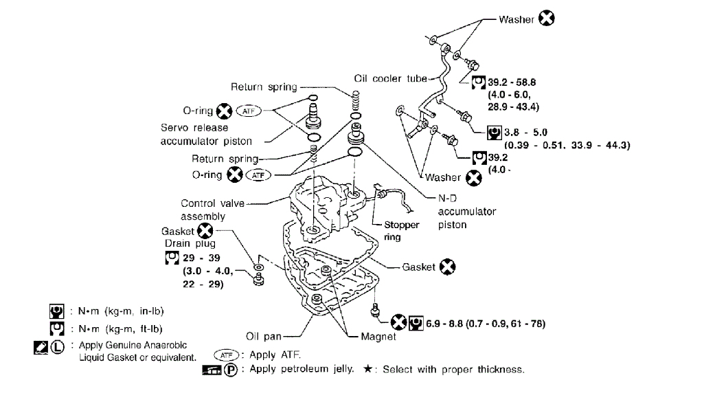

Okay, I would start by changing the fluid and the filter.
Changing A/T Fluid
1. Warm up A/T fluid.
2. Stop engine.
3. Drain A/T fluid from drain plug and refill with new A/T fluid. Measure amount of fluid drained and refill with equal amount of new fluid.
Fluid grade:
NISSAN Matic "D" (Continental U.S. and Alaska) or Canada NISSAN Automatic Transmission Fluid.
Fluid capacity (With torque converter): 9.4 l (10 US qt, 8-1/4 Imp qt)
Drain plug:
Tightening Torque: 29 - 39 N.m (3.0 - 4.0 kg-m, 22 - 29 ft-lb)
4. Run engine at idle speed for 5 minutes.
5. Check fluid level and condition. Refer to "Checking A/T Fluid". If fluid is still dirty, repeat steps 2 through 5.
