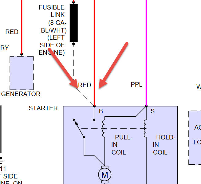

Replacing starter. I have an extra same large gauge wire reluctant attaching to hot wire. Any ideas where it goes?

See picture for help. Probably you left off fusible link wire.
Image (Click to make bigger)
