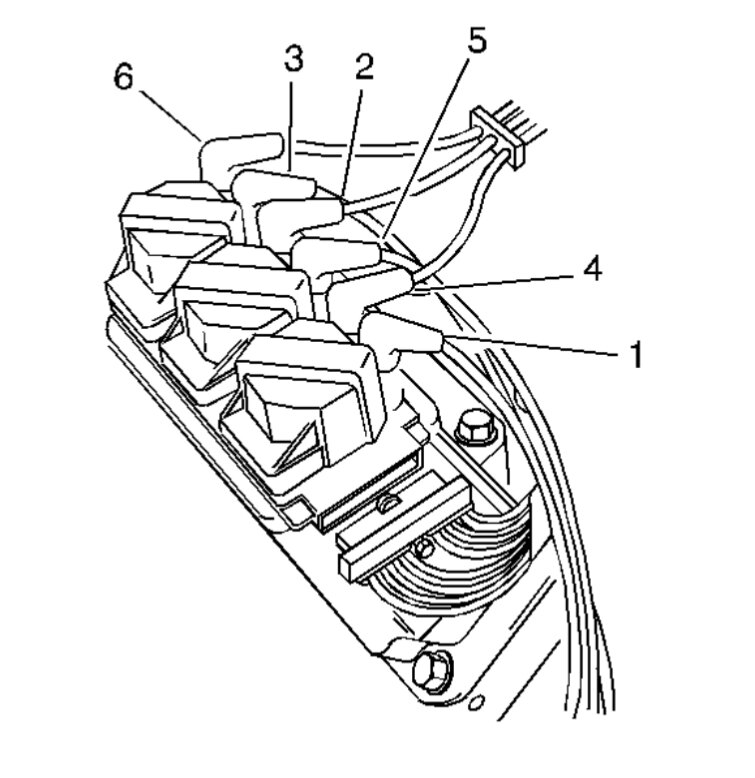

A friend unhooked the spark plug wires and I replaced the spark plugs. Now I don't know the sequence for the new wires, and I need a diagram and the firing sequence. Thank you so much for your help. David

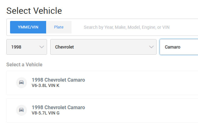

Hi:
We would be happy to help and provide the directions/pics, However, we need to know the engine size. There were two options, a 3.8 V6 or a 5.7 V8.
Let us know which one you are working with.
Take care,m
See pic below

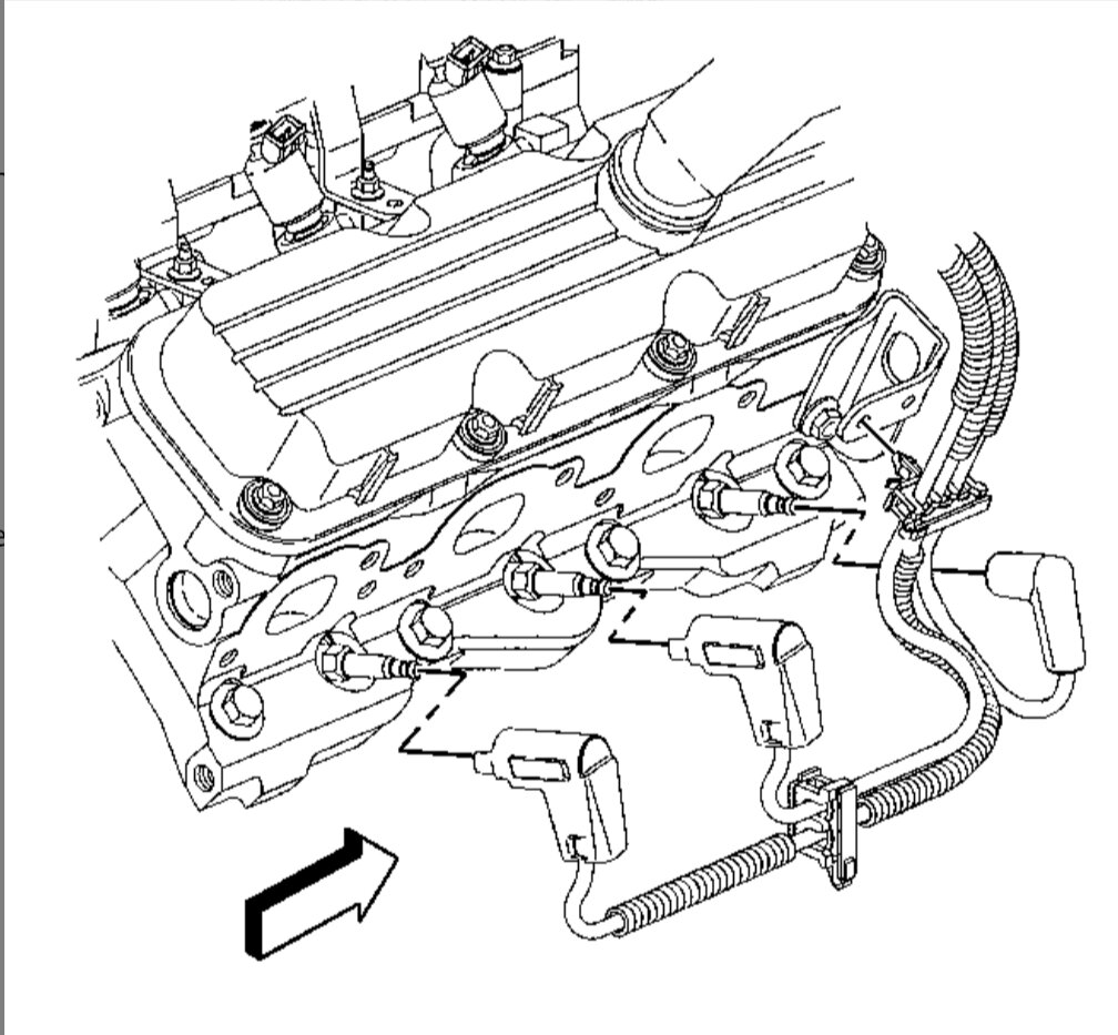

You don't state the engine, but since your looking for the firing order of spark plugs it is likely the 3.8 v6, as the v8 had 8 coils with very short plug wires, one above every cylinder. The firing order and wire info is as follows for the V6:
Driver Side would be cylinders 1,3,5
Passenger side would be cylinders 2,4,6
The firing order is 1-6-5-4-3-2
