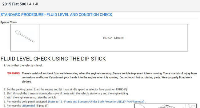

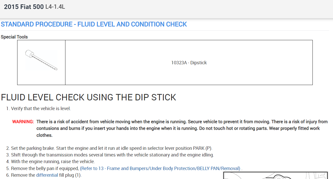

Can you send me the step-by-step directions to change (drain and fill) the ATF in my vehicle listed above?
Thanks,
Jon
(if you have directions for flushing the ATF it would be great to have as well)
Aug 29, 2024 at 9:45 PM
  • 55,433 POSTS

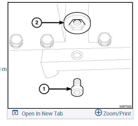

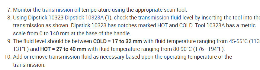

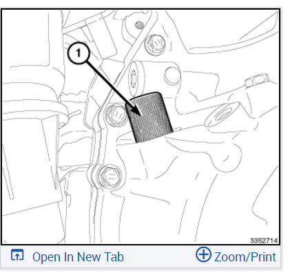

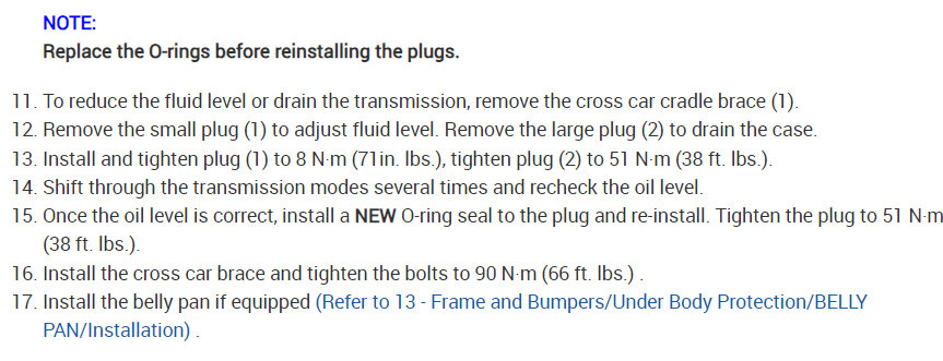

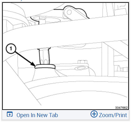

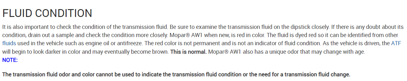

Here is the fluid type do not use any other fluid than recommended. Here is a generic guide to help you step by step with instructions in the diagrams below to show you how on your car:
C510/C514 - Service Fill
Mopar C635 DDCT/MTX Transmission Fluid
AW60T/6F25 - Service Fill - Mopar AW1
Check out the images (below). Let us know if you need anything else.
