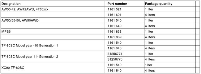

ATF capacity?
140,000 MILES • 3.2L • 6 CYL • 4WD • AUTOMATIC
BHAMDOC1973
  • 2,007 POSTS
For a drain and fill how much should i expect and which fluid is used plz
Oct 1, 2025 at 8:14 AM
KRAKENAUTO
  • 108 POSTS
I have attached the fluid capacities depending which automatic transmission you have. If you can provide the VIN I can see if I can determine the exact one you have easier.
Oct 1, 2025 at 12:02 PM
BHAMDOC1973
  • 2,007 POSTS
YV4902DZXC2250184. Thanks
Oct 1, 2025 at 9:31 PM
  • 55,594 POSTS
The automatic transmission (TF-80SC / related) in a 2012 Volvo XC60 holds approximately 7.0 liters of ATF.
