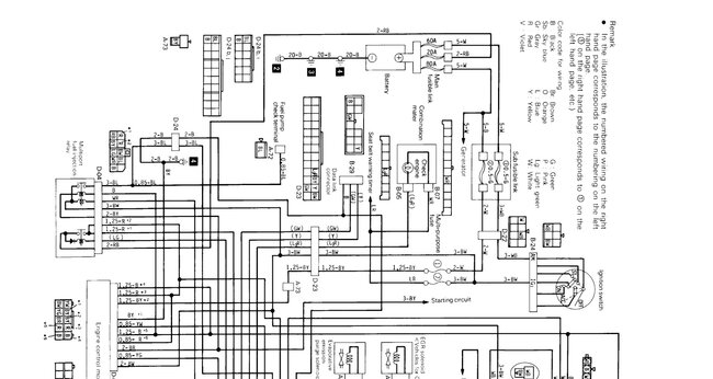

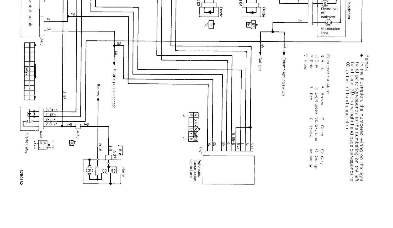

Looking for pinouts for rpm signal and TPS to gearbox controller it has a 26pin plug part number on controller mr145308.

I need to ask a couple questions first. Is this a Colt pick-up sold in South Africa? Asking because the Colt car wasn't sold in the US. Is it a diesel or gasoline engine? I'm not sure if I can find much on it as a Colt, but they did sell a version of it as a Dodge Ram small truck and possibly they used the same parts.

Yes, it is a pickup in SA also sometimes called a L200 pickup. (4x4)Its a v6 sohc 24v gasoline engine. I also found this site for help on diagrams but not any luck as of yet... https://charm.li/.

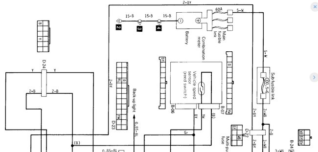

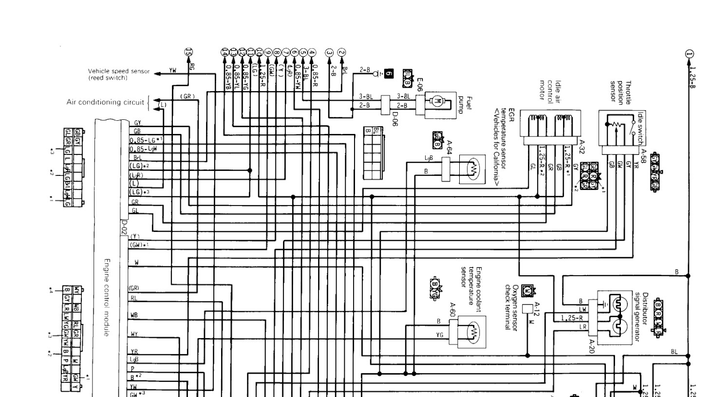

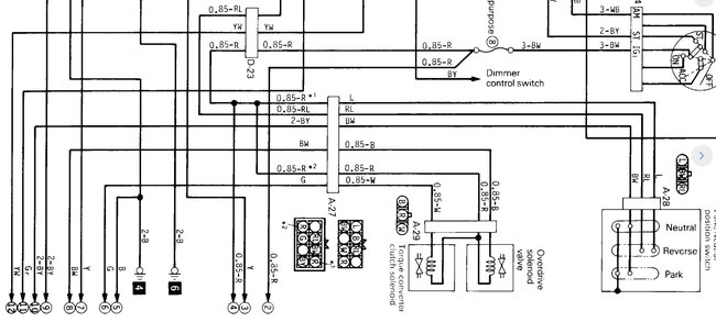

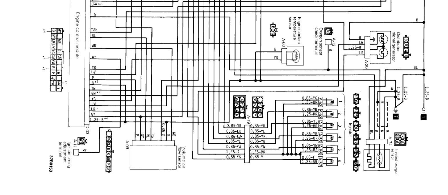

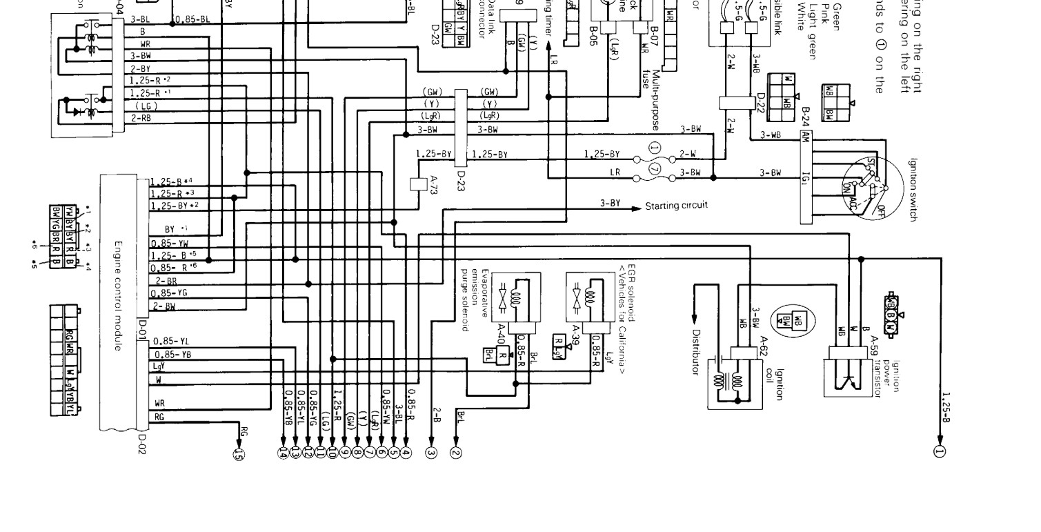

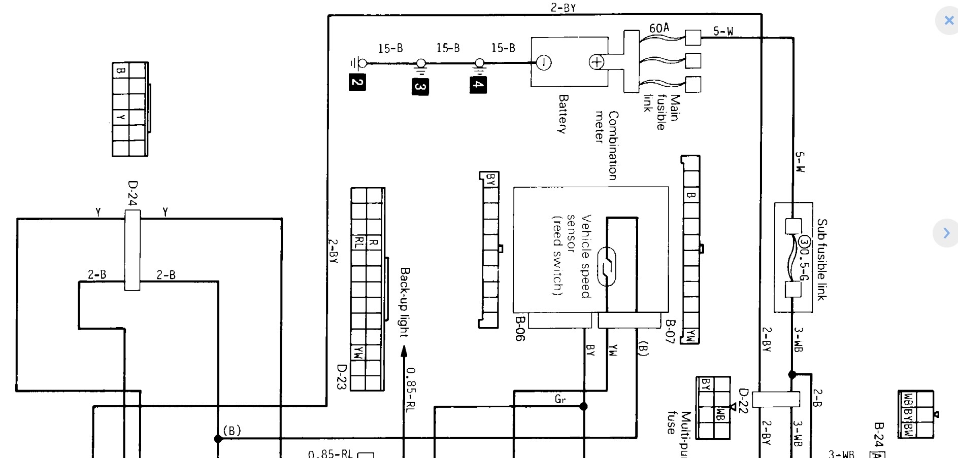

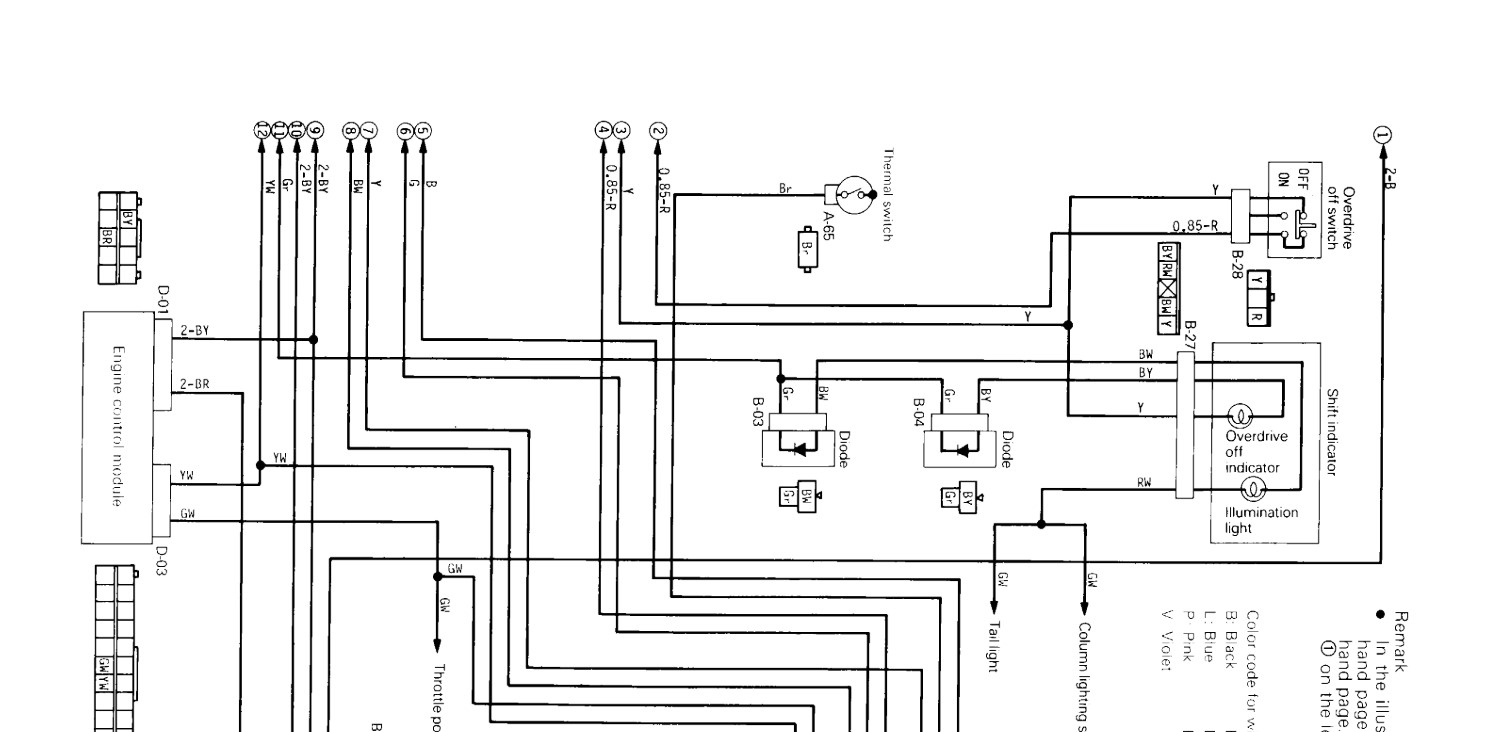

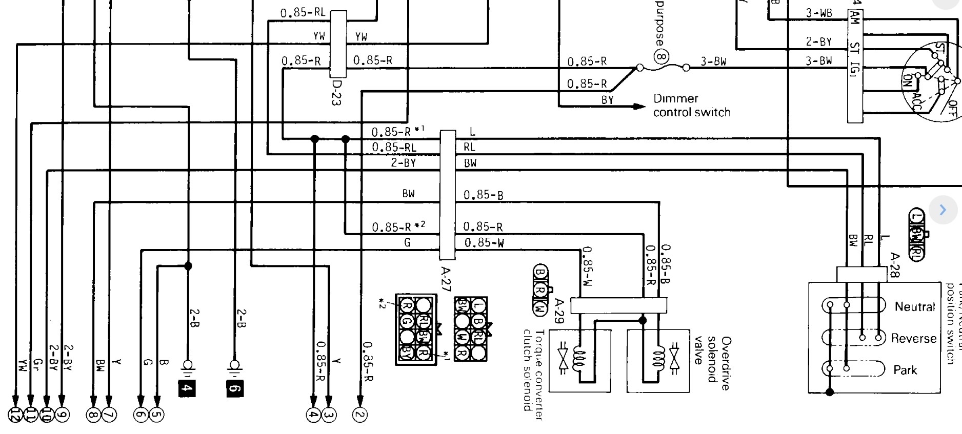

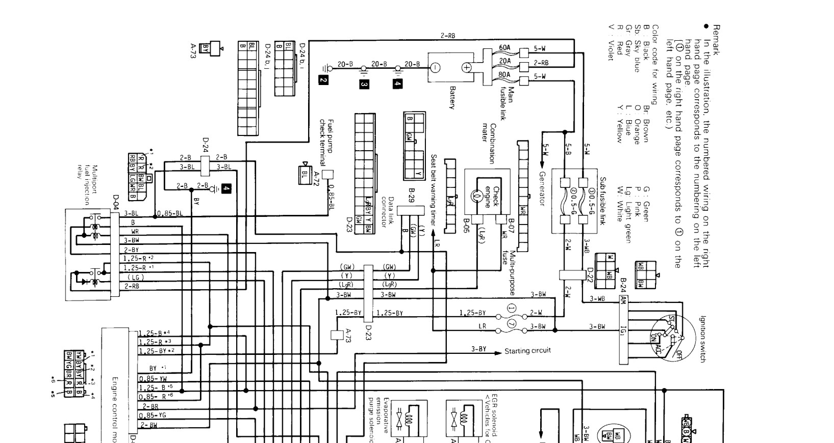

Well I have been digging around and this is the only thing I've really found. These are for the Mighty Max in 1995 with the low emissions and automatic transmission. The first 4 are transmission. Last 4 are engine. However, it was being sent to the US so things may be different.
