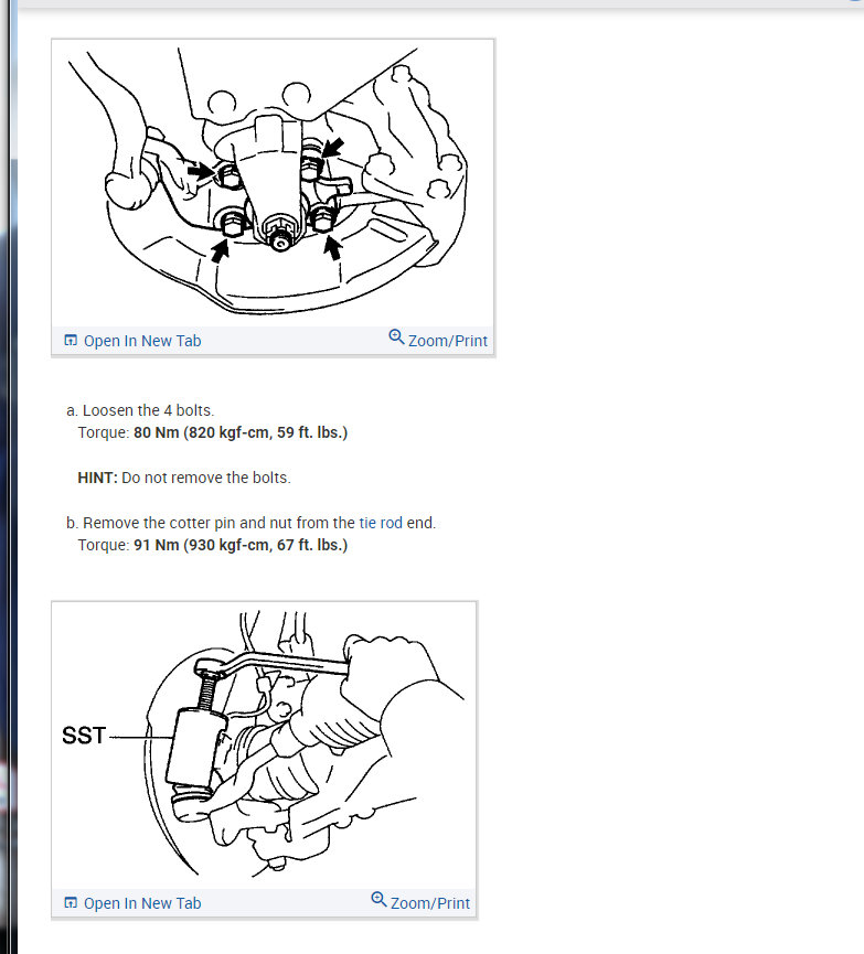

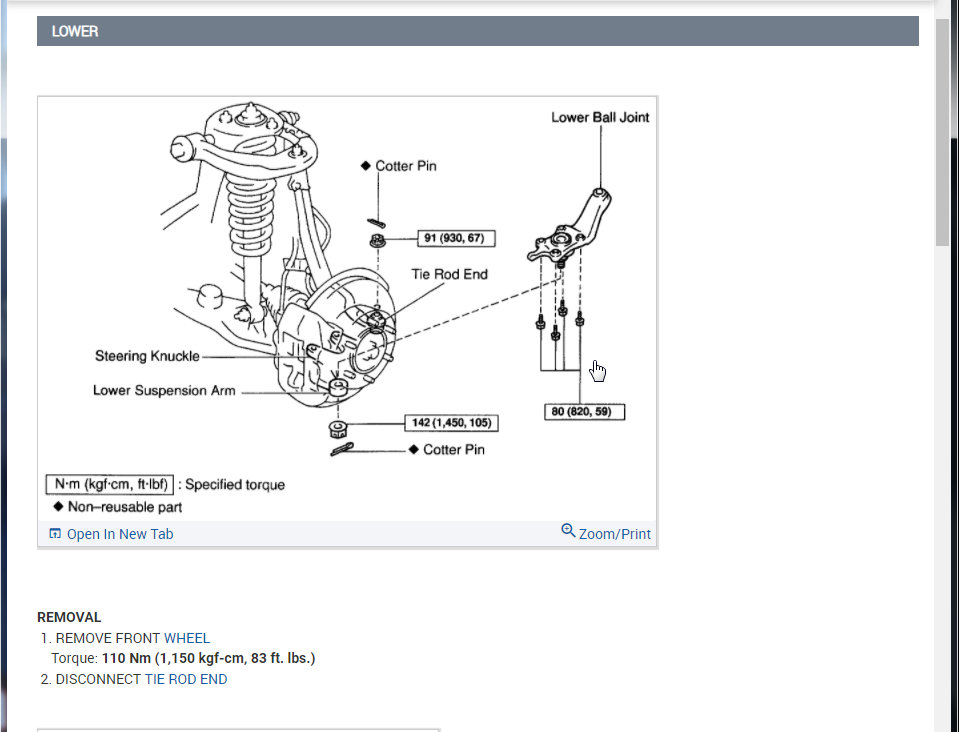

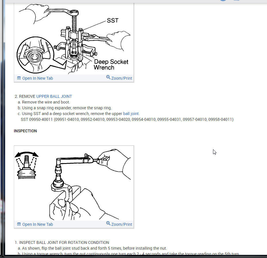

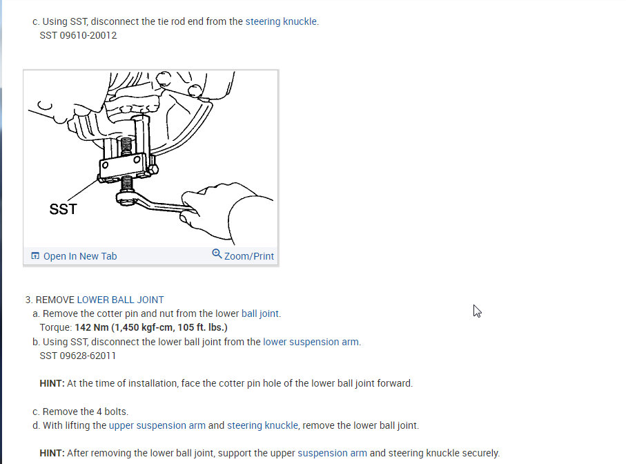

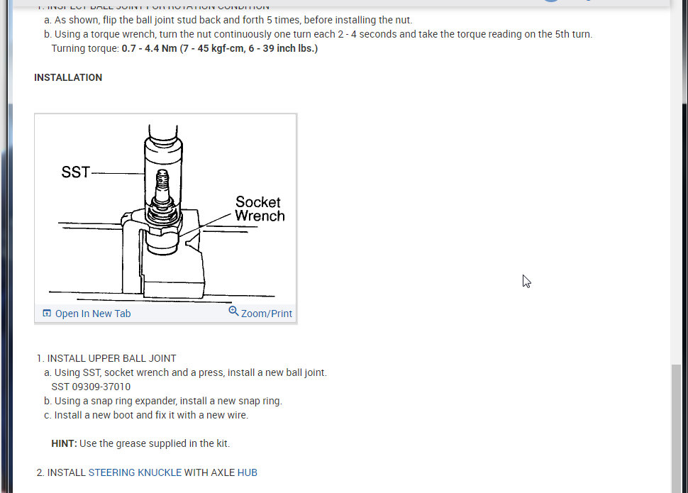

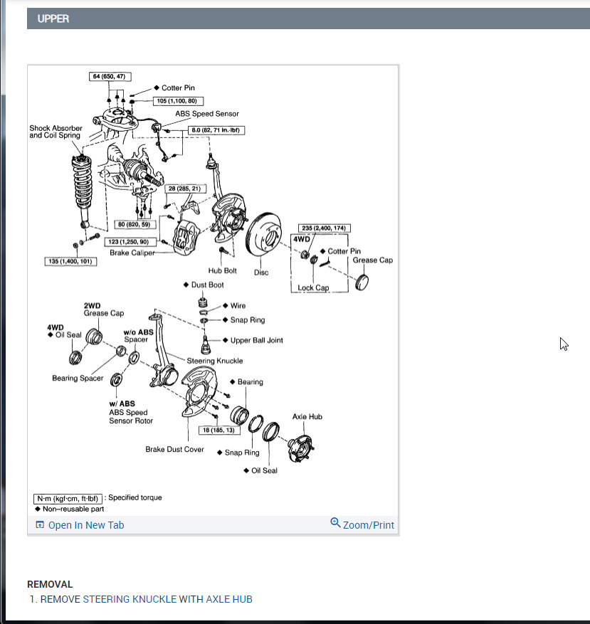

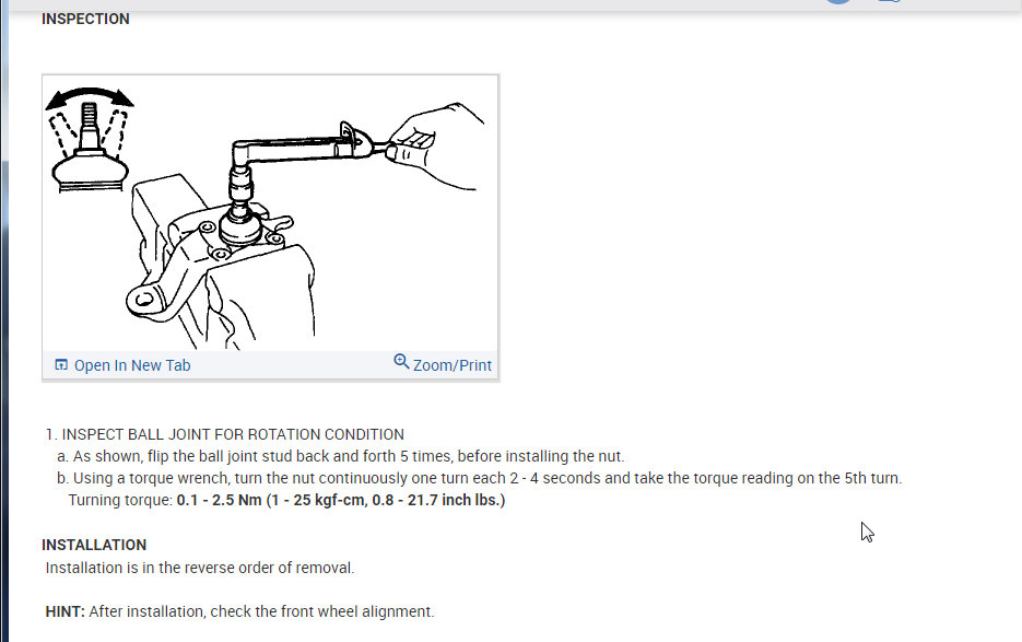

Hi! I've just been noticing my car has a "looseness" to it when i'm behind the steering wheel they say I need new ball joint upper and lower. I'd like to get some help from pros on where to start. Thanks!
Sep 24, 2019 at 11:14 AM
No problem, here are some guides that would help with this:
https://www.2carpros.com/articles/lower-control-arm-bushing-replacement
https://www.2carpros.com/articles/upper-control-arm-replacement
https://www.2carpros.com/articles/how-to-release-a-ball-joint
Below you will find the process from the manual that will help with getting these replaced as well.
Please let us know if you have other questions. Thanks
