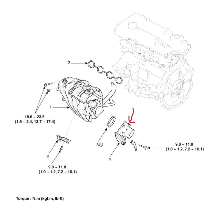

Car starts and then shuts off right after start up.
Sep 7, 2024 at 2:04 PM
Experienced Mechanic
55,601 POSTS
Do you have a check engine light on? if so, we need to run the codes this guide can help:
You could have a vacuum leak or a dirty throttle body which can both cause this kind of problem. This guide can tell you more and what to look for:
Here is how to service the throttle body which is a normal service item. Check out the images (below). Please upload pictures or videos in your response of any problems so we can see what to help you with.
