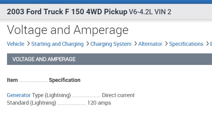

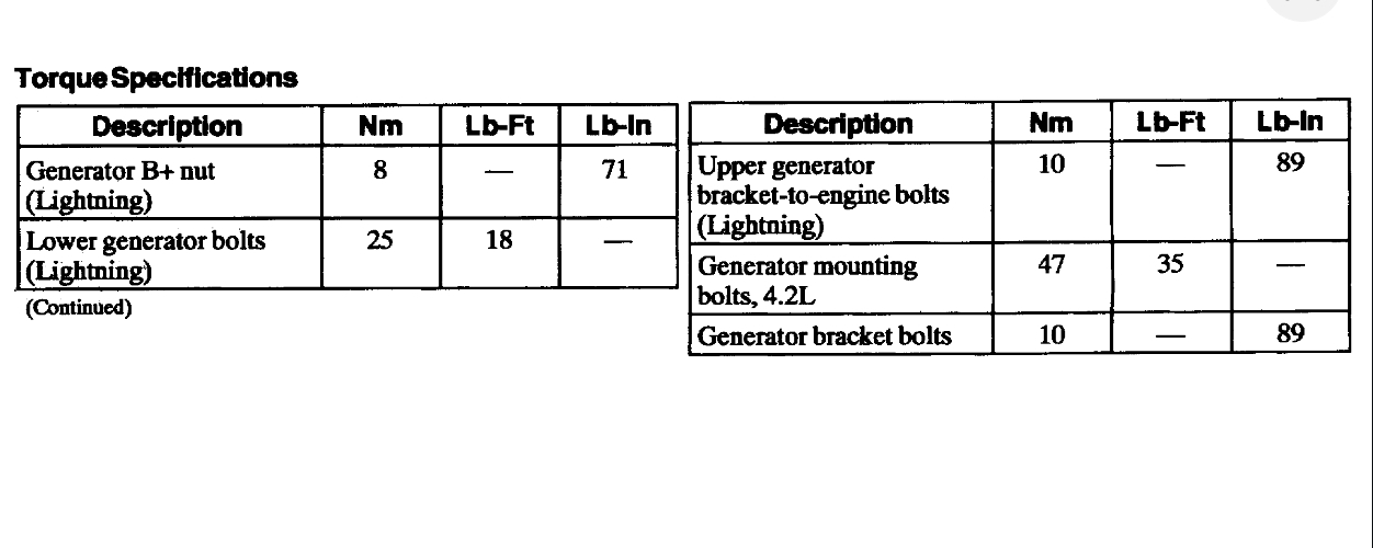

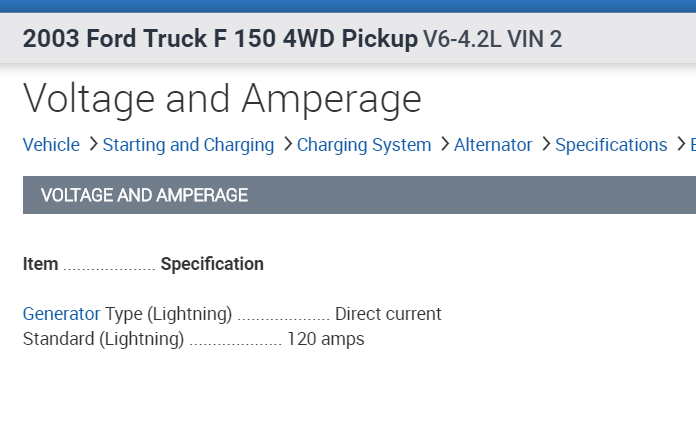

Can I put a F150 alternator on a Chevrolet Trailblazer?
Apr 27, 2019 at 3:15 AM
SCGRANTURISMO
  • 4,897 POSTS

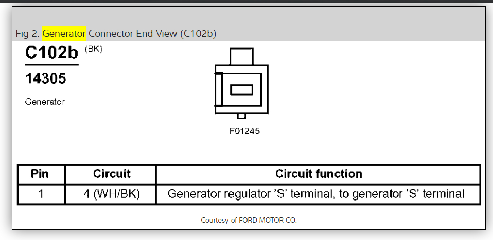

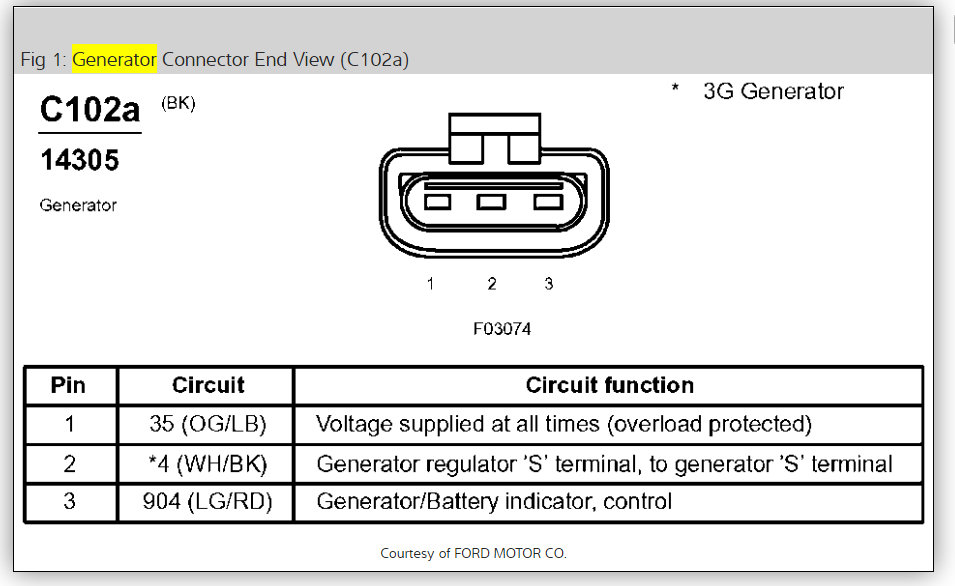

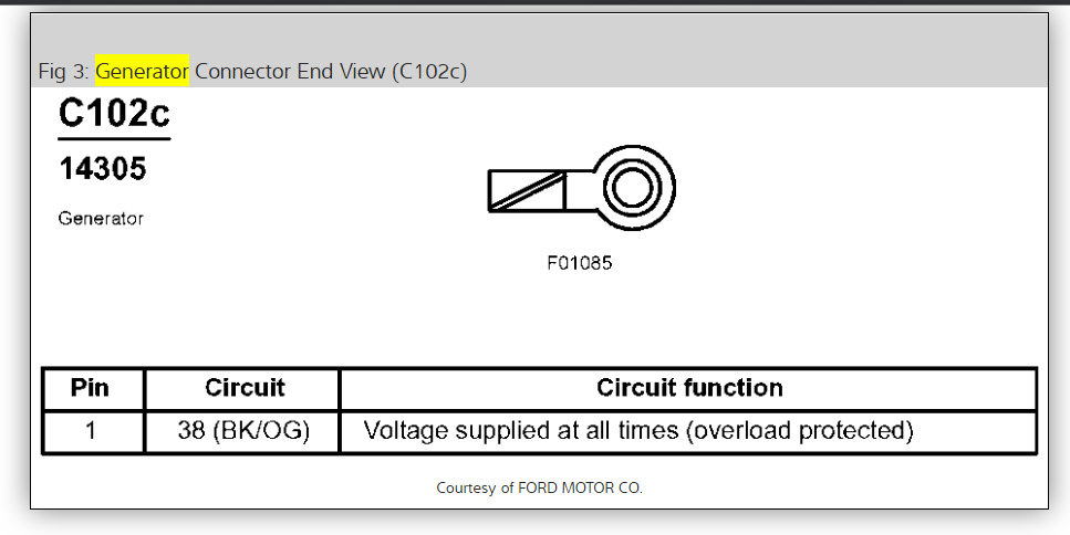

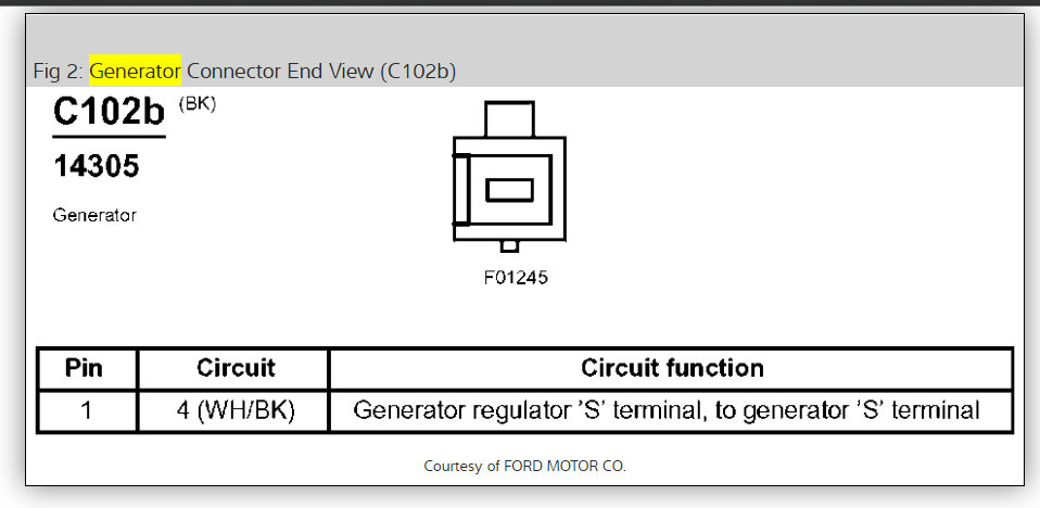

Sure, if you can get the mounting bolt patterns to match. What year trailblazer? The connectors might be different as well, but you can transfer those over. In the diagrams down below I have included pinout diagrams for the Ford's Alternator Connectors. I will also give you the connectors for the Trailblazer if you give me the year so you will know which wires go where when you transfer the Ford's connectors to the Trailblazer. Please get back to us with what the year is, please.
Thanks,
Alex
2CarPros
Apr 27, 2019 at 4:55 AM
CMADD35

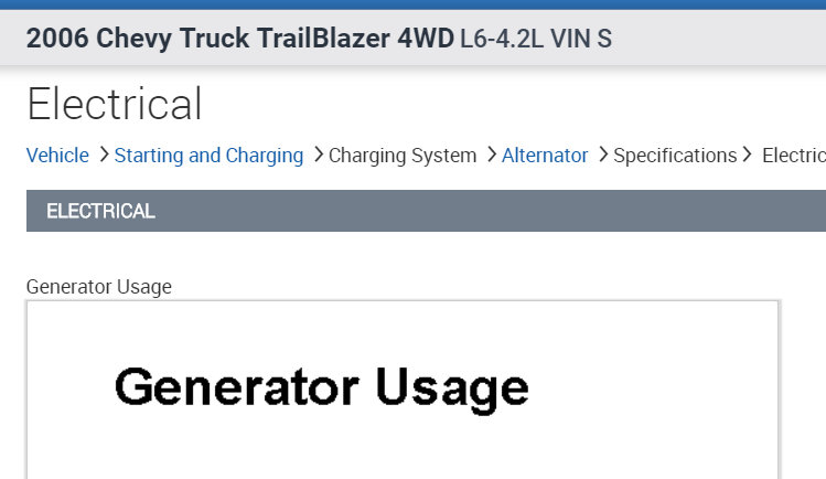

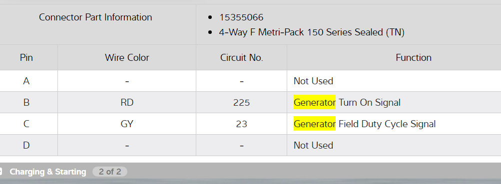

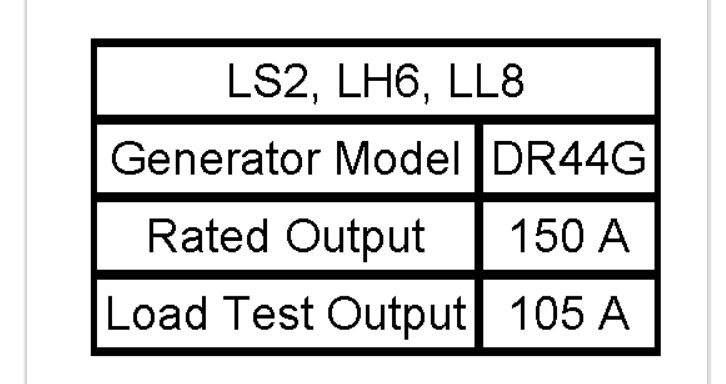

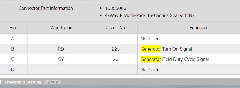

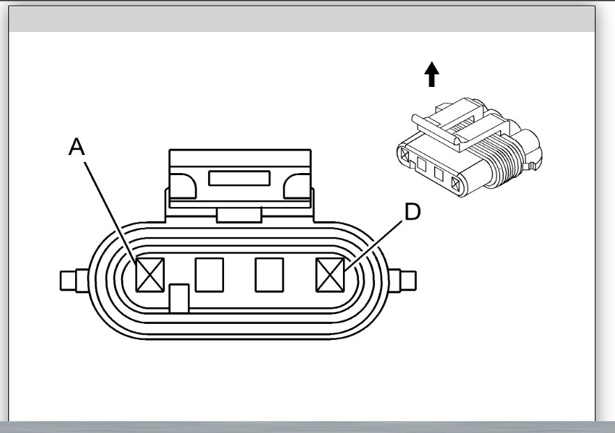

2006 Trailblazer.
Apr 27, 2019 at 5:00 AM
SCGRANTURISMO
  • 4,897 POSTS
Hello again,

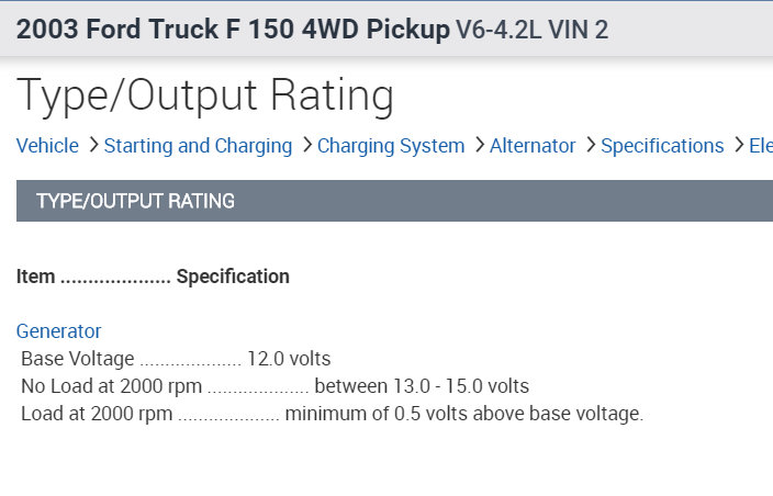

As promised I have included the connector information for the Trailblazer in the diagrams down below for you. I have also given you the specs for both the alternators as well. Please let us know how it turns out. We're curious to see how it turns out.
