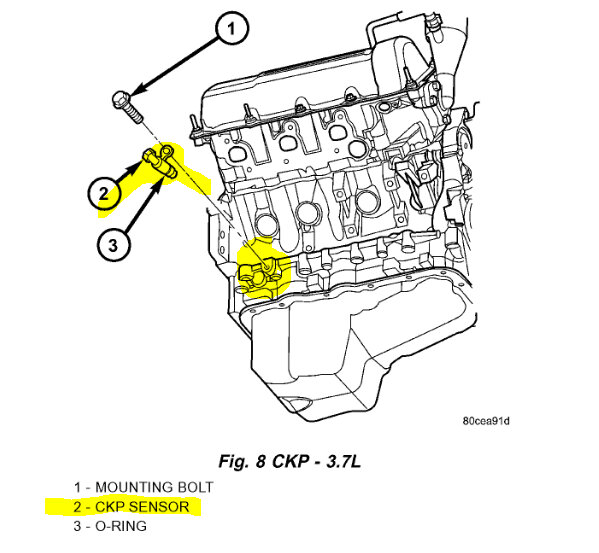

The crankcase sensor where's it located in is there a Gap.

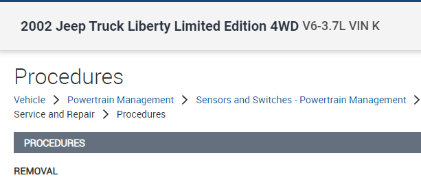

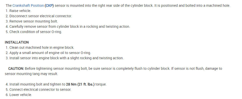

The gap is not adjustable on this vehicle. The sensor is located on the passenger side of the engine block, right above the oil pan and in front of the transmission bell housing.
I attached the directions below for replacing it. Picture two shows the location.
