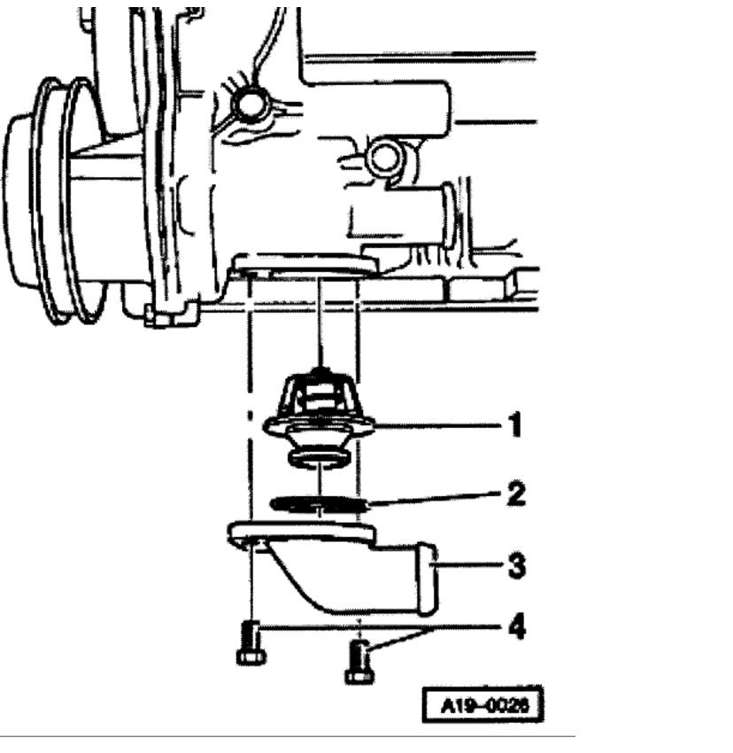

Engine overheats after a short drive of less than five km. Put new head gasket on engine. Head went for skimming, but not pressure testing. Car has closed circuit cooling system.

It sounds like you have a stuck thermostat. Here are a couple of guides that will help you get the problem fixed.

That is good but it wont cause the engine to overheat in 5km. Have you done the thermostat?

Where can I locate the thermostat on an Audi A4 1.8T 1998 model

Hey GEORGERINGIRISAI,
It is in the bottom of the water pump, here is a diagram to help find it.
Let us know what happens.
