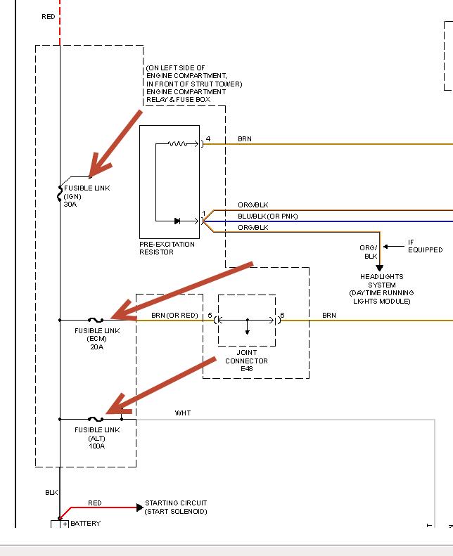

While driving the car just died.. No electrical! Checked battery, starter and fuses, all good. Is there a fusable link or master relay? Don't have manual or schematic. I live remote area of costa rica. Help!

check your box underhood we don't have a galloper model but this is off an accent it should be similar. there are 3 fusible links
