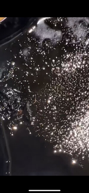

Yes, they mentioned the solenoid but said there were metal shavings in the oil pan and that was what was causing the issue. The car was driving and making no noises, I didn’t have any issues with it whatsoever until after the turbo got changed. I’ve paid just right at 4,000 to the shop working on it in just the last 5 months. Now they are wanting to charge me $225 just to put the oil pan back on it and to put oil in it that they drained out and the oil I bought that was in the truck of the car is what they are going to use to put back in the car.

If there are metal shavings in the oil pan, that is a big concern. Was the oil pressure light staying on? The turbocharger is connected to the engine oiling system by a supply and drainpipe. I'm wondering if something happened with that when it was put together. Did they mention how much metal was in the pan?

The oil pressure light was and has not been on at any time. Below is a picture of the shavings in the bottom of the oil pan.

That doesn't look too promising. Have they inspected the engine oil pressure solenoid? Also, how did the original turbo fail? In other words, did a bearing fail?
