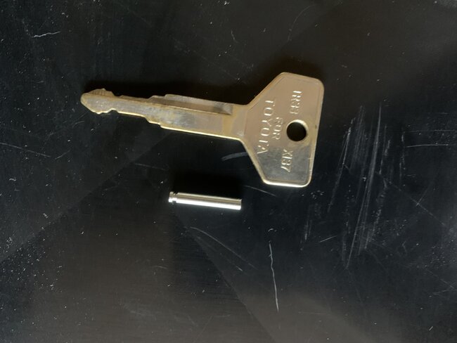

I’m slowly taking apart things to remove my cylinder head for a head gasket R&R, and after removing my top radiator hose, I decided to empty the little bit of remaining coolant into a bottle. After doing that I turned the hope vertically and this little pin(?) fell out.
What the heck is this thing?? I set a key next to it for size reference.
I have no idea what it is. I haven’t removed the intake side fully, or the thermostat housing (yet). I’m glad I followed the urge to watch what came out of the upper hose otherwise I would have never noticed this thing.
Picture below.
Thanks for any advice/help/guesses.

I've been in the business for nearly 40 years and have never seen something like that in the cooling system. Is it a solid piece of metal? There is a chance it was dropped into the radiator by accident at one point. There isn't anything in the "cooling system" that would look like that.

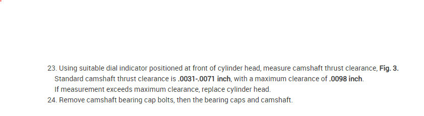

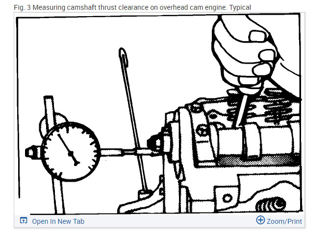

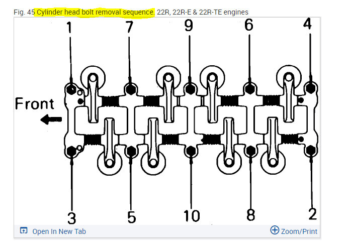

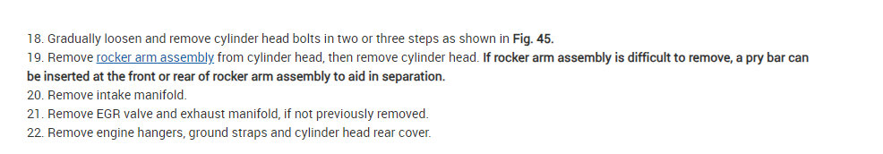

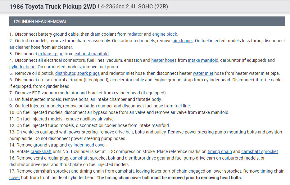

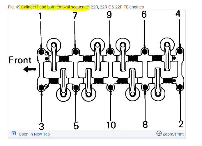

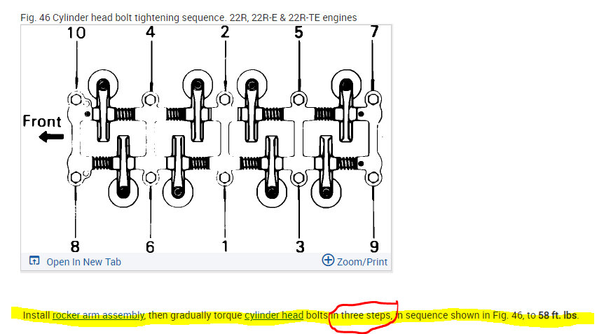

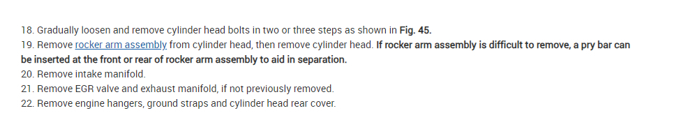

As far as the head gasket, I attached the directions below (in the event you need them). Make sure to remove the head bolts in the order indicated and reinstall them using the process indicated.
joe
See pics below. The last pic provides torque specifications and sequence.

It’s odd, isn’t it? Yes, it is a solid piece of metal that is cylindrical in shape and clearly was machined for a purpose. It didn’t shear off of anything.
My first thought was, “Did the thermostat come apart?” but that piece doesn’t look like it came off of a t-stat, even if mine did break apart somehow. I’ll know more when I remove the housing.
Then I thought, “Did something break off in the radiator?” I may remove the lower hose and see if anything comes out of that one (aside from coolant).
