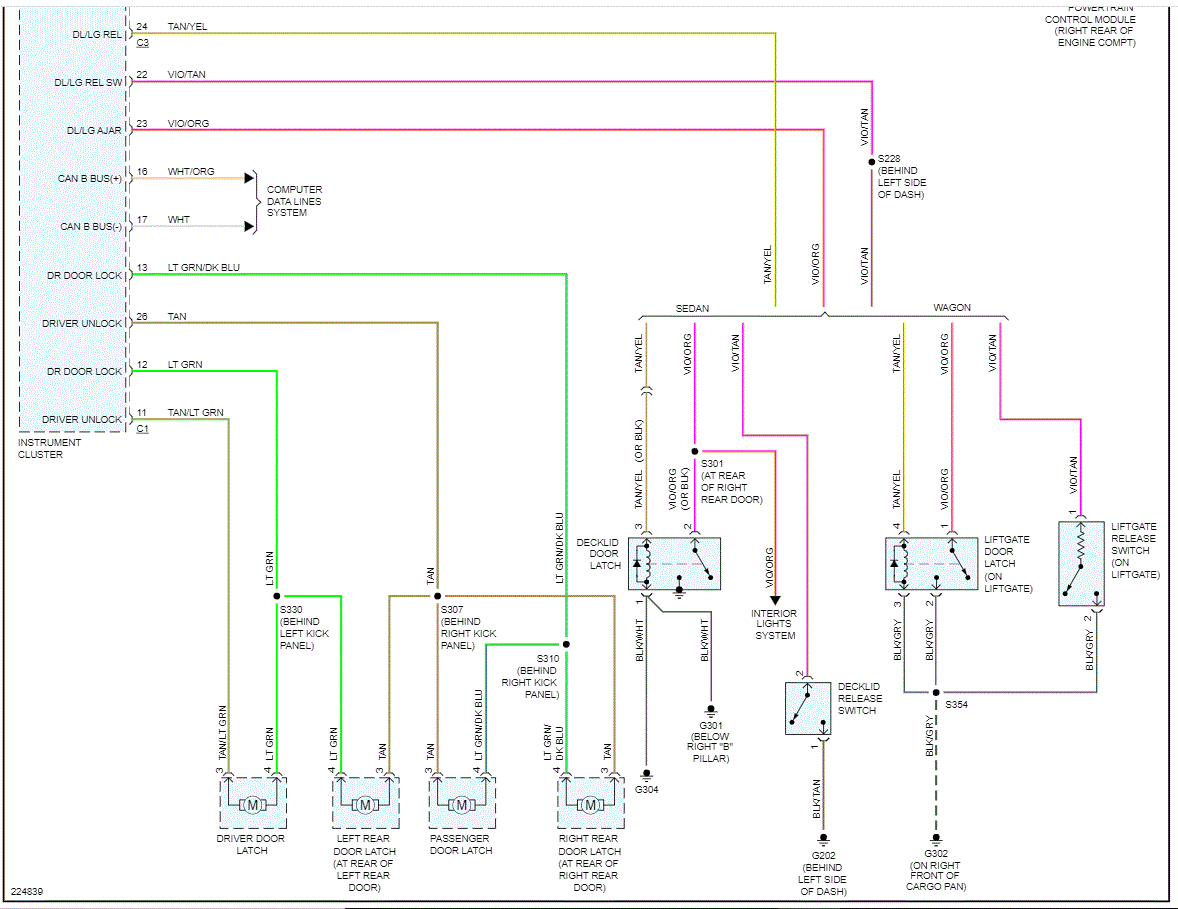

My car was turning on and then turned off. so, I noticed the red flashing light on my dashboard, and it happened to be my anti-theft system light that it was activated. so, I hit the panic button and tried to deactivate it like that, but that did not work, and nothing would work with my panic button to turn it off. putting the key in the ignition wouldn't turn it off. so, then I remove the fuse and I put the fuse back in and my car would not turn over and start at all after that but it was making them it was starting and then turning off on me, but I cannot get the anti-theft system to stop flashing so I'm guessing that that's what has my car on lock and preventing it from starting.

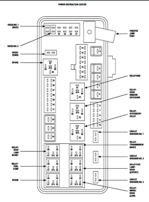

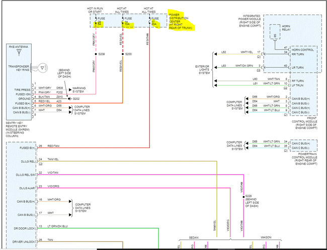

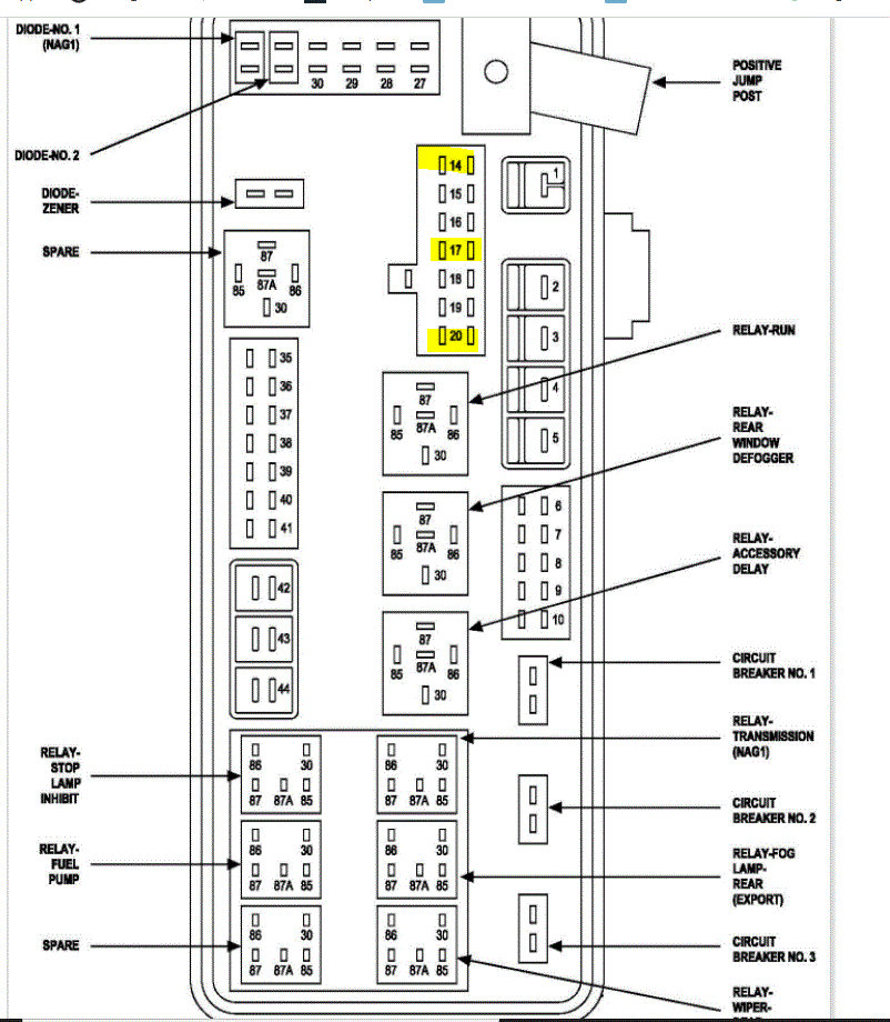

I'm not sure which fuse was removed, but I need you to check three of them. All are located in the fuse box in the right rear of the trunk.
When you check these fuses, make sure they are good, and more importantly, make sure they have power to and from them. Here is a link that you may find helpful:
Next, you indicated when you put in the key, it stops flashing. Is that correct? When you try to start it, does it come back on?
Let me know what you find. Also, we may need to have the can-bus scanned. However, I would rather start with a simple electrical test.
See pics below. The last pic identifies which fuses to check.

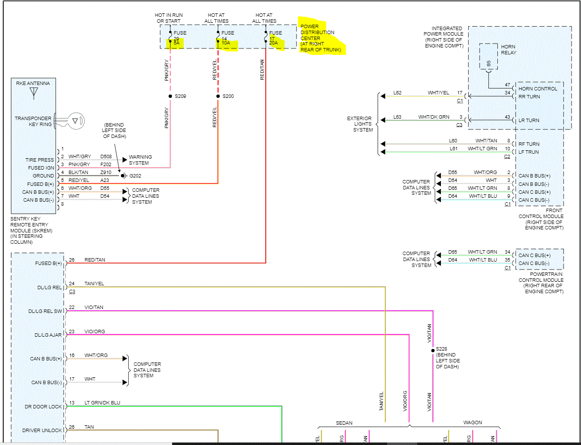

Are the fuses I mentioned good and have power? It does sound like anti-theft is the issue. When you say your key is broken, please explain exactly what is wrong with it. The anti-theft has to recognize the key, so if it is bad, that is likely the cause.
Also, disconnect the negative battery cable and allow it to sit for about 20 minutes. Then, reconnect it to see if anything changes.
The idea that you removed fuse 29 shouldn't have caused an issue. However, that is what supplies power to the SKREEM module. I have seen situations where the WCM (wireless control module) locks up and needs to be replaced. That can be caused by a power surge or even static when the key is placed in the ignition. However, the only way to test it is using a scanner that can read CAN codes. CAN stands for controller area network. Basically, the modules are all tied together via a few wires. This will retrieve codes regardless of the module storing them.
If the WCM is locked up, the vehicle will do exactly what you are experiencing. However, the only way to know is via a scanner. If the WCM is locked up, the scan tool will identify the module as, Off-Bus."

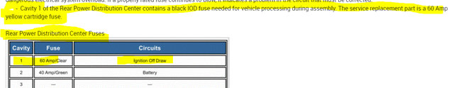

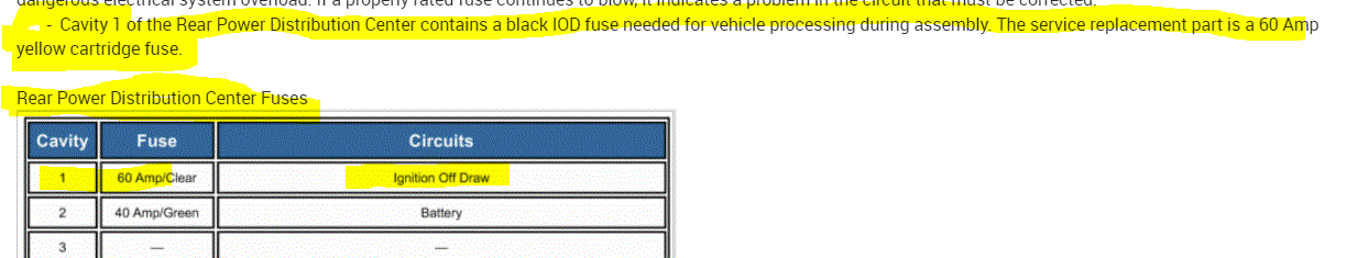

There is one other test that may identify if the WCM is locked. As a test, I need you to pull a fuse. Remove the IOD fuse (with the key out of the ignition switch), wait for 10 seconds, and then reinstall the IOD fuse. If the vehicle then starts, the WCM needs to be replaced.
The IOD fuse is in the rear power distribution center. By removing it, you are resetting the system. I attached a pic below of the fuse location in the box. It will be a 60-amp fuse.
