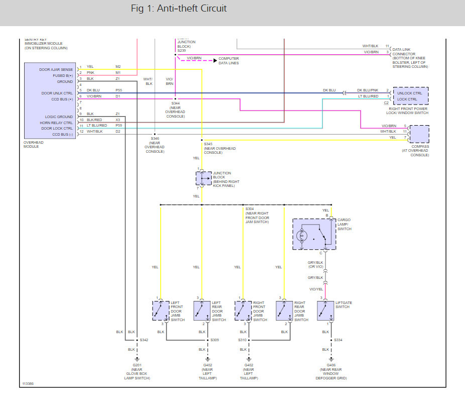

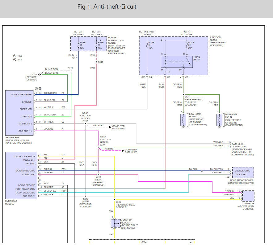

The battery died on my vehicle. So when I charged battery the alarm will not turn off and car will not start. The passenger side door was making a funny noise so I replaced the actuator. Now door works fine, but the back hatch is not reading right. Sometimes it will say open when it is closed and closed when it is open. I also reset the key and alarm shut off but the battery died. So I tried resetting again but to no avail. Please help, out of options.
Dec 12, 2018 at 8:06 PM
  • 55,399 POSTS

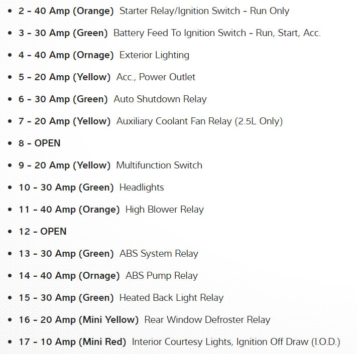

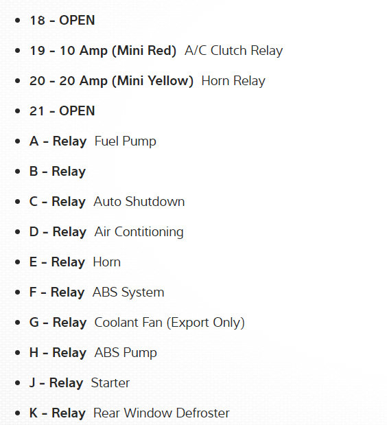

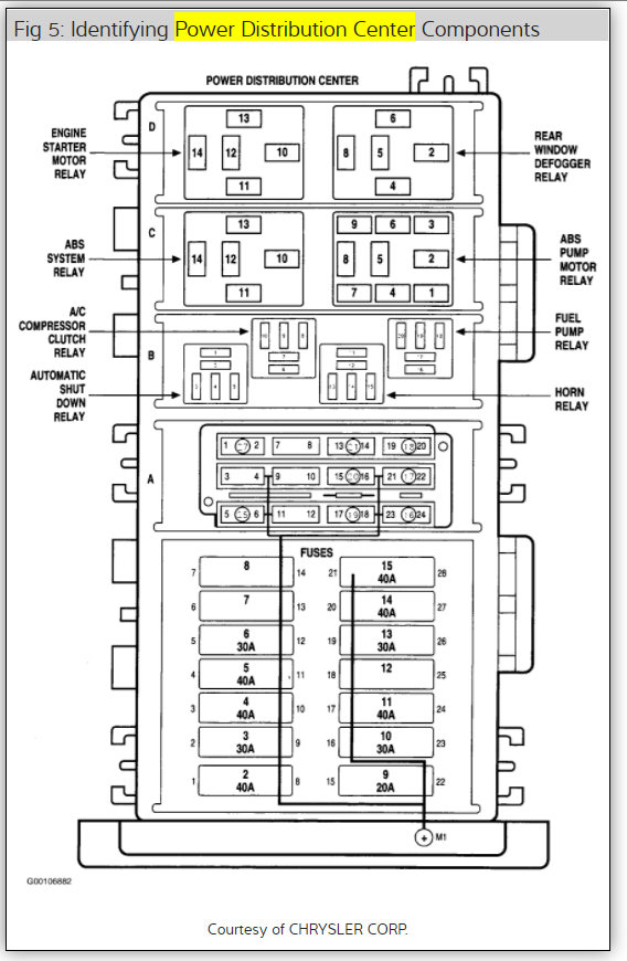

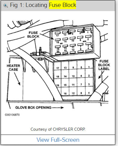

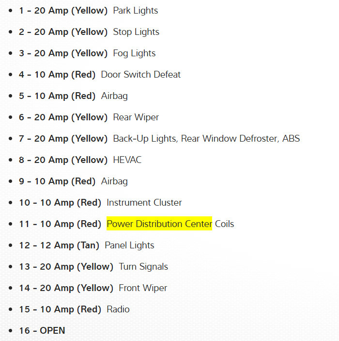

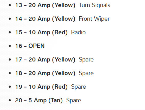

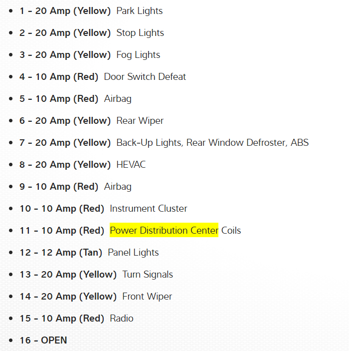

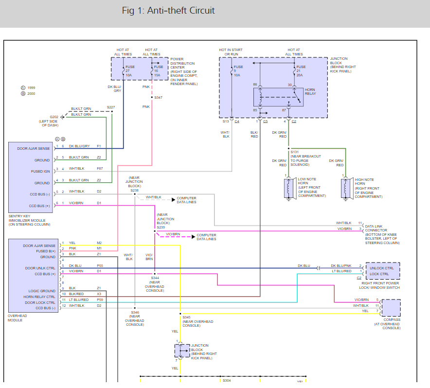

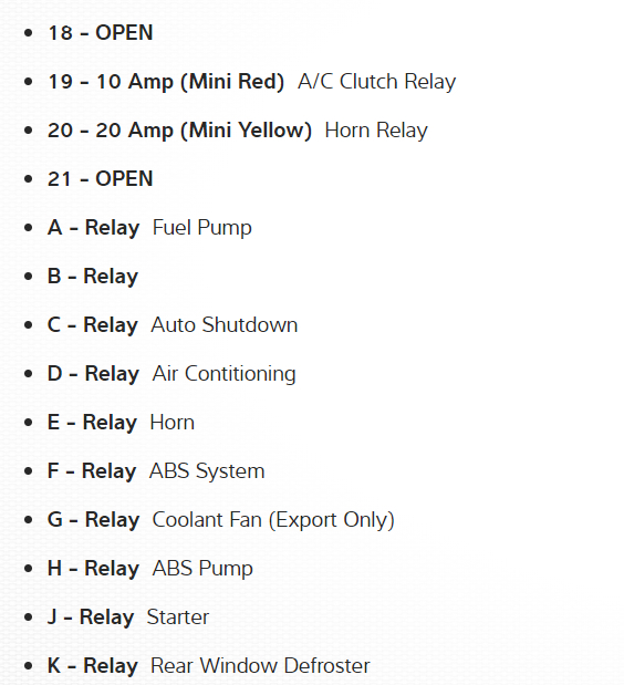

There are 3 fuses ( 27, 16 and 9 ) that need to be checked also the rear lift-gate can be causing the issue. Here is a guide to help you test for power at the fuses and the security and power door lock wiring diagrams as well as the fuse locations:
Check out the diagrams (below). Please let us know what you find.
