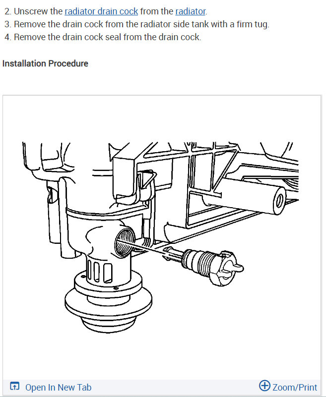

I have no antifreeze in my car, only water and it's 30-32 degrees tonight. Is there anything I can do to stop my radiator/engine from freezing?
Dec 29, 2023 at 3:08 PM
  • 55,399 POSTS

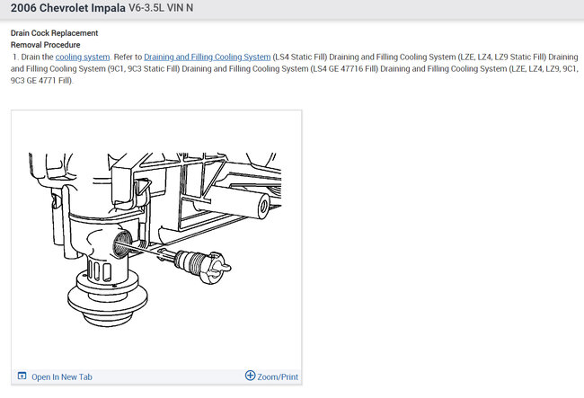

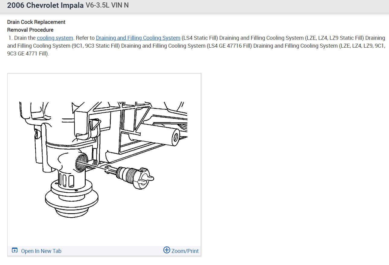

Not really, this is why they made antifreeze, you can let the engine idle or put the car inside with a heater. Not too many things I can think of on that. Here is how to drain and fill the system which can prevent it from freezing. Please check out the images below to see how on your car.
https://www.2carpros.com/articles/coolant-flush-and-refill-all-cars
Make sure the engine is cool before you start, the cooling system drain plug is on the radiator left side lower tank.
