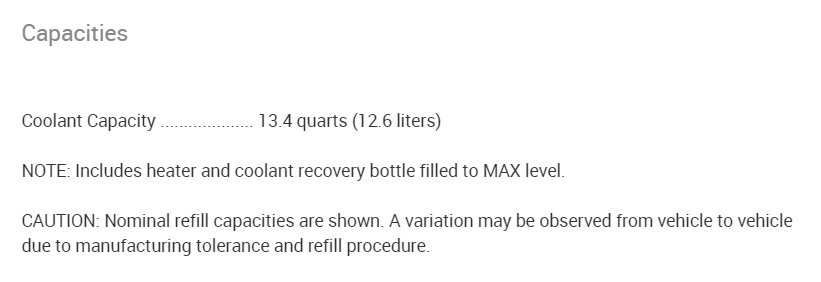

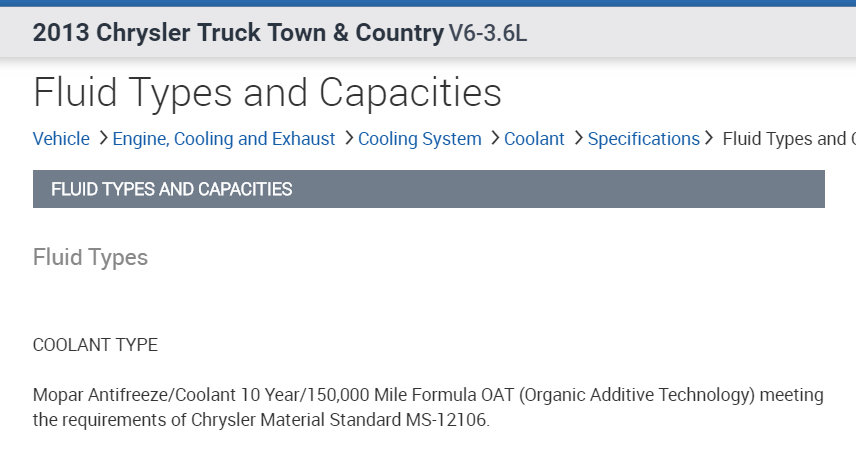

What antifreeze do I put in my van? I went to o’Reilly auto parts and got their dex cool compatible antifreeze and coolant. will this work in my van? And how much antifreeze does it take if I flush all the old out?
Apr 27, 2019 at 5:10 AM
SCGRANTURISMO
  • 4,897 POSTS
I have included the information that you requested in the diagrams down below. I have included information on not only what type of coolant goes in your vehicle, but the capacity as well. Please get back to us with how everything turns out.
