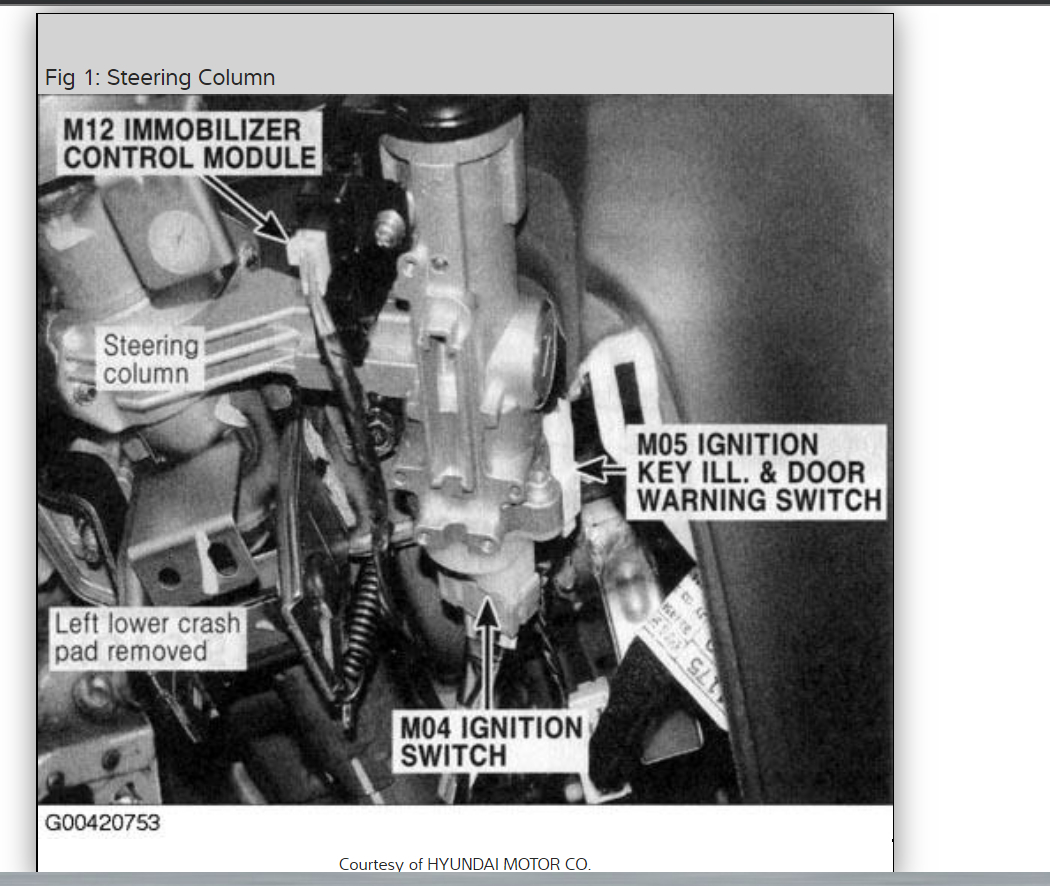

Need to know the location of my anti theft device on this car so I can change it.

The anti Theft/Immobilizer Module is located on your vehicle's steering wheel column. I have included a picture of its location in the diagrams down below. Please get back to us with how everything turns out.
