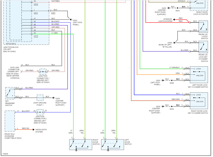

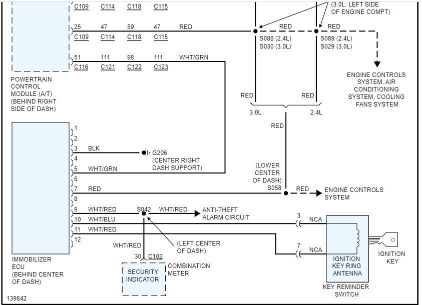

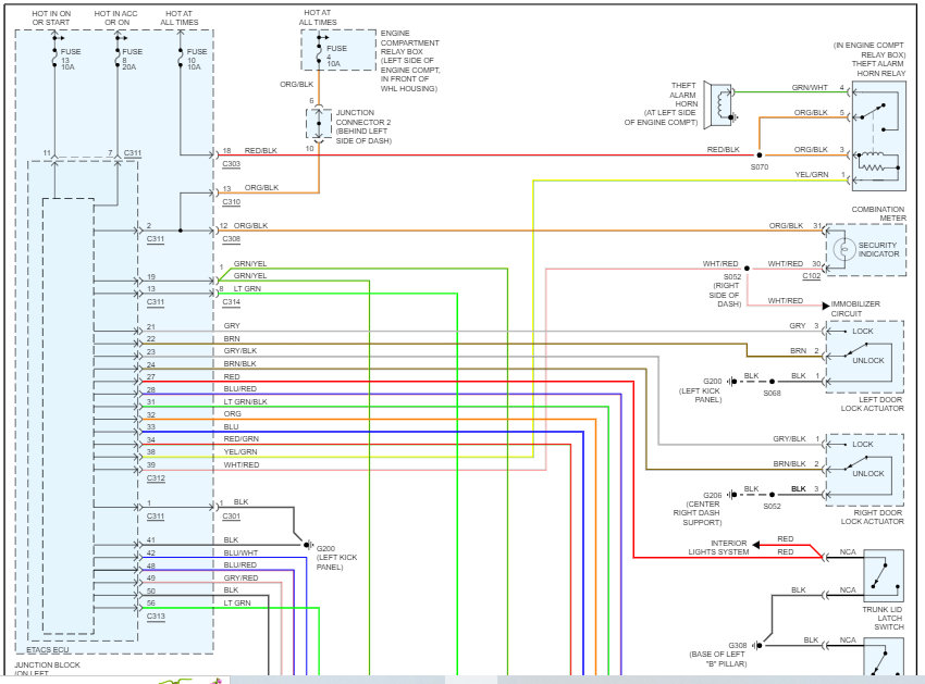

I bought a car that I had to replace ignition switch but installed a push start. I need a diagram or schematic for system circuits due to original owners cut a lot of wires that I'm not sure what they connect to.
Jul 23, 2022 at 5:57 AM
  • 110,248 POSTS
If you look below, I attached the wiring schematics you requested. The first two are the anti-theft alarm circuit.
Pics 3 and 4 are the anti-theft immobilizer circuit. As far as the pics I attached, the schematics were one page long. I had to cut them in half to make them readable for you. I did overlap them so you can follow from one to the next.
Let me know if this helps.
joe

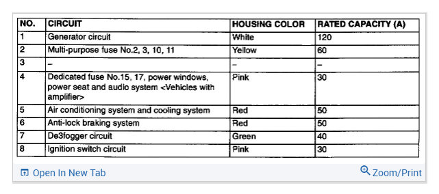

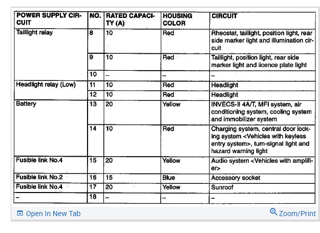

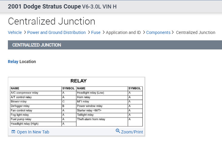

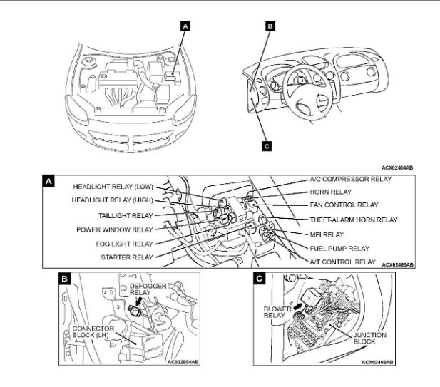

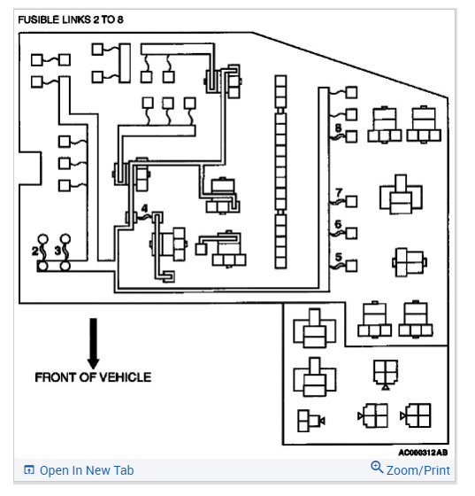

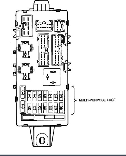

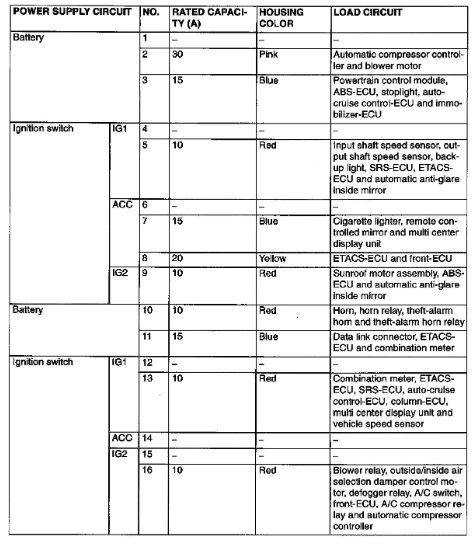

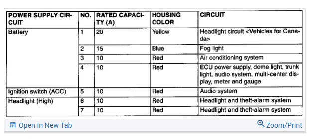

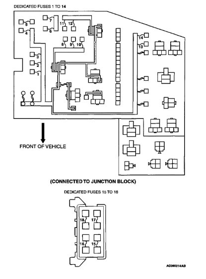

Now my next problem is finding out what the fuses and relays on engine compartment fuse box and inside under dash the cover only specifies to size of fuze but not what it's for I'm going crazy trying to figure it out it's. 2001 Dodge stratus rt coupe but has a 6g72 engine standard transmission help please
Aug 9, 2022 at 1:56 PM
  • 110,248 POSTS
I'm not sure if it will help, but I attached everything I have for the fuses and junction boxes. If things were modified, I'm not sure what was changed.
Take a look through the pics below. Let me know if they help.
Aug 10, 2022 at 4:05 AM

I so greatly appreciate it.. thank you so much... Hopefully it's the same....let you know if they are..
Aug 10, 2022 at 4:07 AM
  • 110,248 POSTS
No problem whatsoever. I just hope they help. In most cases, and for what reason I don't know, my manuals provide basically useless information when it comes to fuses on a Chrysler product. This what much better than I expected.

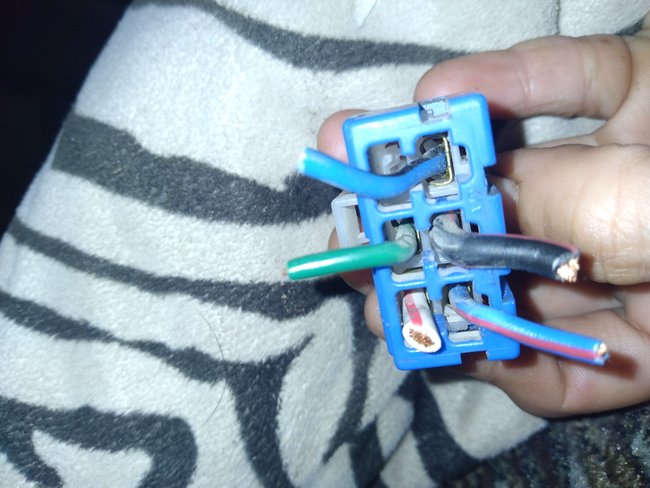

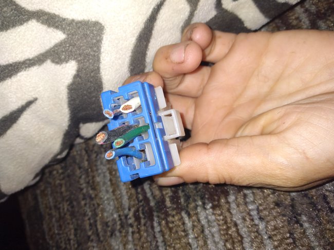

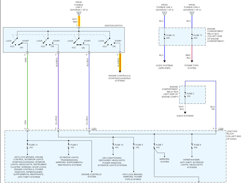

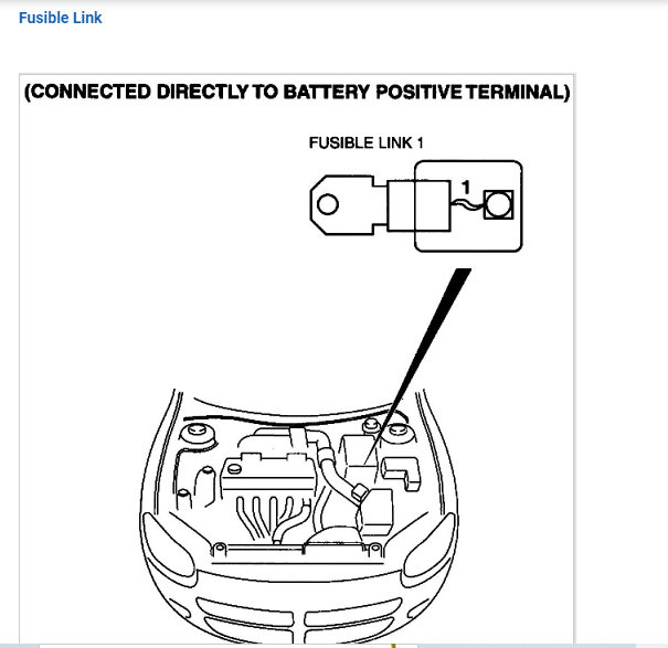

Yes, it matched thank you so much, honestly, it helped out a lot. one last question is, now concerning the ignition switch pertaining to the colored wires what they connect to theirs several wires that I'm lost as to what they connect to. I have a picture of connector or harness not sure name of it. Not sure if that's included in any of the images you've already sent me..
Aug 10, 2022 at 7:55 AM
  • 110,248 POSTS
The black wire with the red tracer goes from the switch to the starter relay to energize it. The white wire with the red tracer comes from fusible link 8 in the under-hood fuse box. The power from that wire goes through the ignition switch and then to the starter relay when the key is in the start position, and it powers other fuses in the junction box on the left side of the dash.
I attached a pic below related to the switch and power distribution in the junction box. The black wire with the red tracer in the pic shows it is to engine controls/ignition. That is the one that goes to the starter relay primary side.
See pic below.
Aug 10, 2022 at 8:59 AM

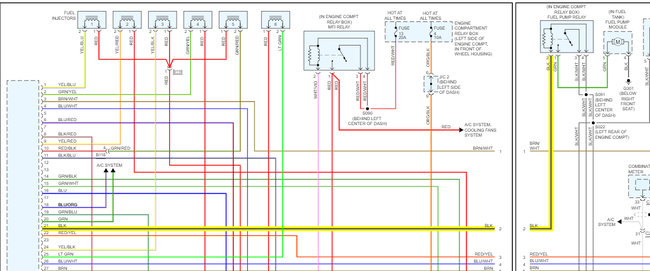

Now from there what wire powers the fuel pump it's new just bought knew one has power as I've tested it but won't come on when it's supposed to. I tried the starting fluid spray thing and did get car to turn on, but fuel pump won't engage can you tell me about those wires how and where they connect to please?

So, what if I get no ground on my relay which if I'm correct is what would engage my fuel pump to turn off which would be getting its ground from my ECU.
Aug 18, 2022 at 2:21 PM
  • 110,248 POSTS
If the fuel pump relay's primary side is not getting a ground path, the relay won't actuate and send power to the pump. If that is the case, check at the ECU to see if there is a ground presence there. You may have a broken wire or a bad connection.

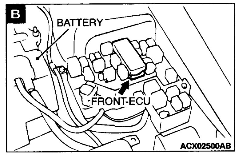

Thank you, that's what I figured. Now I will be checking ECU in engine fuse box or fuse box inside car apparently there's one there too.
Aug 18, 2022 at 3:25 PM
  • 110,248 POSTS
There is one there. I attached a pic below showing its location. I hope this helps.
See pic below.

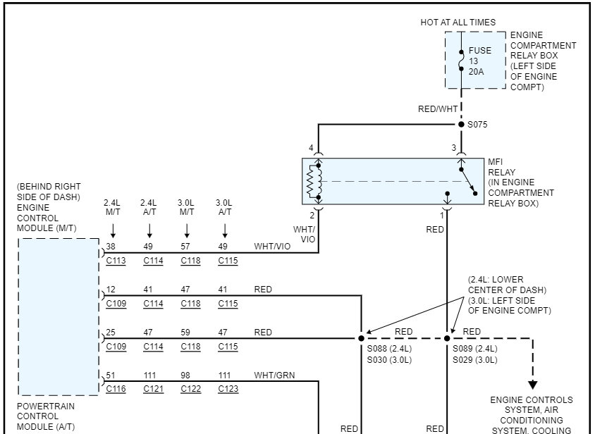

Well, you see my issue is my fuel pump wasn't engaging found out not getting ground side on relay circuit but not sure what to do next. Also seems like my fuel pressure is low or is that from fuel pump not engaging. I used starting fluid to see if car would start and it did but stuck on what to do next on relay or what to check and where. I have the car listed above rt 3.0l v6 6g72 Mitsubishi engine.
Sep 8, 2022 at 1:00 PM
  • 110,248 POSTS
If you aren't getting a ground from the ECM, that is why you have no fuel pressure. I'm looking at the wiring schematic (see pic below). The ground signal is provided via a black wire. Go to the ECM on the passenger side and locate that black wire. With the battery disconnected, remove the connector and check for continuity in the wire itself. Also, make sure there is no damage at the connector or corrosion.
If that checks good, then check right at the ECM for a ground path. If there isn't one, the ECM is my first suspect.
Sep 9, 2022 at 1:14 PM

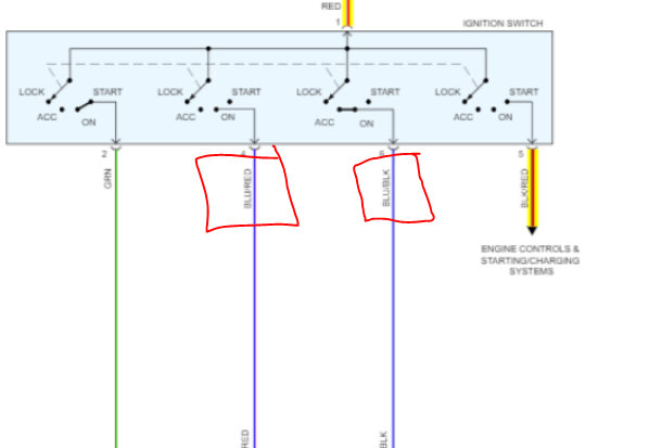

Question in regard to my ignition switch. Now my blue with red tracer and also my blue with black tracer say one says it connects to accessory heater blower 1 and blue and black connect to accessory heater blower 2 now if I'm eliminating ignition column switch and installed push start with accessory toggles how would I wire those two wires...
Sep 24, 2022 at 3:24 AM
  • 110,248 POSTS
I'm not sure how you have it toggled, but the blue/black needs power in acc and the run position and the blue/red only should have voltage in the run position.
Is that what you need? See pic below.
