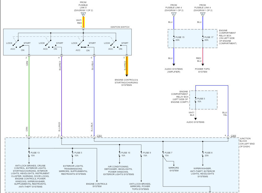

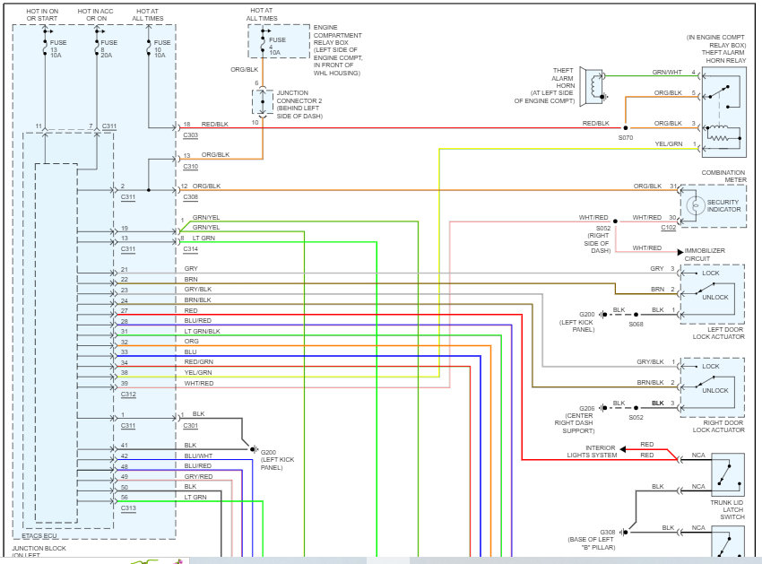

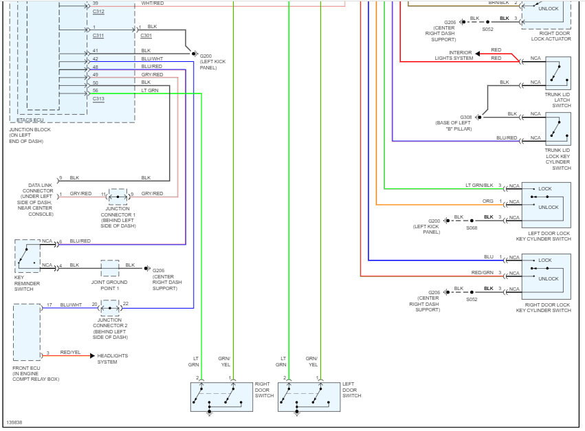

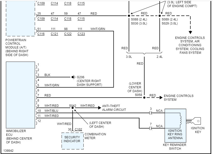

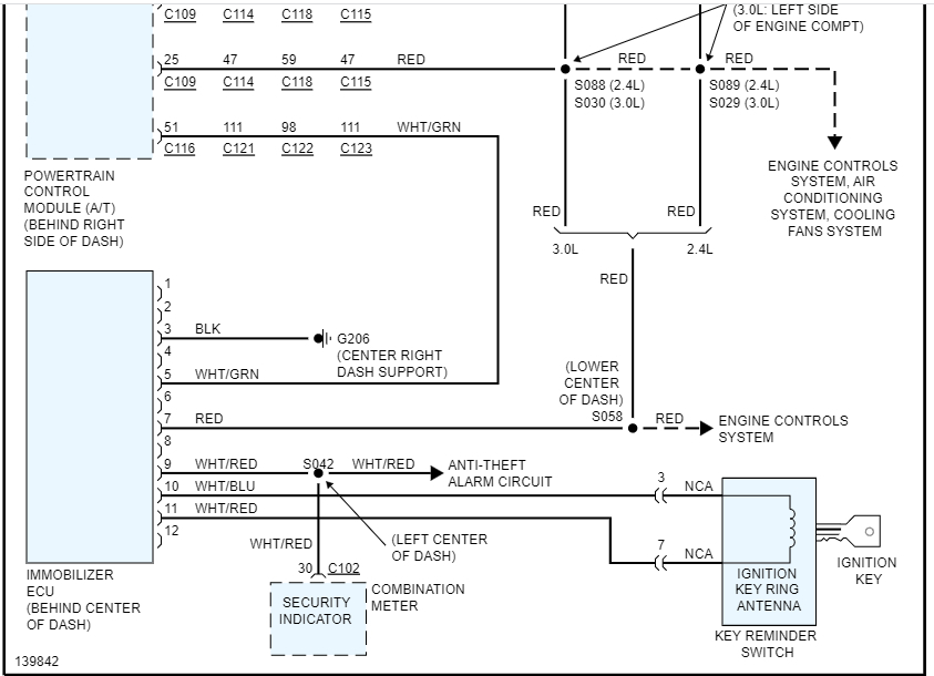

I bought a car that I had to replace ignition switch but installed a push start. I need a diagram or schematic for system circuits due to original owners cut a lot of wires that I'm not sure what they connect to.
Jul 23, 2022 at 5:57 AM
  • 110,240 POSTS

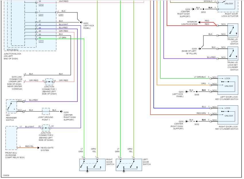

If you look below, I attached the wiring schematics you requested. The first two are the anti-theft alarm circuit.
Pics 3 and 4 are the anti-theft immobilizer circuit. As far as the pics I attached, the schematics were one page long. I had to cut them in half to make them readable for you. I did overlap them so you can follow from one to the next.
Let me know if this helps.

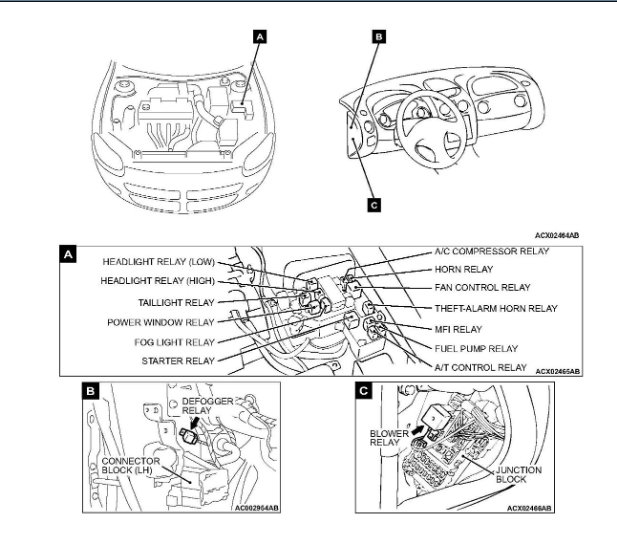

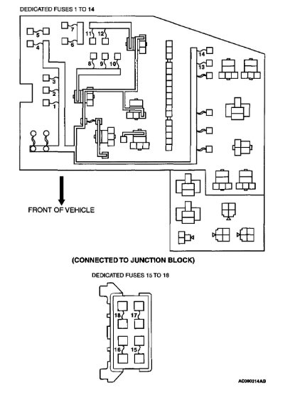

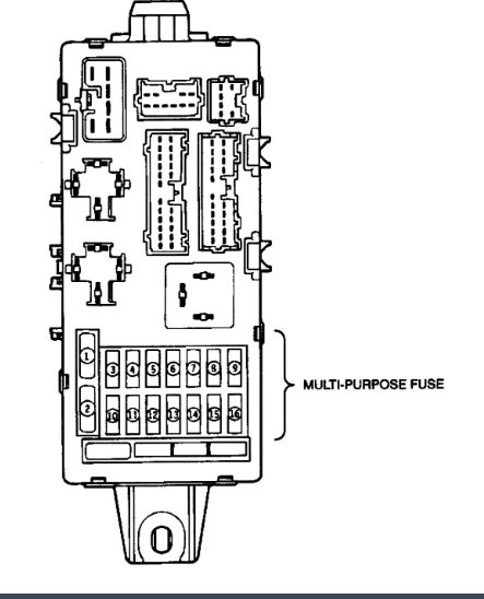

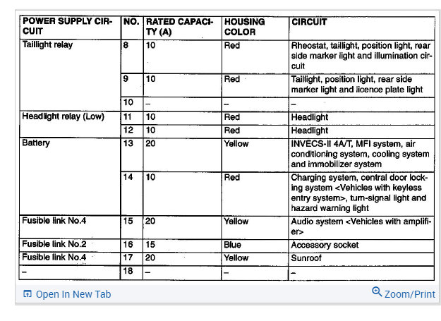

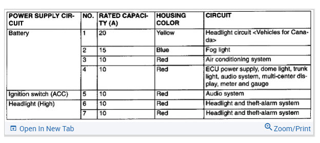

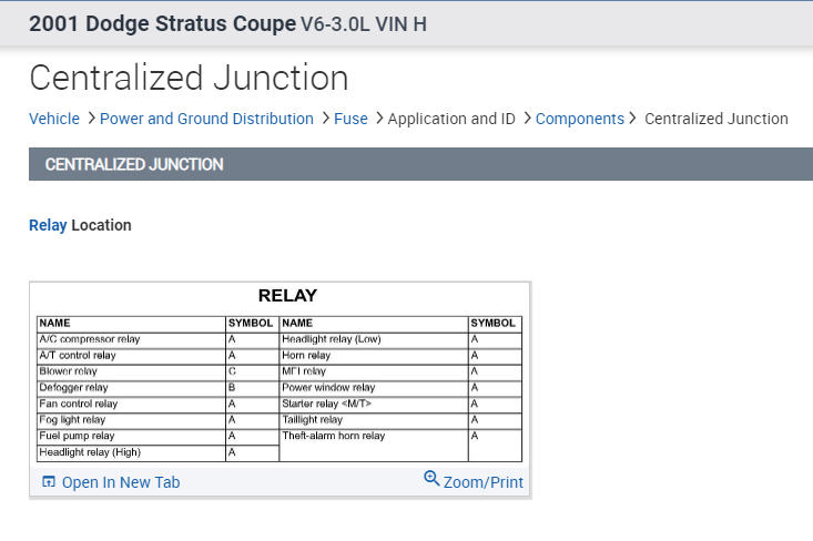

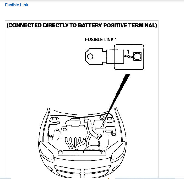

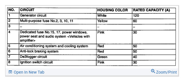

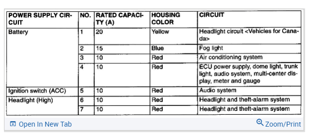

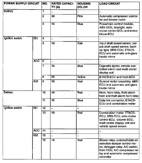

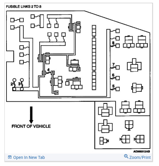

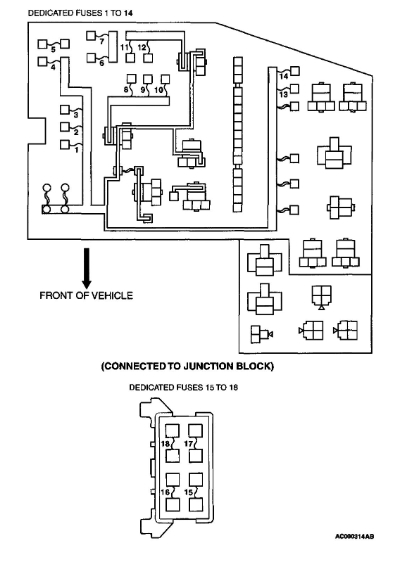

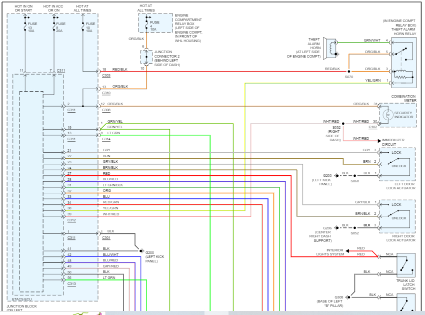

Now my next problem is finding out what the fuses and relays on engine compartment fuse box and inside under dash the cover only specifies to size of fuze but not what it's for I'm going crazy trying to figure it out it's. 2001 Dodge stratus rt coupe but has a 6g72 engine standard transmission help please
Aug 9, 2022 at 1:56 PM
  • 110,240 POSTS
I'm not sure if it will help, but I attached everything I have for the fuses and junction boxes. If things were modified, I'm not sure what was changed.
Take a look through the pics below. Let me know if they help.
Aug 10, 2022 at 4:05 AM

No problem whatsoever. I just hope they help. In most cases, and for what reason I don't know, my manuals provide basically useless information when it comes to fuses on a Chrysler product. This what much better than I expected.

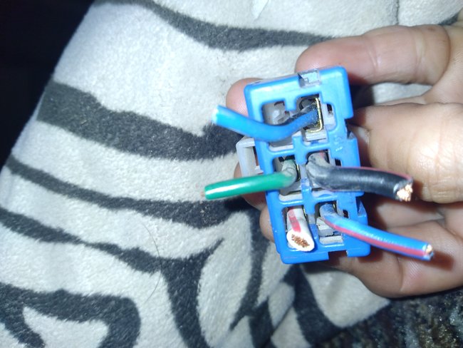

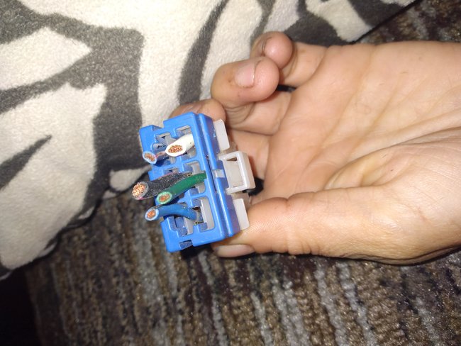

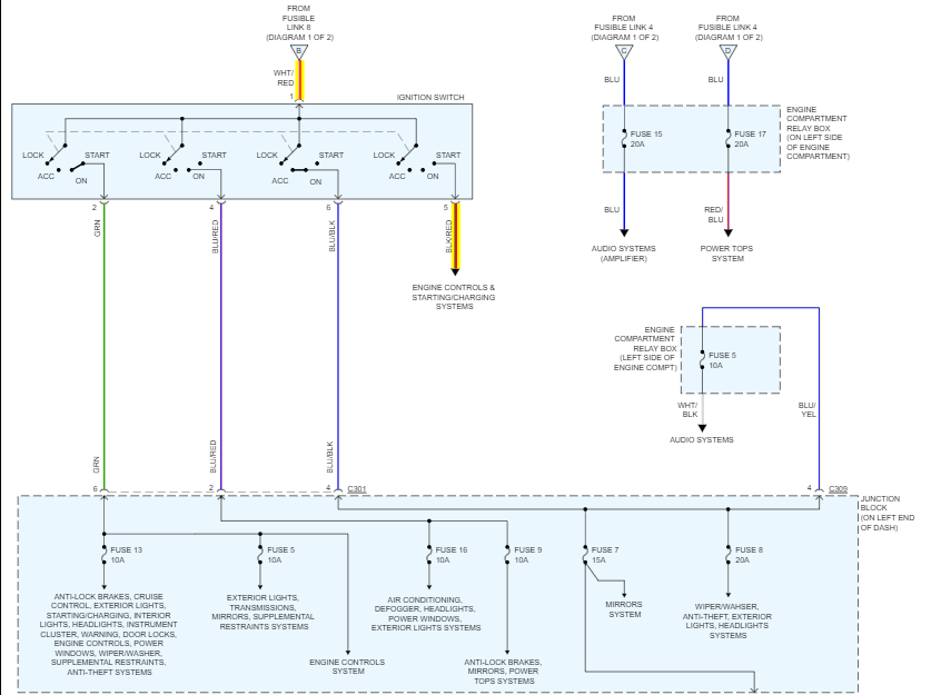

Yes, it matched thank you so much, honestly, it helped out a lot. one last question is, now concerning the ignition switch pertaining to the colored wires what they connect to theirs several wires that I'm lost as to what they connect to. I have a picture of connector or harness not sure name of it. Not sure if that's included in any of the images you've already sent me..
Aug 10, 2022 at 7:55 AM
  • 110,240 POSTS
The black wire with the red tracer goes from the switch to the starter relay to energize it. The white wire with the red tracer comes from fusible link 8 in the under-hood fuse box. The power from that wire goes through the ignition switch and then to the starter relay when the key is in the start position, and it powers other fuses in the junction box on the left side of the dash.
I attached a pic below related to the switch and power distribution in the junction box. The black wire with the red tracer in the pic shows it is to engine controls/ignition. That is the one that goes to the starter relay primary side.
See pic below.
Aug 10, 2022 at 8:59 AM

That code is for the immobilizer, but the code isn't listed for this vehicle. LOL Now I'm confused.
I have a feeling it may be the result of the PCM not recognizing a key.

The fuel pump is shut down by an immobilizer. The other modules on the vehicle likely are waiting for clearance to allow the vehicle to run.
That is the only other thing I can think of.

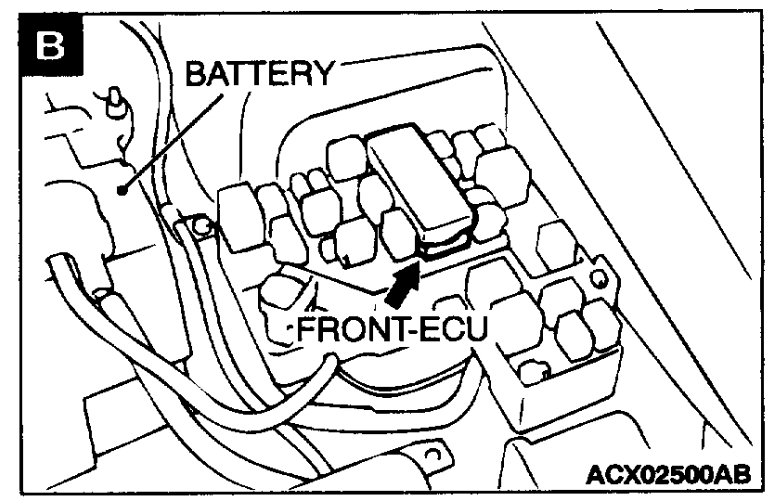

LEYNA07
  • 41 POSTS
Thank you, that's what I figured. Now I will be checking ECU in engine fuse box or fuse box inside car apparently there's one there too.
Aug 18, 2022 at 3:25 PM
  • 110,240 POSTS
There is one there. I attached a pic below showing its location. I hope this helps.

LEYNA07
  • 41 POSTS
If I'm not getting ground, I check ECU, but on engine compartment fuse box or inside fuse box to test ground wire.
Aug 20, 2022 at 2:08 AM
  • 110,240 POSTS
I would first check it at the relay location in the box. If there is no ground, then I would go to the ECU and check it there. If there is no ground being provided by the ECU, chances are it has failed.

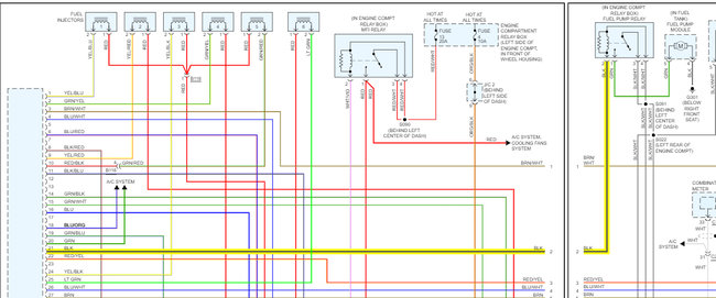

So, finally I was able to finish looking into the car and located the computer and discovered I'm not getting any power to computer. What's next for me to do? Could someone please help me out...

  • 110,240 POSTS
Are you referring to the powertrain control module? Is that what isn't getting power?
Let me know so I grab the correct schematics.

LEYNA07
  • 41 POSTS

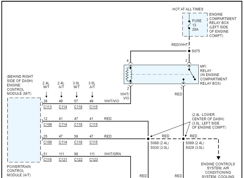

Well, you see my issue is my fuel pump wasn't engaging found out not getting ground side on relay circuit but not sure what to do next. Also seems like my fuel pressure is low or is that from fuel pump not engaging. I used starting fluid to see if car would start and it did but stuck on what to do next on relay or what to check and where. I have the car listed above rt 3.0l v6 6g72 Mitsubishi engine.
Sep 8, 2022 at 1:00 PM
  • 110,240 POSTS
If you aren't getting a ground from the ECM, that is why you have no fuel pressure. I'm looking at the wiring schematic (see pic below). The ground signal is provided via a black wire. Go to the ECM on the passenger side and locate that black wire. With the battery disconnected, remove the connector and check for continuity in the wire itself. Also, make sure there is no damage at the connector or corrosion.
If that checks good, then check right at the ECM for a ground path. If there isn't one, the ECM is my first suspect.

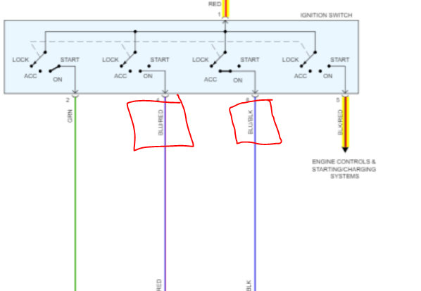

Question in regard to my ignition switch. Now my blue with red tracer and also my blue with black tracer say one says it connects to accessory heater blower 1 and blue and black connect to accessory heater blower 2 now if I'm eliminating ignition column switch and installed push start with accessory toggles how would I wire those two wires...
Sep 24, 2022 at 3:24 AM
  • 110,240 POSTS
I'm not sure how you have it toggled, but the blue/black needs power in acc and the run position and the blue/red only should have voltage in the run position.
Is that what you need? See pic below.
