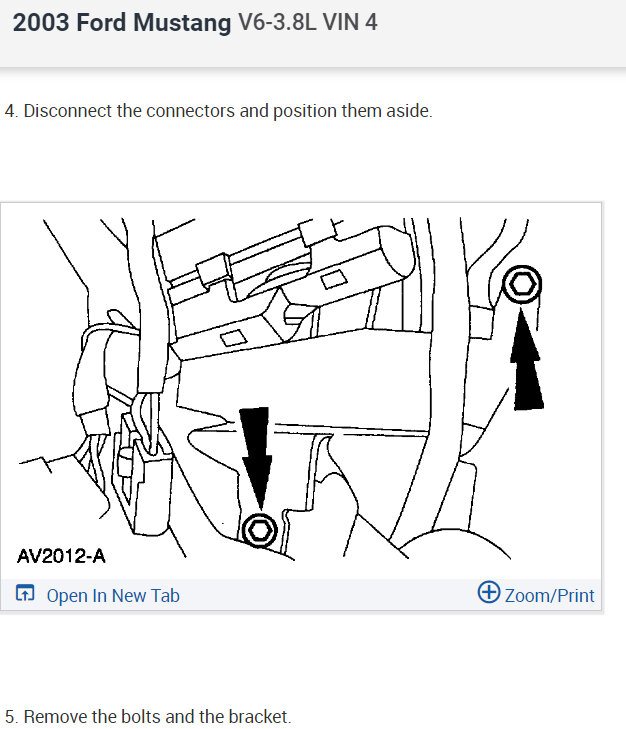

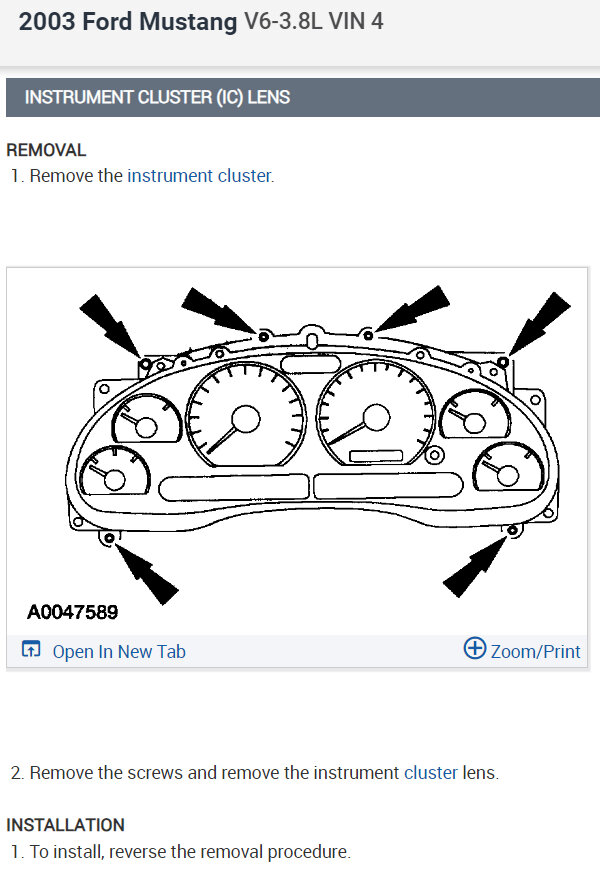

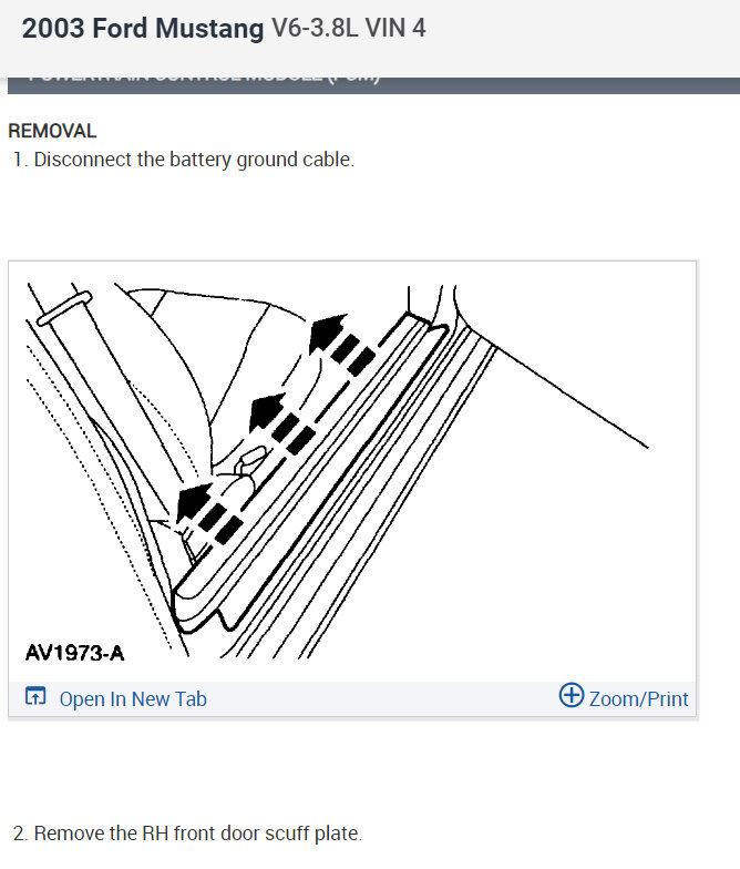

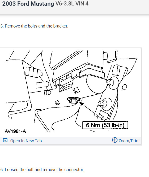

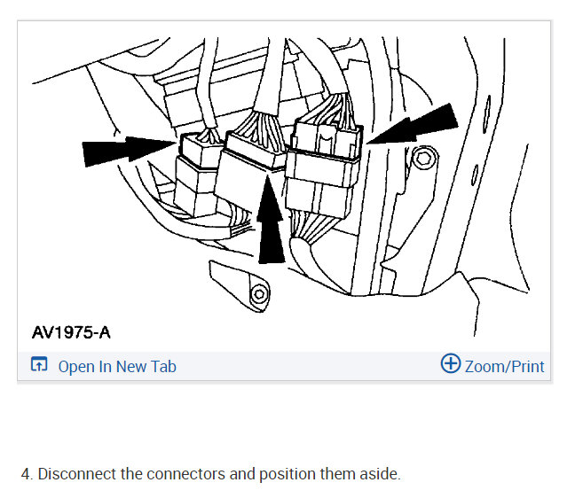

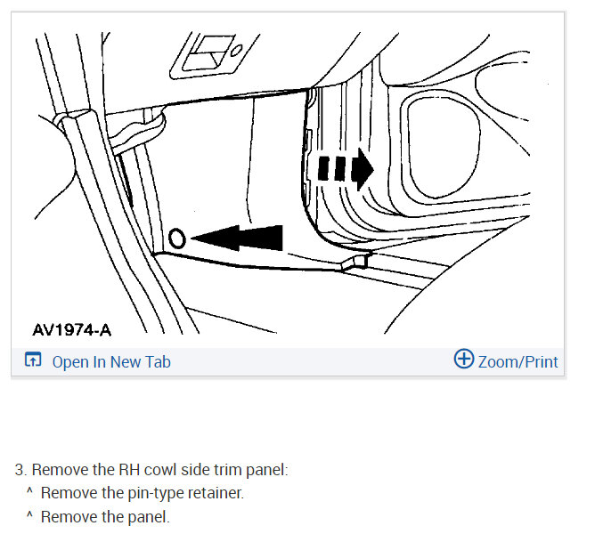

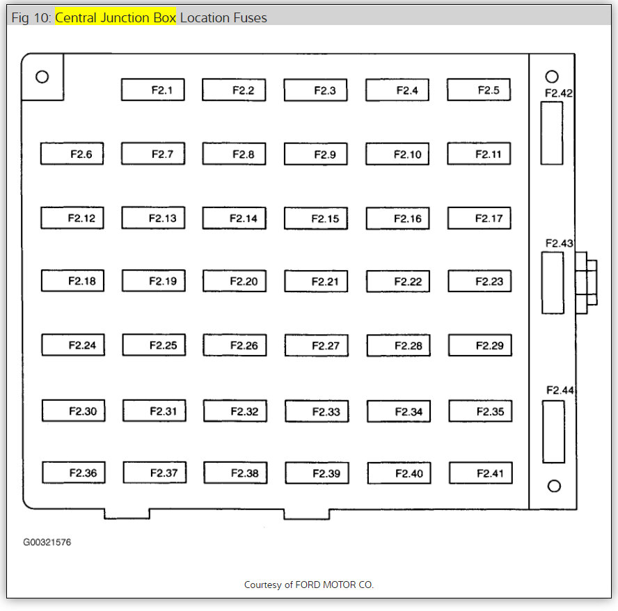

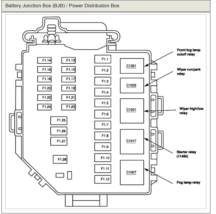

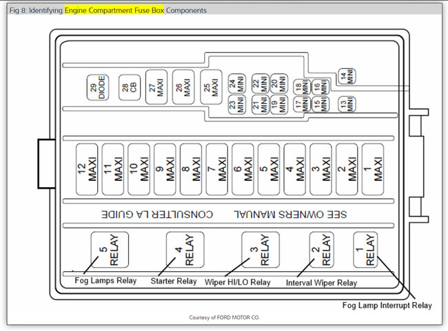

Yep, the groans are different, can I get a short video of the noise, you can upload it with your response. I would start by checking all of the fuses with the system on.
This guide can help:
The fact that the milage is dashes and no obd2 connection is telling us the dash cluster might be bad which is common with these issues. Here are the fuse locations. If the fuses are all good, I would remove the cluster and send it in for testing/repairs. Check out the images (below). Please let us know what happens.

I have been busy the last couple days, so I haven’t been able to test all the ideas you sent yet. I plan to try them out on Wednesday. I have checked several fuses that I thought might be the problem, but I will go ahead and check all the ones you recommended.
Do I have to send in the cluster for repairs or could I find one at a salvage yard to use?
When you say, ‘Check the fuses with the system on’ do you mean turn the key to the ON position and then test the fuses? If so, what is the reason for this?

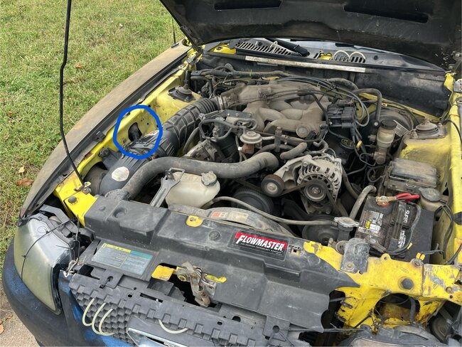

Thanks for the video. can you put your hand on where the noise is coming from? It sounds like a relay is shorting out, we must find out what is making the noise. For the fuse testing, it is to use a test light to see if the fuse is good and that is has power as well. Could it be the blower fan motor making the noise? Please let me know, I am interested.
Sep 24, 2024 at 5:24 AM
DSCHWINDT
  • 51 POSTS

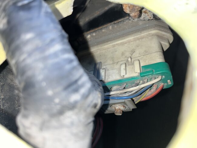

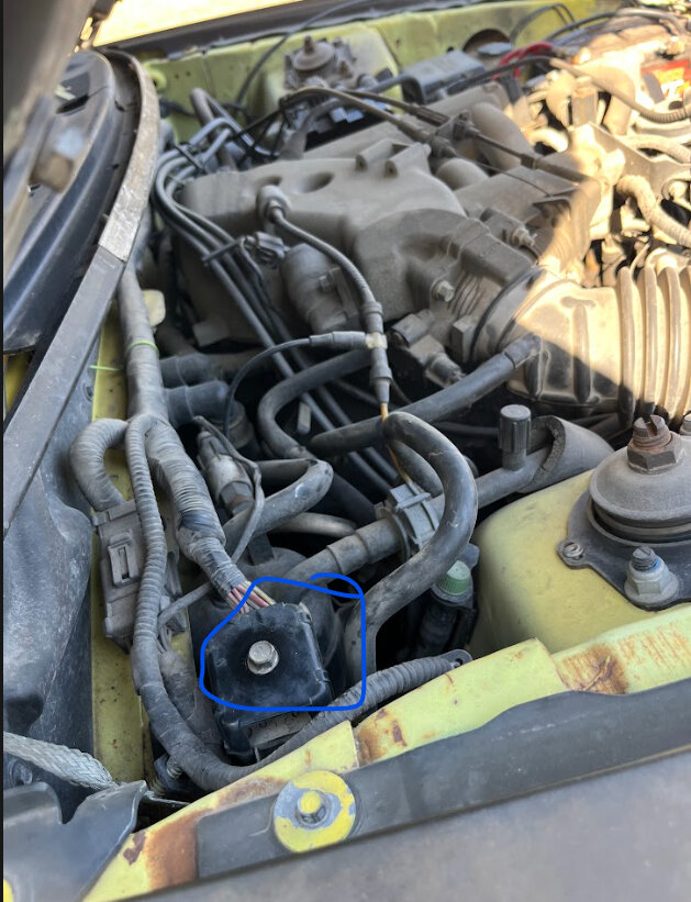

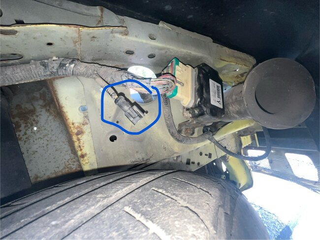

This seems to be where the noise is coming from. The closeup photo is of the component that seems to be making the noise. When I touch it I feel a vibration, so it makes sense if the noise is also coming from it. Any idea what that component is?

So, I tested my fuses and most of the fuses lit up the tester bulb on both contacts of the fuse, and a few of the fuses didn't light up the bulb on either contact. Also, big development! When I went to test my fuses, I turned the key to the ON position, and everything was happening as usual for the first few seconds. Then I noticed the buzzing sound stopped. So, I tried turning the car on, and it started up and it ran for several minutes until I shut it off. This has happened in the past where the problem seemingly goes away for no reason. So, my problem is not fixed as nothing has changed to have caused a fix, but perhaps this new development will help us figure out the problem.

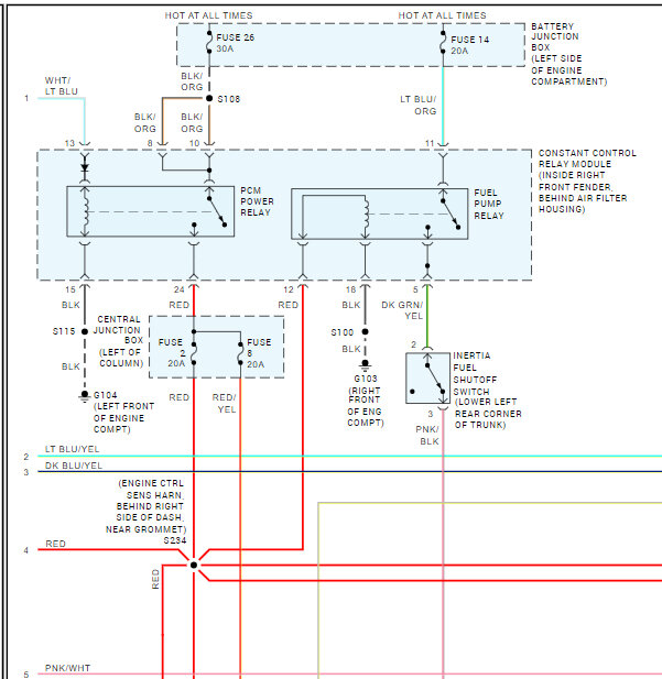

Okay, we are getting closer, the part that is making the noise is the constant control relay which houses the fuel pump and PCM power relays, I would try to get a replacement to see if that makes a difference. Here is a wiring diagram so you can see how it works and which wires to get for power and guide, this guide can help:

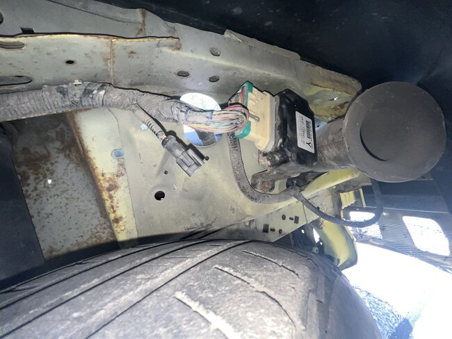

Here is a photo I took of the CCRM, and I noticed there is an electrical plug that is hanging loose and not connected to anything. I can't find anything that it could connect to. Any idea what this plug goes to, and could it be the source of the problem?
Also, thank you for the wiring diagram of the CCRM. I am guessing power should be present at pin 11 on the CCRM at all times, but what would cause the fuel pump/pcm power relays to switch over to pins 5 and 24 respectively? Is power supposed to be present at pins 5 and 24 once I turn the key to the ON position?

I don't see the images? Also, I had a thought that the engine to chassis ground could be bad or not connected. I would check the ground from the battery to the engine and then to the chassis. This must be a good connection or you will have strange problems like this.

I apologize. I guess I forgot to add the photo. Here it is.
Sep 29, 2024 at 3:51 AM
  • 55,721 POSTS
Yep, this is it, which it looks like it could have water damage, what happens when you replace it, also did you check the grounds form the battery to the engine and chassis?

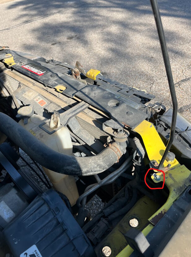

I checked this ground, and it was very dirty so I cleaned it. Is this the correct ground you wanted me to check?
I disconnected the ground completely and turned the key to the On position, and the car reacted in a unique way (unlike the problem I’ve been having), so that makes me think the ground isn’t the problem unless that was the wrong ground I checked.
Oct 10, 2024 at 4:19 AM
  • 55,721 POSTS
Yes, that is the main ground, I would remove it and clean it with a wire brush, it should be clean metal to clean metal. Let me know what happens.

Okay, I removed the ground and cleaned it well. I am still concerned about this connector in the photo though. Do you know the purpose of this connector and what it should be connected to?

I don't think the replacement is bad in the same way, it sounds more like a ground issue or something plugged into the CCRM is shorted. Let's unplug the CCMR and check the blk/wht wire for ground by using this guide. It must be unplugged to do the test.
Please go over this guide and get back to us.

I tested the ground on pins 15 and 18 (pin 15 is the black and white wire). Pin 18 ground is fine, but the black/white ground is not. Do I need to replace that wire or something?
Oct 17, 2024 at 11:25 AM
  • 55,721 POSTS
Both black wires to the CCRM should be grounded. If not, run new grounds and try it to see what happens.

Pin 12 on the CCRM is supposed to have power when the key is on but it does not. Pin 12 does come from the PCM, so I took off the PCM to test the wire that runs to pin 12. This wire showed connectivity and less than one ohm of resistance. So, pin 12 should be getting power from the PCM, but it is not. I can check later if the noise goes away when the PCM is disconnected.

I forgot to inform you that I found the problem. It was indeed a loose ground wire, but because it was loose it would alter between being grounded and not being grounded. When I checked the grounds, I only checked them electrically (and at that moment the loose wire was grounded). I should have checked them all by wiggling them to see how tight they are. To be clear, it was one of the grounds right on front of the battery. Thank you for your help! Your guidance is much appreciated.
