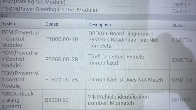

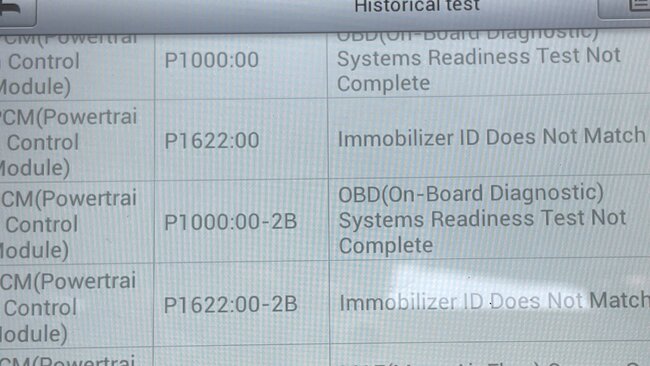

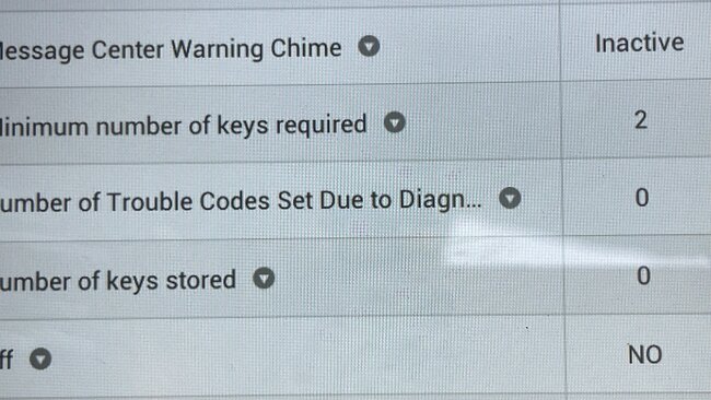

Unable to program keys after waiting for the 10 minutes as required by the system. It says key programming failed. have codes like p1260:00-2B. p1622:00-2B. b2900:E0.

Do you have the Autel MaxiIM IM608PROIIKPA, MaxiIM IM508S, and MaxiIM KM100? These are designed to program automotive keys and fobs.
P1260:00-2B - Theft Detected, Vehicle Immobilized
P1622:00-2B - Immobilizer ID Does Not Match
B2900:E0 - Vehicle Configuration Mismatch
Please let me know.

Because I used super to to configure the chip to 4d 63 id is this the correct transponder for this 2010 model?

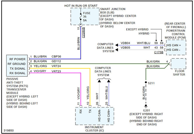

I have tried the hard reboot. But I am sure the Immobilzer antenna is faulty, it’s a 4 wire pins, can you get the signals.
Also will think of replacing.
Apr 16, 2025 at 1:39 AM
  • 55,746 POSTS
Good call, if the antenna wiring is broken the system will not receive the signal.
Apr 17, 2025 at 2:12 AM

Hi Ken, after close verification, the antenna anti-theft works very well.
May I have a diagram of the Anti-theft indication with modules like the PCM it runs through. I noticed it goes through the instrument cluster as well.

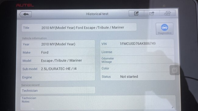

ANDRIN ATEM
  • 414 POSTS
1FMCU9EG6BKA06593 This vin is the Chassis, on the left windscreen.
1FMCUOD76AKB86749 This Vin is the current ecu found in the car, meaning the previous technicians had replaced it.
In order to be on track, if I may have the immobilizer pin out for this 2 units I can verify where the mismatch is coming from.
Apr 21, 2025 at 10:55 PM
  • 55,746 POSTS
It seems like the PATS transceiver module is bad. Here is the wiring diagrams for it. Check out the images (below).

I had double checked this, the transceiver is ok, actual problem is the main pcm has been replaced, the previous was a 2010 and the new is a 2011, I have an error code of VIN mismatch and key code mismatch.
I wonder if the change could be the problem.
Apr 22, 2025 at 6:22 AM
  • 55,746 POSTS
Yep, that will do it, that would have been good info to have.

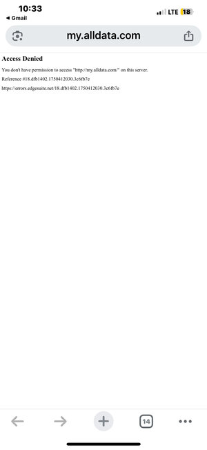

Hi Ken, please can you help me with the full network diagram for this car, so I can verify certain modules which are not on the network system. Please!
Jun 19, 2025 at 12:57 AM
  • 55,746 POSTS
Sure, here you go:
https://my.alldata.com/
Let us know if you need anything else.
Jun 19, 2025 at 3:30 AM
ANDRIN ATEM
  • 414 POSTS
Access denied.
Jun 19, 2025 at 7:34 PM
  • 55,746 POSTS
Sorry, try alldata.com
