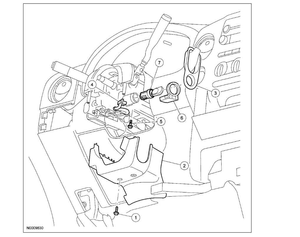

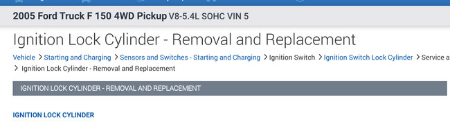

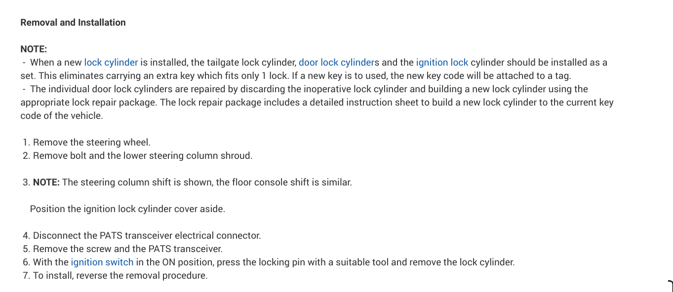

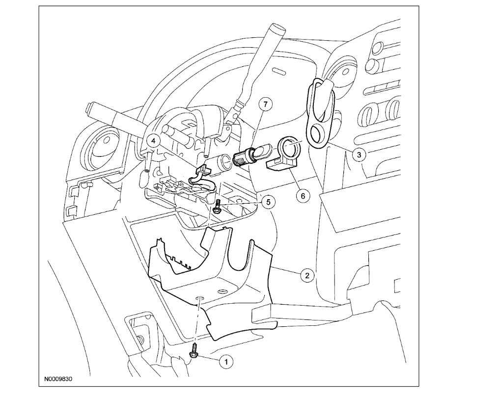

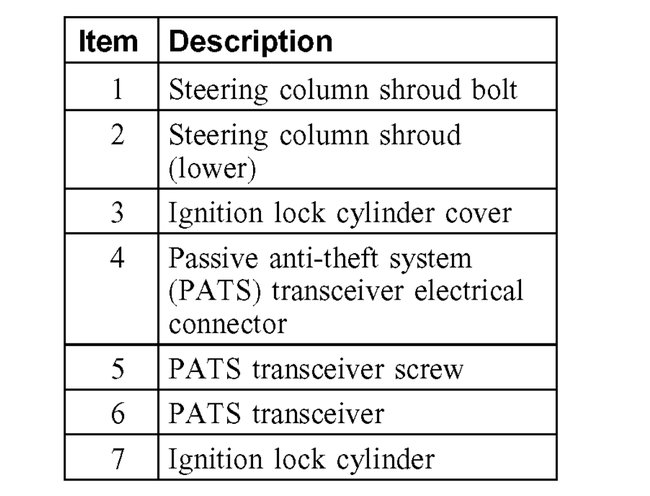

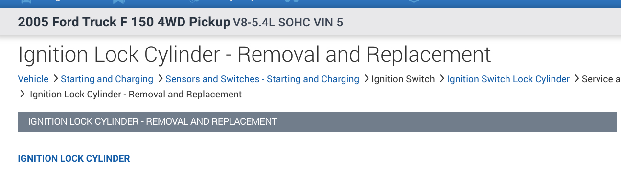

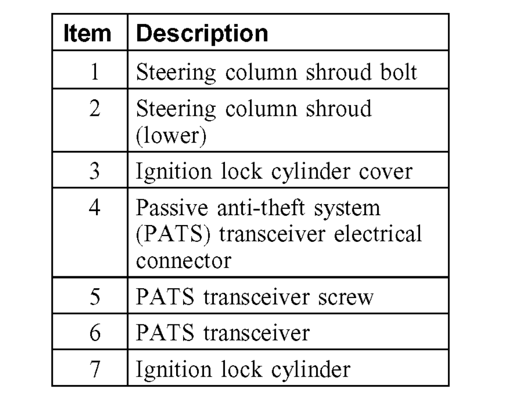

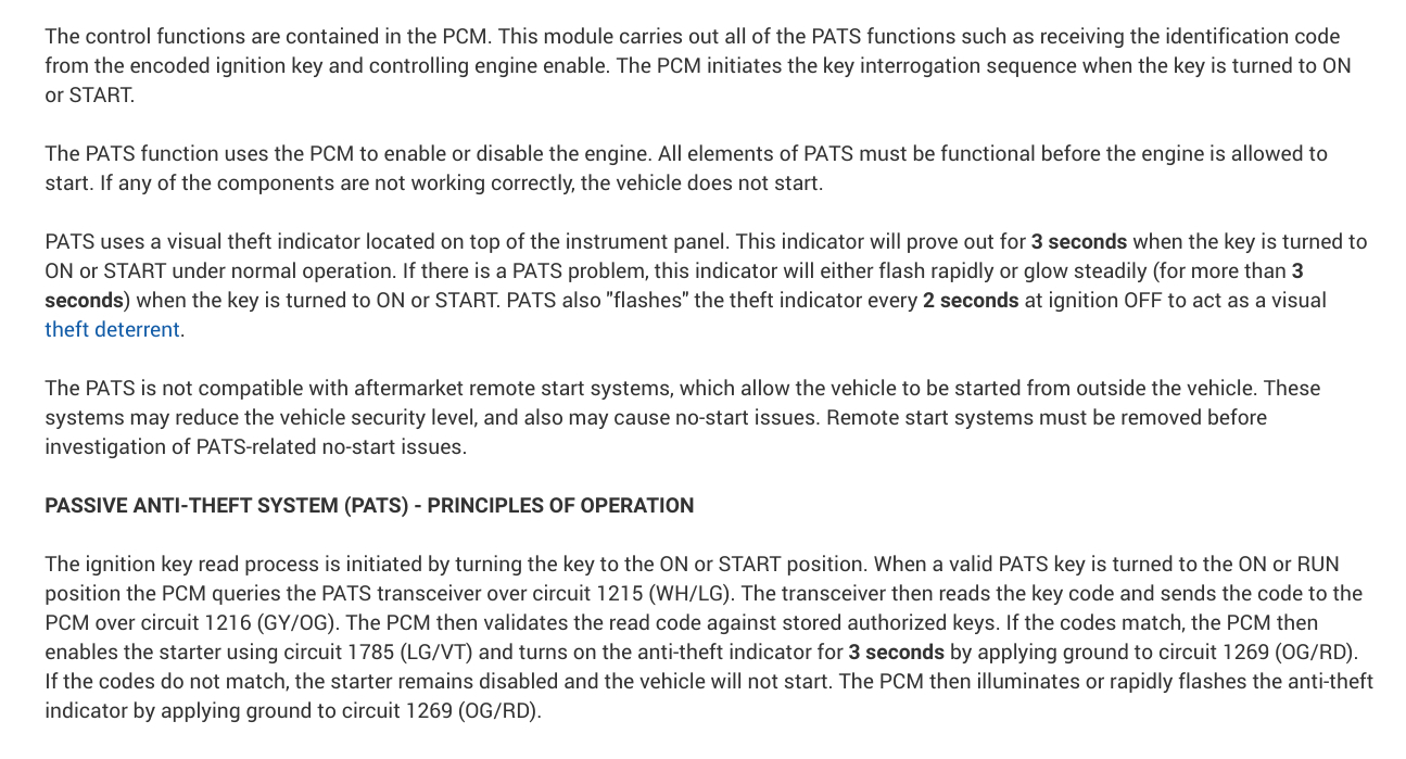

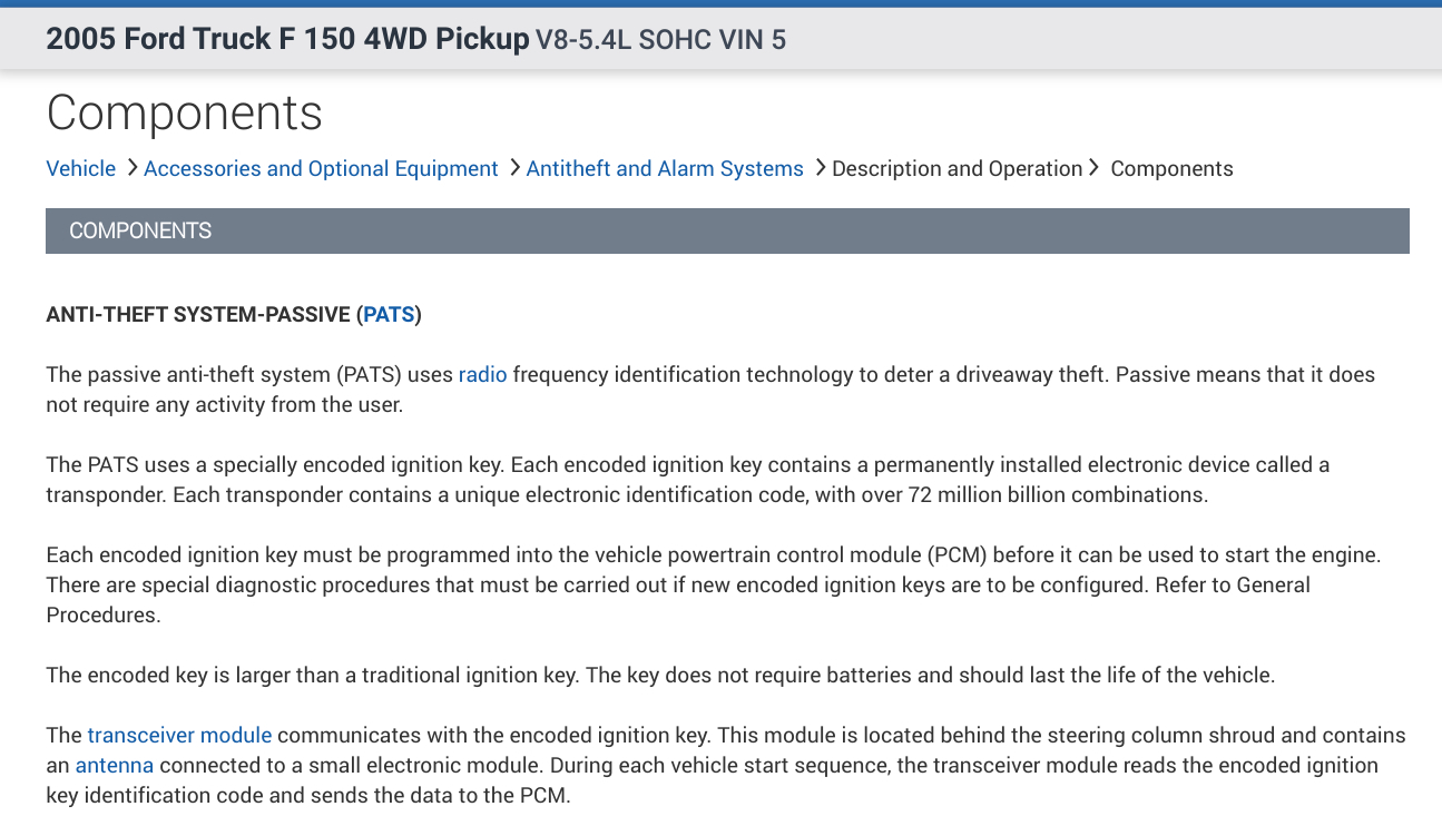

STEVE SLONE
I lost keys, tried to start with screwdriver. Messed pats transceiver up. Well it's over 10 years old so dealership doesn't have key codes. My question is if I get a steering column off a parts truck and pcm. Switch that out in mine will it fix my problem?
Jan 18, 2021 at 10:03 AM (Merged)
SCGRANTURISMO
  • 4,897 POSTS
Yes, if swap out the ignition lock cylinder/keys and the PCM from the same parts truck, then your vehicle should start. In the diagrams down below I have included a description of the PATS system for your vehicle and the instructions for the removal and installation of the ignition lock cylinder for your vehicle as well. Please go through these guides and get back to us with how everything turns out.

EVELYN VICK
Replaced PCM, fuel pump, and fuses. thought this was my problem. truck anti theft system has been flashing fast so trying to reset it. no luck so far please advise.
PATENTED_REPAIR_PRO
  • 1,853 POSTS
If trying a spare key did not work, and getting a new key cut is not something you can or want to do then it appears you are going to have to have the trouble codes retrieved to find out why the security light is on.
EVELYN VICK
It says PAT's is engaged. rubber ring around ignition switch is not reading key to reset PAT's.

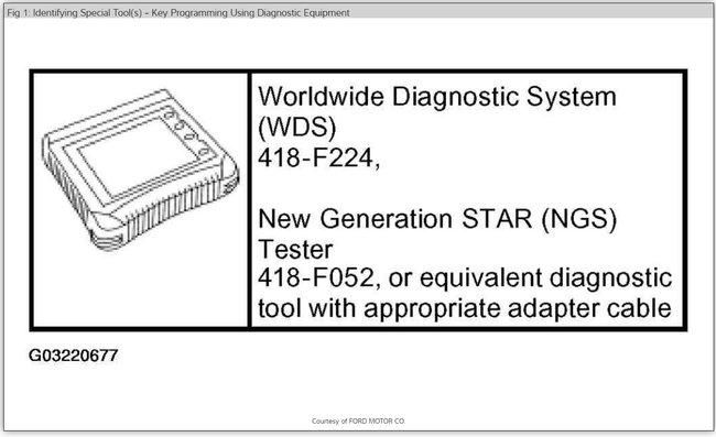

Key Programming Using Diagnostic Equipment
Turn the ignition from OFF to ON.
Using the diagnostic tool, follow the SECURITY ACCESS to obtain security access. Refer to ANTI-THEFT SECURITY ACCESS .
From the diagnostic tool menu, select IGNITION KEY CODE ERASE.
Do not select any additional commands from this menu.
Turn the ignition OFF and disconnect the diagnostic tool.
Insert the first encoded key into the ignition and turn the ignition ON for one second.
Insert the second encoded key into the ignition and turn the ignition ON for one second.
Remove the second encoded key from the ignition.
The vehicle should now start with both ignition keys.
