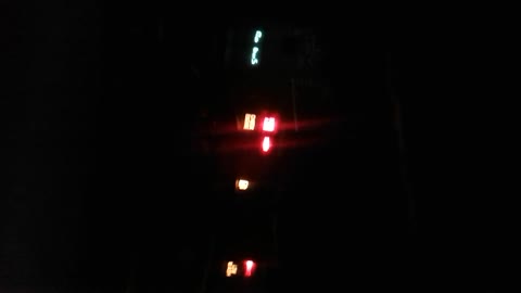

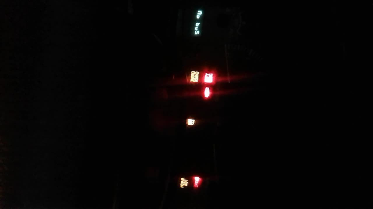

Car won't start, security light on, no fob. Getting spark and sometimes fuel pump kicks in but only when dash lights works and gauges. If pump don't kick in no gauges. Turn ignition to on 3 times fast and wait few seconds, no bus on odometer, security light, check engine, ABS, gas pump and low wash on. Now, i turned key back off then on again, still no pump, but lights mentioned earlier.. Clicking noise as they disappear and odometer flashes 3 times with no bus and same lights reappear to dinging noise like door. However, I now have done this switch on and off round 5 times total and left in on position for few minutes and fuel pump decides to kick in, millage back on and only check engine light is on. now cranked up and running but like really badly. Heavy vibrating and will only idle if gas pedal is held with acute squeak from engine (like wet or lose alternator belt) very possible belt is now and wasn't doing that before when all this started. so not an issue don't think. Help me please! I have given you the whole story i believe, lol.

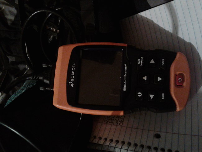

Not sure what code you need, I rewrote these that a friend wrote down while using scan tool and I was told the clicking is relays for security and ABS. What does the instrument cluster look like or does it go by other name? I made 3 videos total I can try and send. The first 2 should give you idea for sure and please excuse the tiredness and attempts to fight frustration, lol.

I watched the videos and saw what is happening. The bus system is basically two wires which connect the modules together so they can communicate. There are several bus codes. See below.

What I see on your vehicle is the "no bus bias. The problem is there are about 20 different codes related to this. So, here is what I want you to try.
The next time the millage screen shows that message, get the OBD2 codes by turning ignition key from the off position to the "on/run" position (not "start") three times. On the third time, leave it in on/run position and look at the millage screen. Codes should appear.
Try that and let me know what you find. Note, if that if this doesn't work, I need you to get your hands on a scan tool to check for codes. Because of the problem type, we need codes otherwise it will become a guessing game.

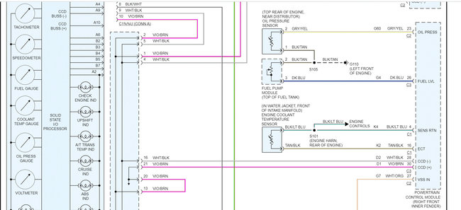

Also, take a look at the attached pic I attached. You will see how the power-train control module, instrument cluster, fuel gauge and so on are tied together. Make sure the connection at the PCM is tight and not corroded. Don't disconnect it to check unless the battery is disconnected. Also, don't reconnect it unless the battery is disconnected.
