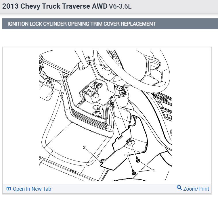

Anti-theft system when you put the key in you cannot turn it backward or forwards?
95,000 MILES
PATTIPAGE
I went and got a new key, and you still can't do it. you can't move the gear shift and you can't push the brakes. help me.
Aug 28, 2023 at 4:10 AM
  • 55,721 POSTS

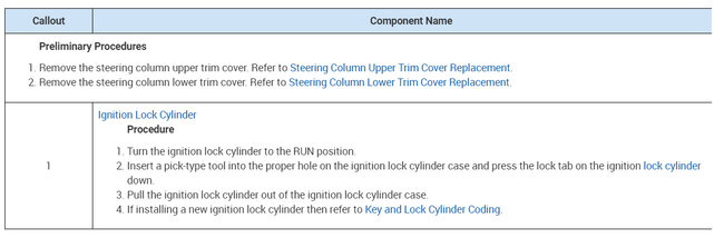

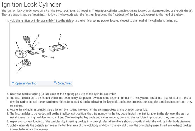

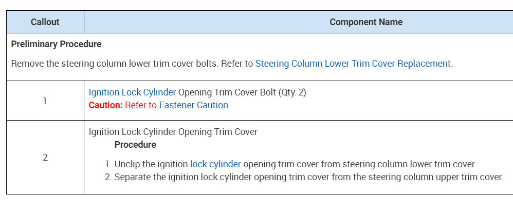

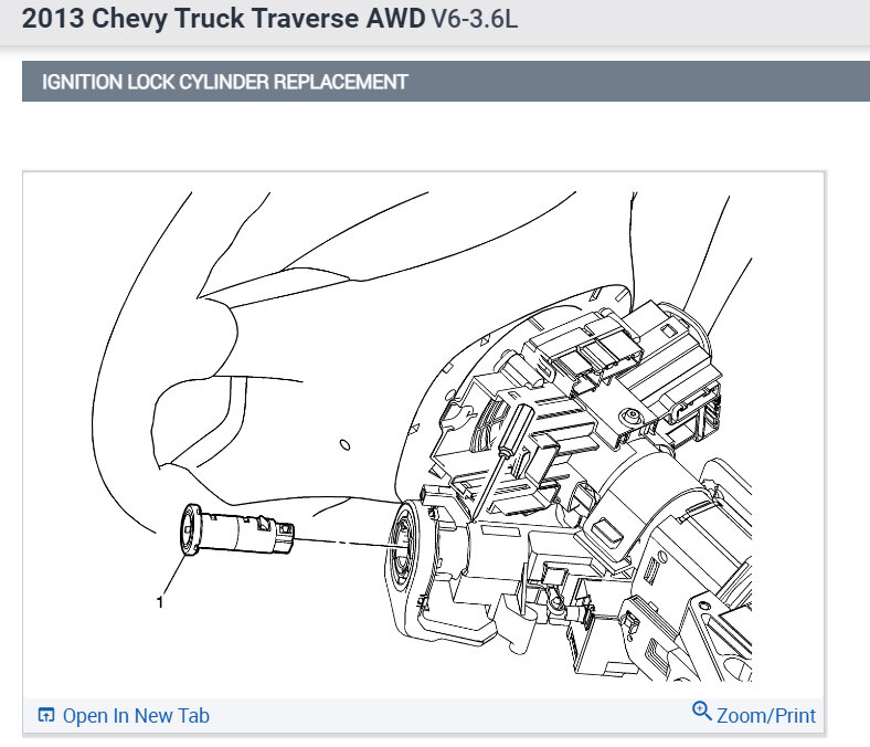

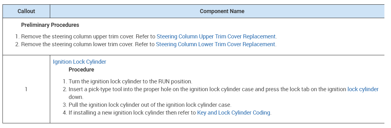

It sounds like the ignition lock tumbler has come apart internally. Here is how to change it out. Check out the images (below). Let us know what happens and please upload pictures or videos of the problem so we can see what's going on.
