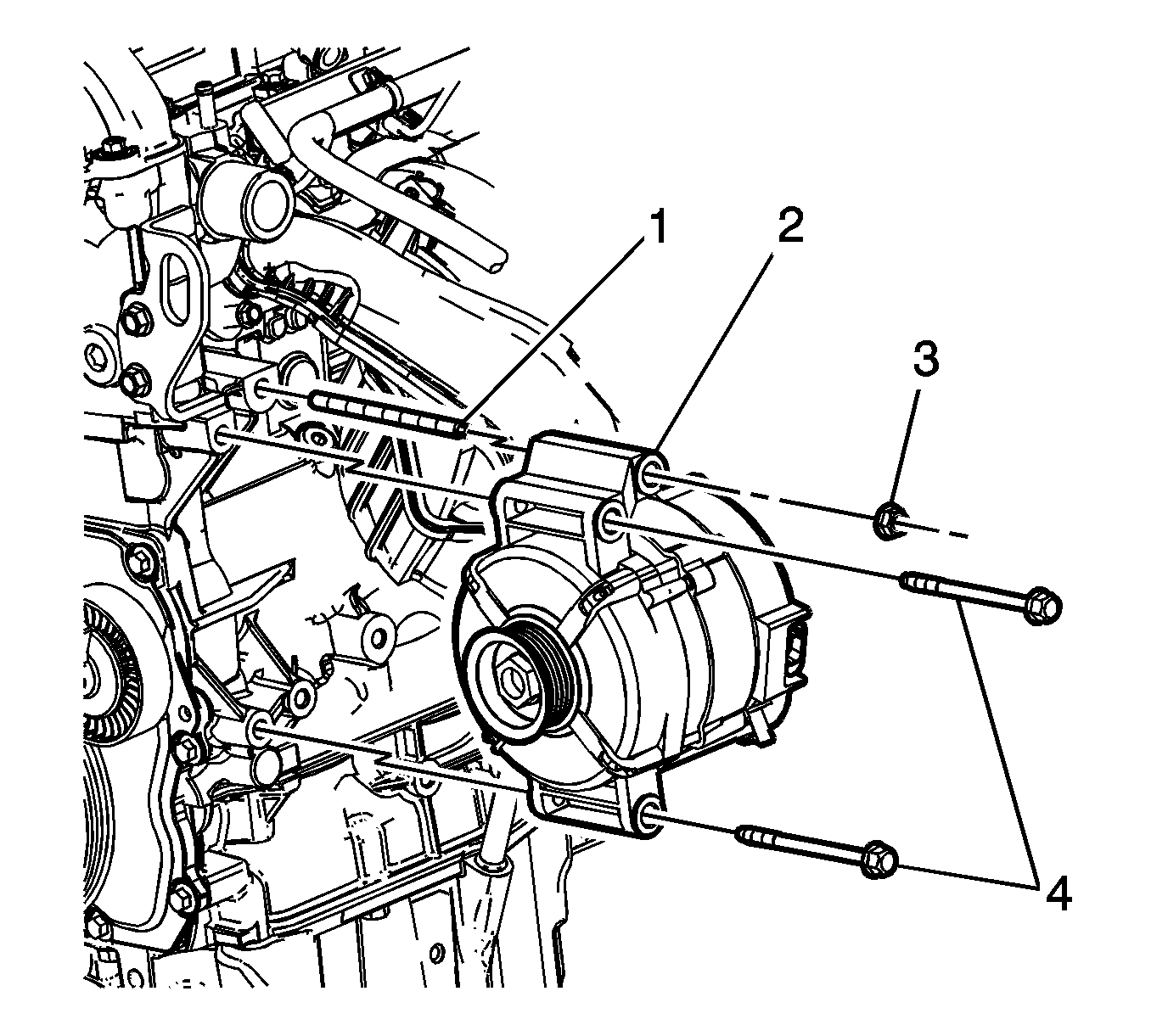

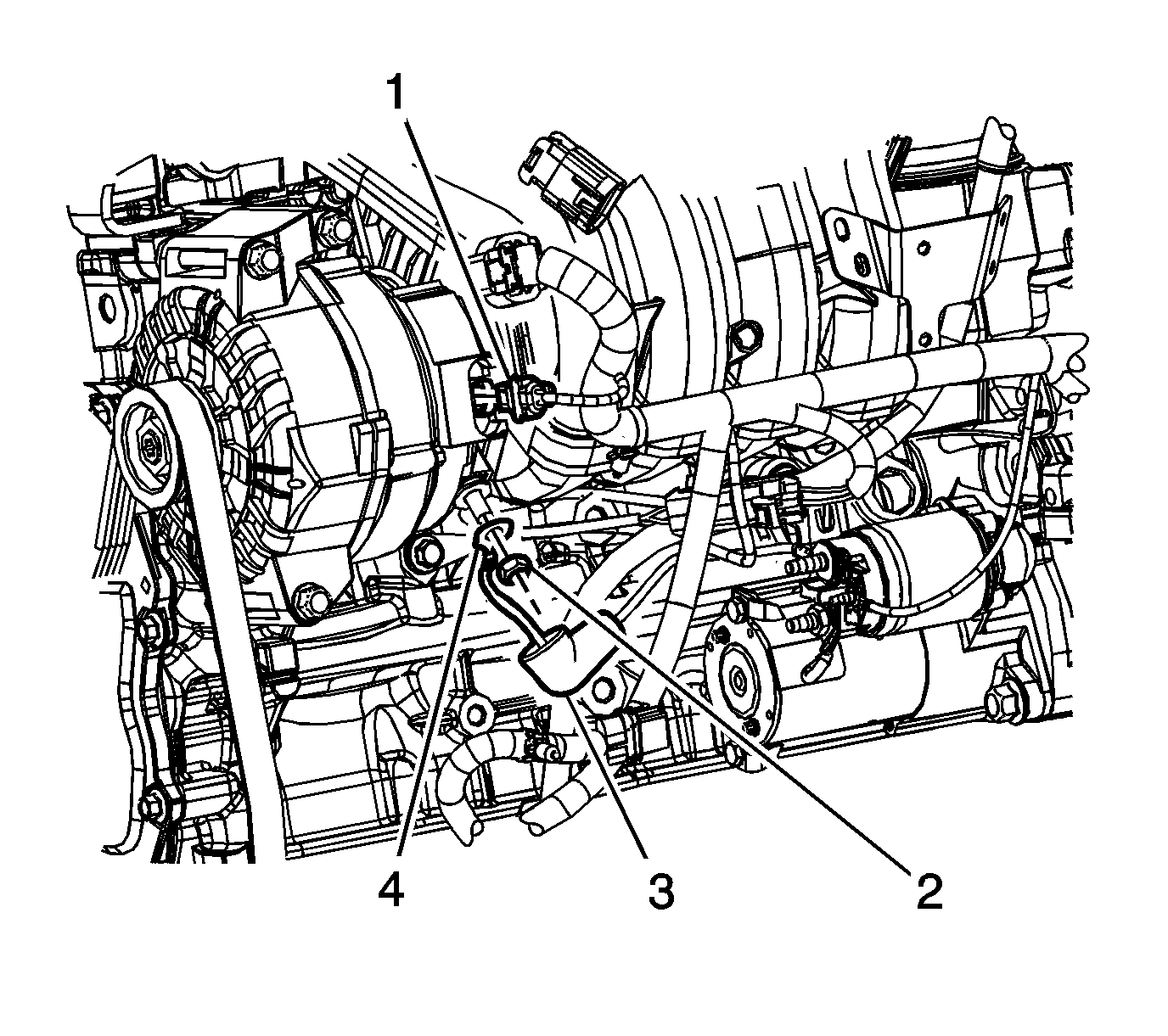

Here are the specific directions. The attached pictures correlate with the directions.

3. Disconnect the generator electrical connector (1).
4. Reposition the rubber boot (3).
5. Remove the engine harness terminal lead to generator nut (2).
6. Remove the engine harness terminal (4) from the generator stud.

7. Remove the generator fasteners (1,3, 4).
8. Remove the generator.
Installation Procedure
picture 3
1. Position the generator to the engine block.
2. Install the generator fasteners (4) loosely.
Caution: Refer to Fastener Caution (See: Vehicle > Vehicle Damage Warnings > Fastener Caution).
3. Install the fastener (1) and tighten to 10 Nm (89 lb in).
4. Install the fastener (3) and tighten to 22 Nm (16 lb ft).
5. Tighten the fasteners (4) to 22 Nm (16 lb ft).
