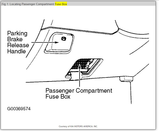

How do I rest the security system on my vehicle? The light stays on and the car wont start. Turns over, but I don't hear the fuel pump running when the key is in the on position.

Does the security light flash? If so this guide will help you reset the system
https://www.2carpros.com/articles/how-to-reset-a-security-system

The security light doers not flash. I even entered the pass code from the dealership. Before I entered the pass code, the horn would not beep when I hit the lock button twice on the key fob. Now it does, but the light stays on. It still will not start.

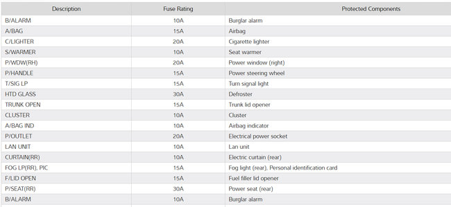

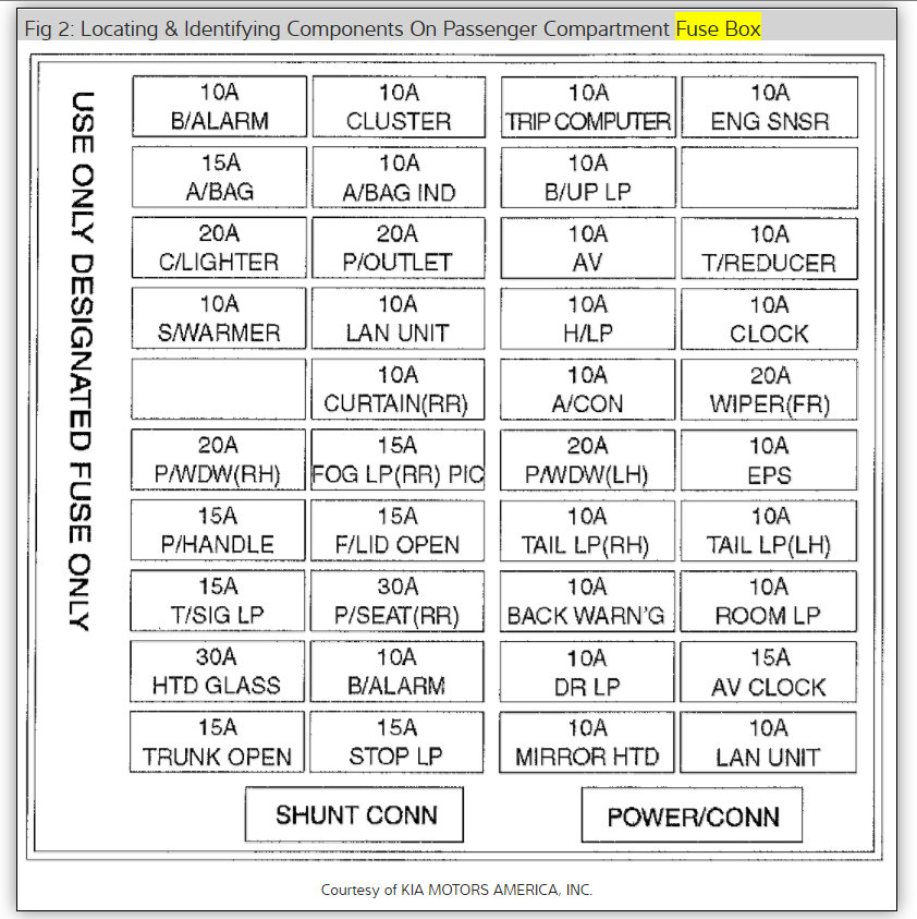

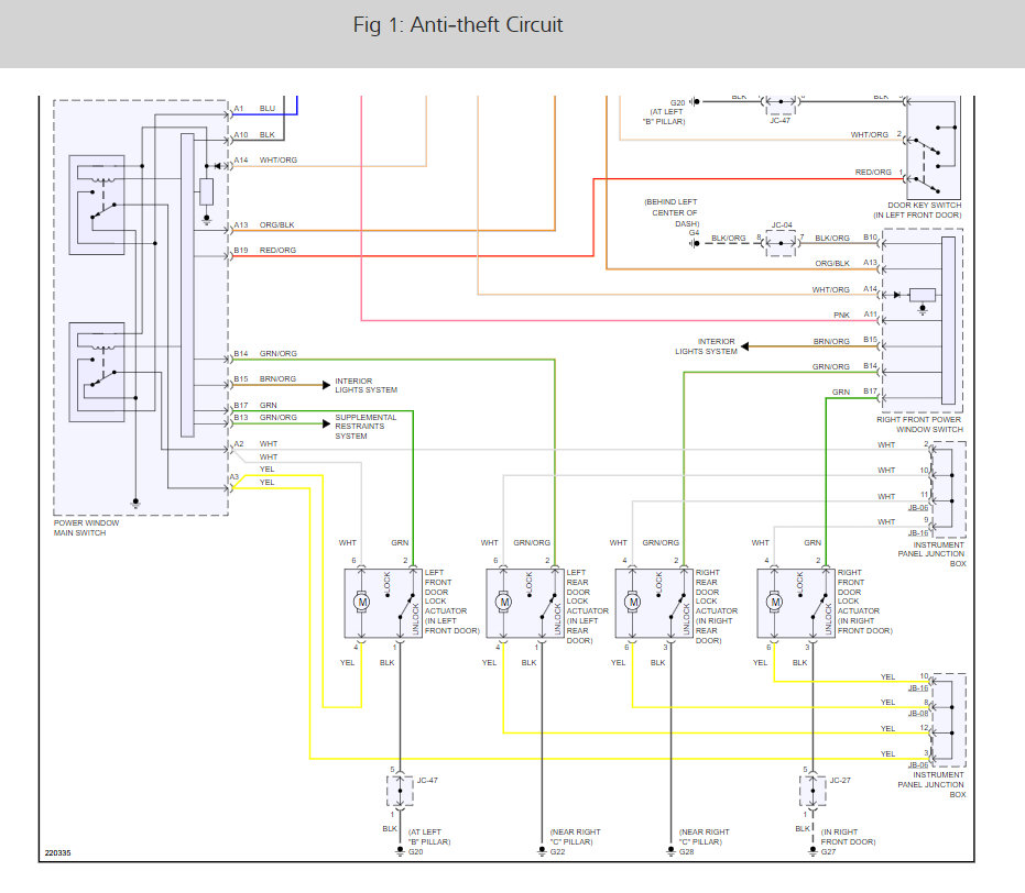

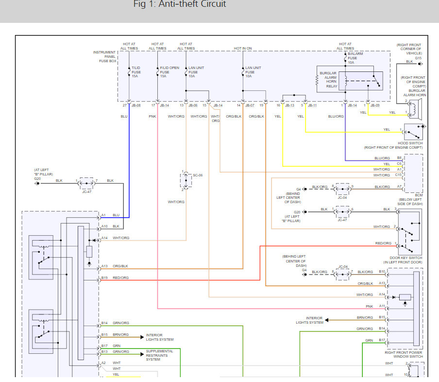

There are fuses in the interior fuse panel we should check. here is a guide to help and the security system wiring diagrams so you can see how the system works and which fuses to check. here is a guide to help as well:
Check out the diagrams (below). Please let us know what you find.
