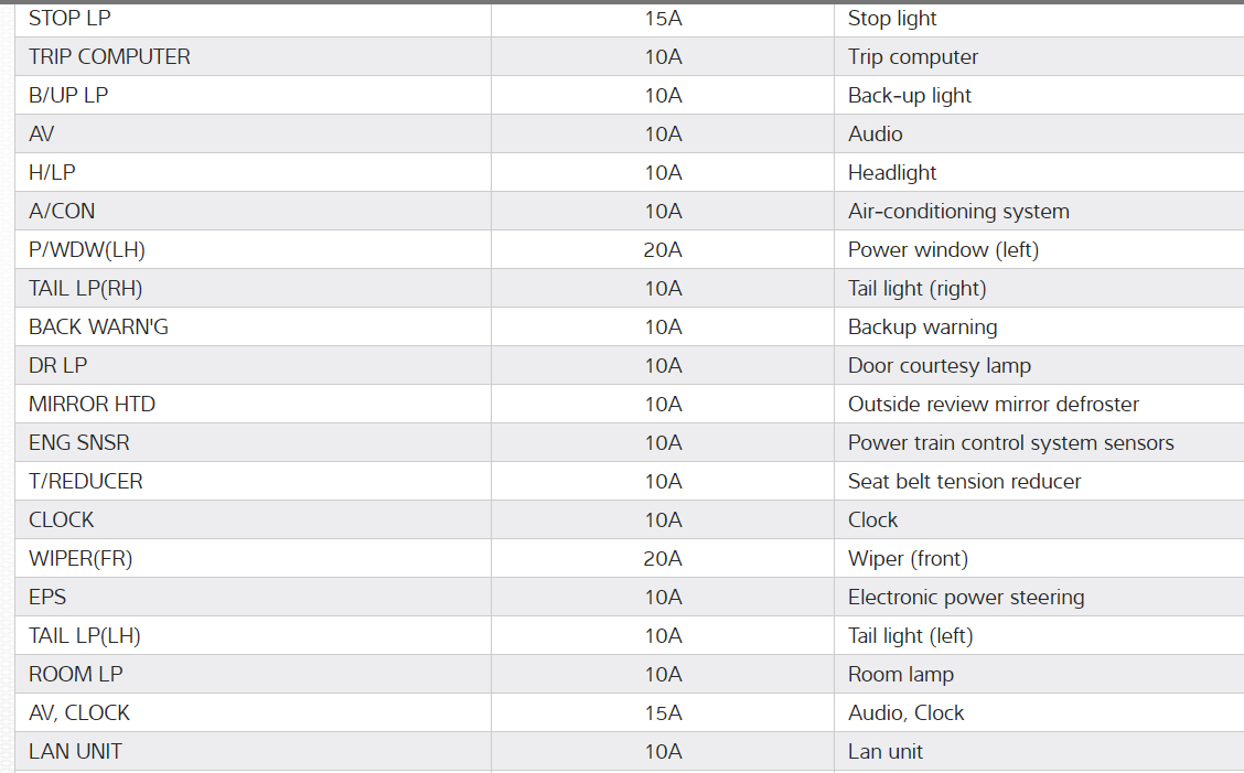

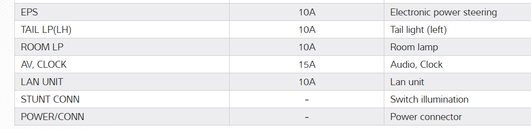

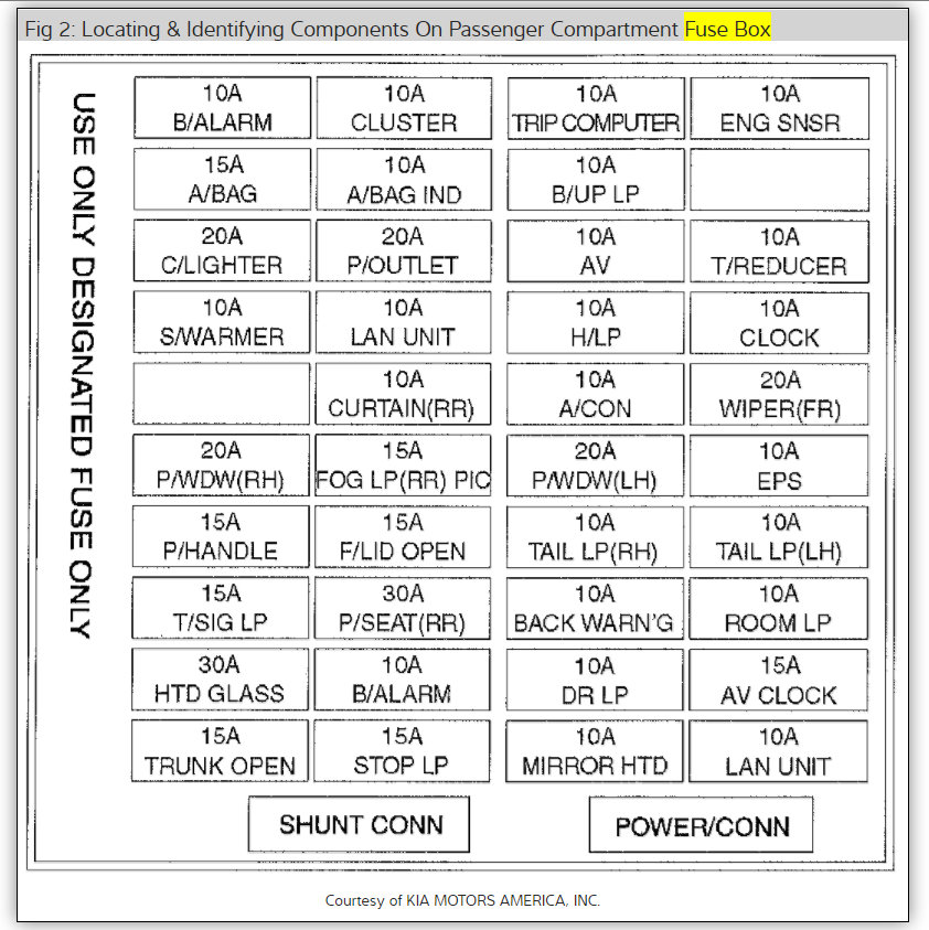

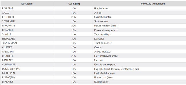

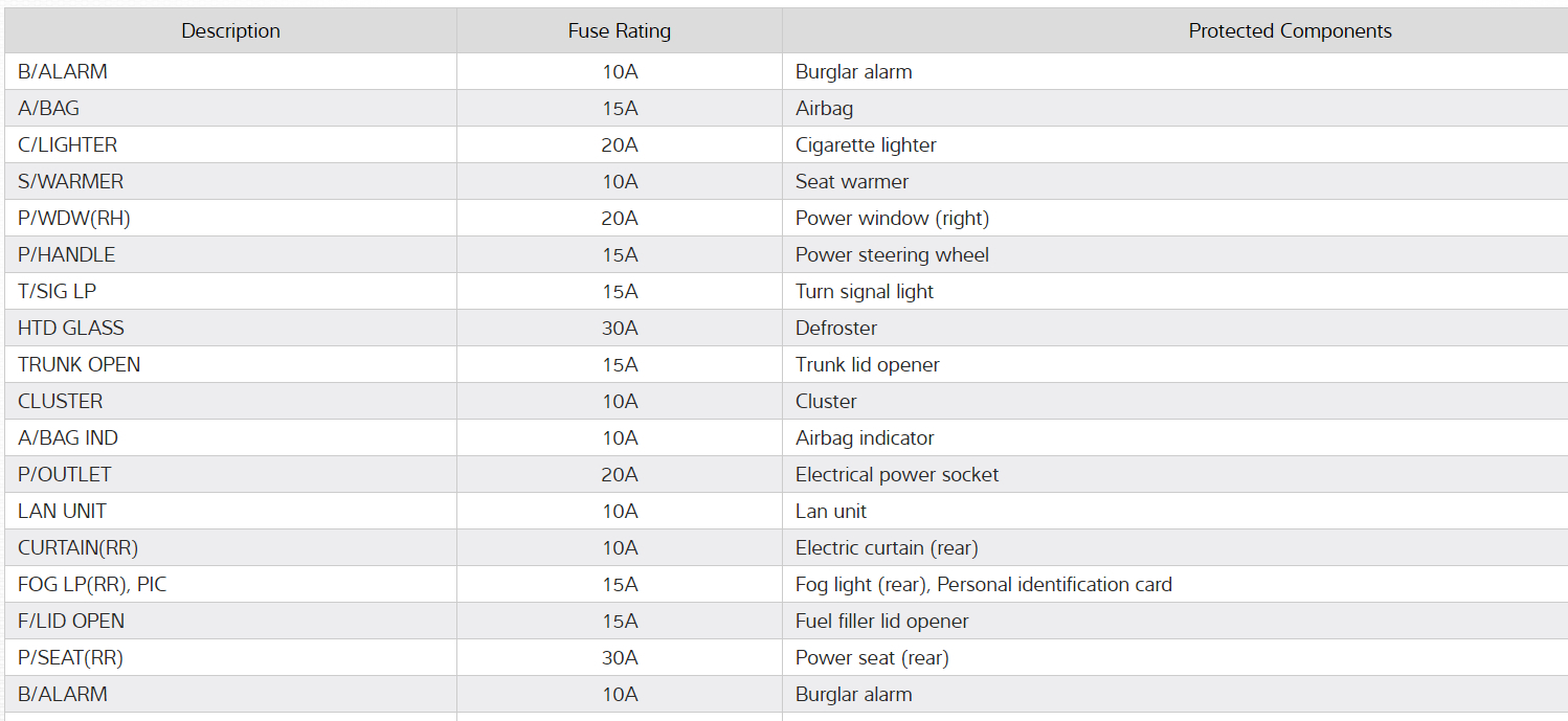

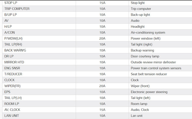

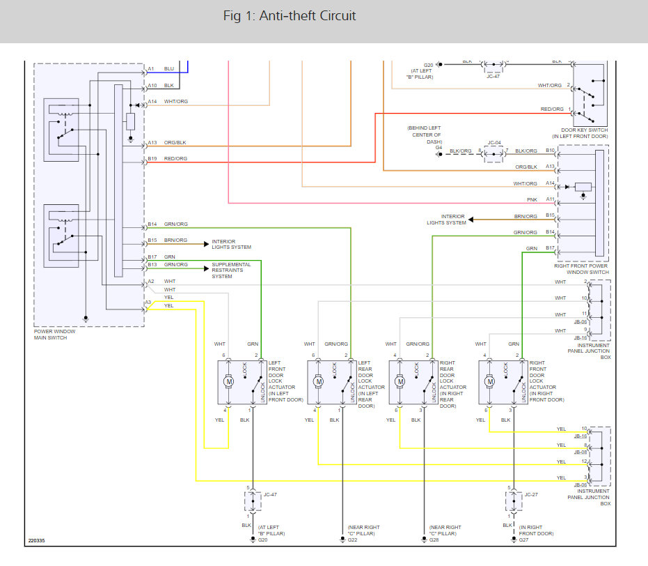

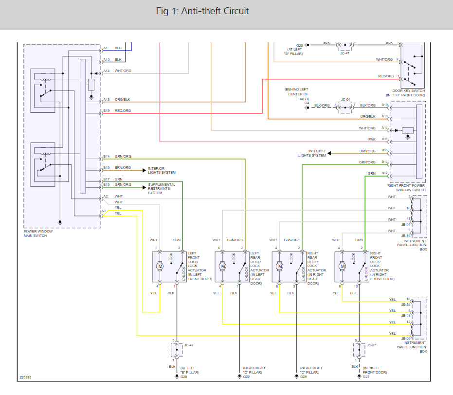

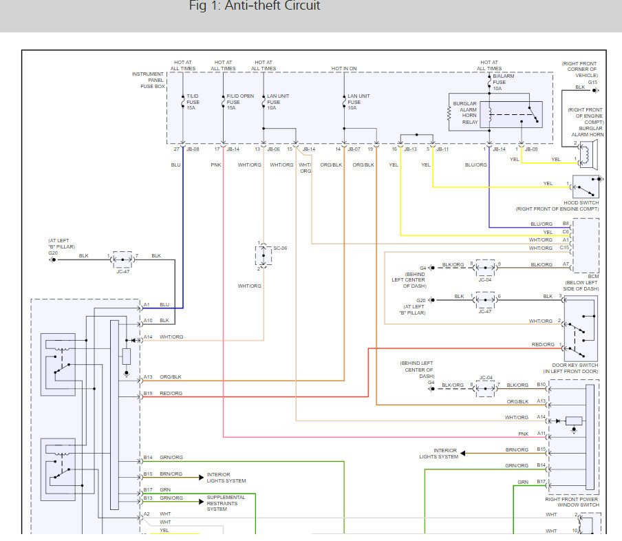

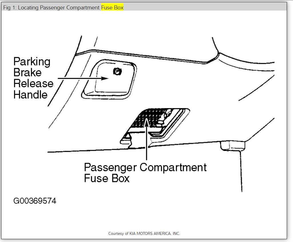

There are fuses in the interior fuse panel we should check. here is a guide to help and the security system wiring diagrams so you can see how the system works and which fuses to check. here is a guide to help as well:
Check out the diagrams (below). Please let us know what you find.
