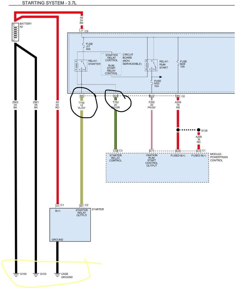

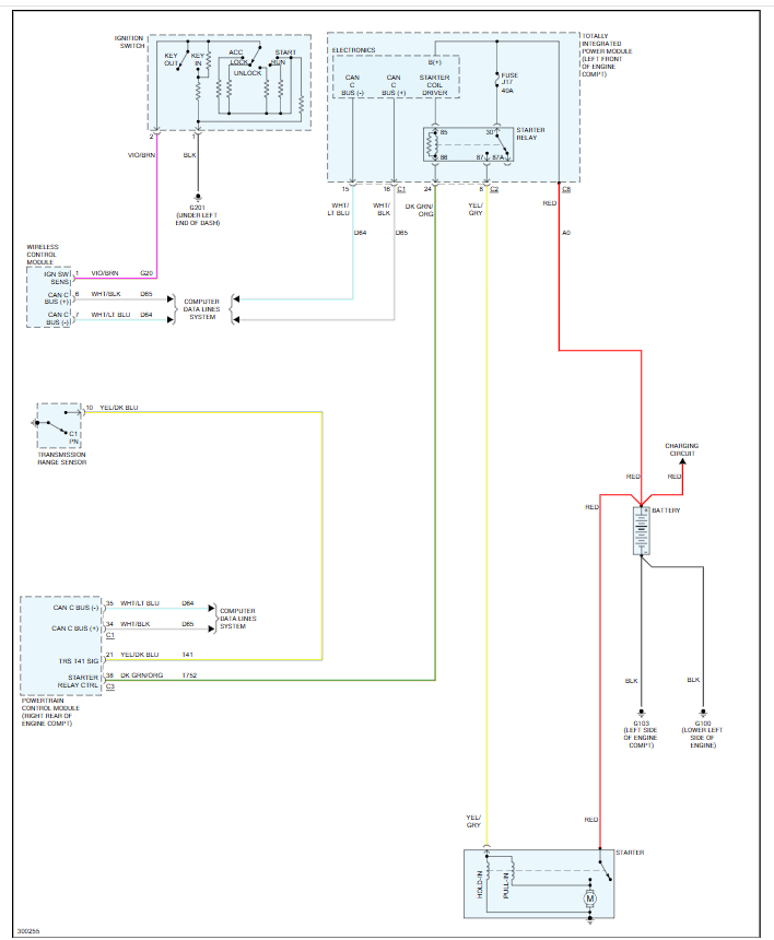

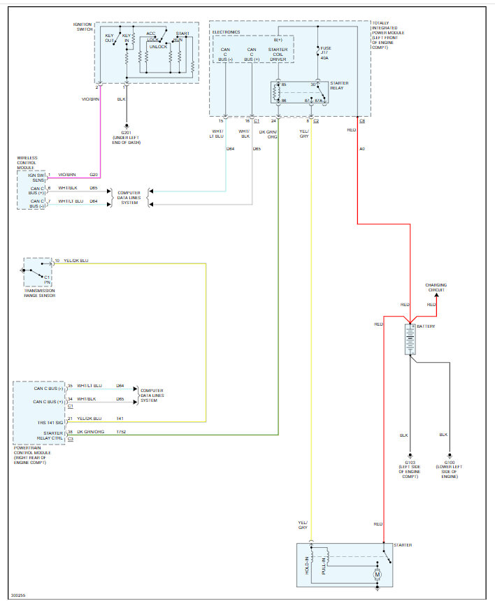

So is the security light flashing? If not the alarm is disabled. I would try grounding the yel/drblu wire and the transmission range sensor. Here is the wiring diagrams so you can see how the system works. Please go over this video as well.

The SKIM won't stop the engine from cranking, it disables the fuel system. It will allow it to start and run until it uses up the fuel from the initial prime. The FOBs only operate the locks and alarm and arm disarm the alarm, but they are not needed to start the engine, it is the key that the SKIM reads. It sounds more like an issue with the electronics that control the engine. What year did the short block come from? They are not interchangeable across all years or across the brands it was used in. However that won't stop the starter from turning. What do you have scan tool wise? It can be used to watch the systems as the starter is activated. So if it shows "starter energized" but it isn't turning then the TIPM is being triggered and the issue is between it and the starter. Find the Dark Green with Orange wire in the PCM pin C38 (connector C pin 38) and see if it is grounding when the key is turned to start. That is the signal that triggers the relay. If it is grounding, then look at the Yellow with Gray wire on the starter motor, that is the starter engage signal. It goes hot if the relay is operational.

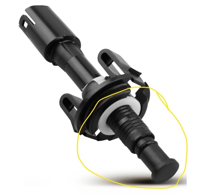

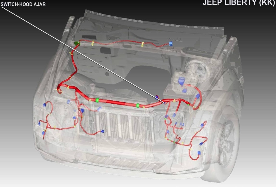

OK, it sounds like you also have the additional anti-theft option that secures contents. Open the hood and see if the hood switch is bent or damaged. That could be the reason for the constant alarm. The circled part is what will be sticking up under the hood on the core support above the left headlight.

There is no hood switch.

No hood switch suggests it doesn't have the OE contents alarm system. Could you take a picture of the fob you have? An aftermarket system could cause the issues you have.
