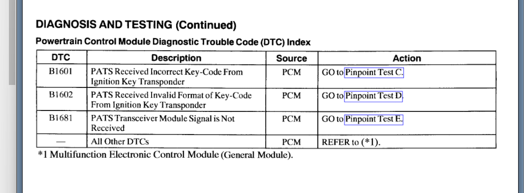

This means there is an active theft event. So, we need to start with scanning for codes and finding out what is there.
Here is a guide that will help with this:
More than likely this is not an issue with a theft module, but we need to pull codes to start the process.
https://www.2carpros.com/articles/how-to-reset-a-security-system

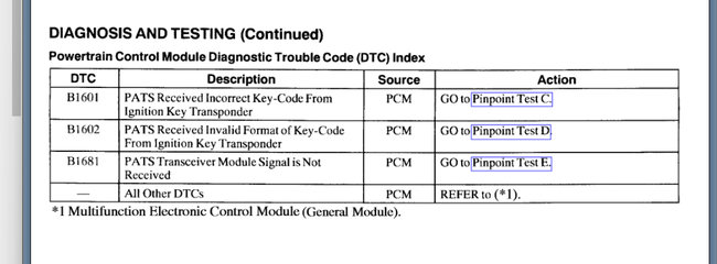

The common codes are below but we need to know which one or others to find out why this is active.
Take a look at this info and let us know what you find. Thanks

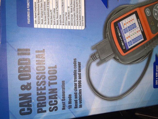

I'm sending you a pic of my OBD11 Professional Scan Tool to make sure it's good enough to get the codes I'm looking for.
I don't have electric door locks and I don't have a key fob I've tried the battery disconnect; I've tried the fuses, but I haven't tried the fuses under the hood. I'm going to the library to update my scan tool with the disc I've had it for quite some time, but I never have updated it, yet it wouldn't connect/communicate with my truck. so, I hope an update will fix that problem. I don't know much about these scan tools at all, but I know enough where I'm sure I can figure it out. thanks for your advice. I'll let you know when I find out.

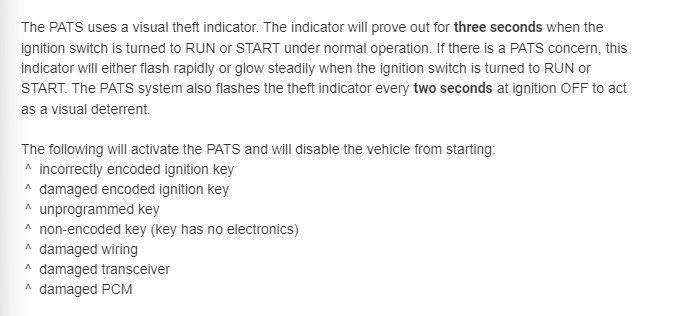

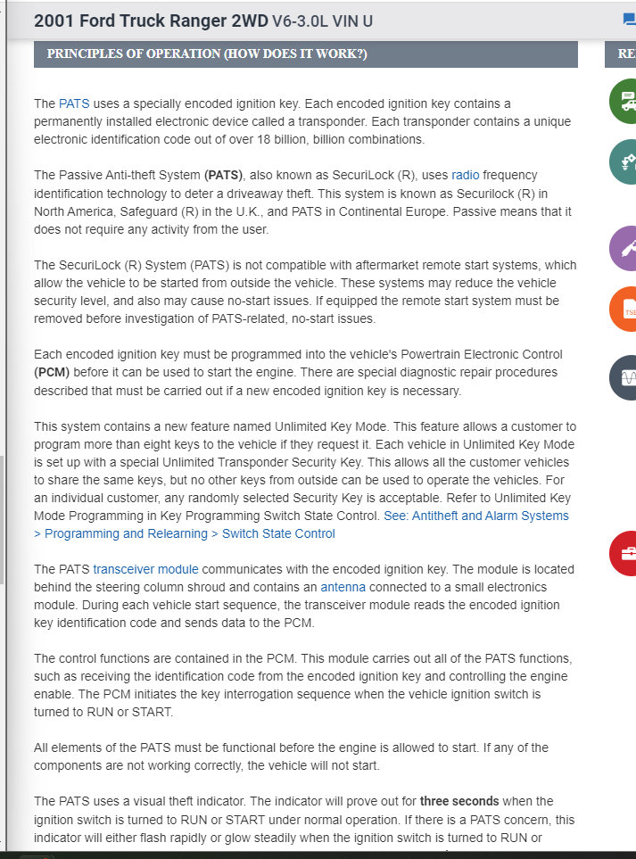

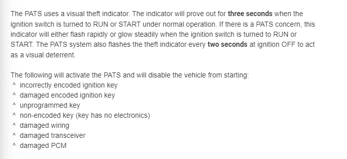

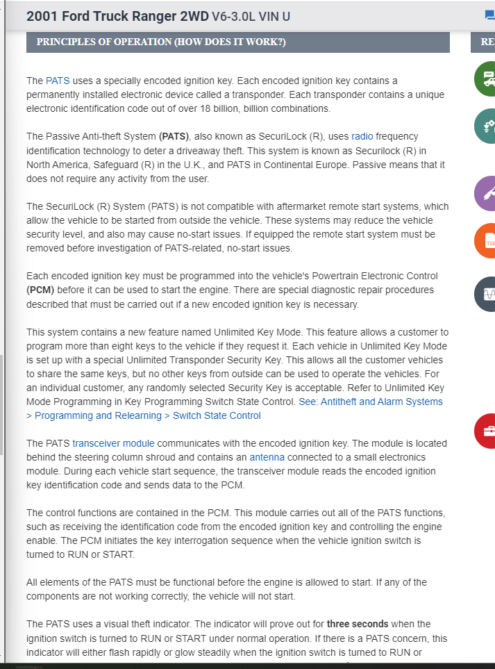

When you say you don't have a key fob, I assume you mean the remote keyless entry device. Meaning the control device that lock, unlocks, alarm, and remote start if equipped?
This is separate from the PATS system that has a chip in the key and is needed in order for the PCM to start the engine.
I am attaching the info below on the detail on this system. It includes the possible causes of any issues that would prevent the engine from starting.
Yes. that scan tool should be able to pull these codes as they are in the body control module and would be pulled by most all tools.
If it doesn't communicate with the vehicle then that is either an issue with the tool or another issue with the vehicle.

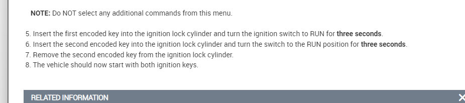

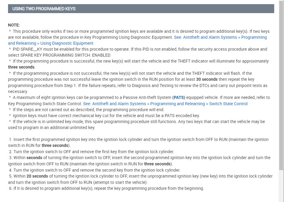

Okay. A slowly blinking theft system is just an active system but not disabling the ignition. Basically, it is just waiting for the correct key to be inserted.
So, if you now have keys ready to program there are two ways to do this. First is if you have 2 keys already programmed and that operate the vehicle. This is basically just adding another key to the system. I am attaching that process below and it does not require a scan tool.

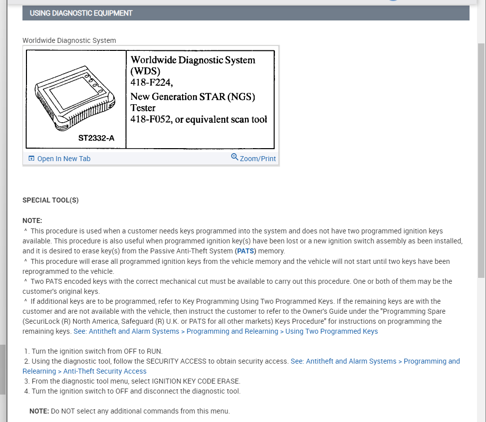

However, I suspect you are trying to program a key without 2 known good keys. For that you require a scan tool capable of programming keys. If your tool does not do this, then I would call a lock smith as they will do this pretty cheap and come to you, so you don't have to tow the vehicle.
Nov 8, 2021 at 9:37 AM

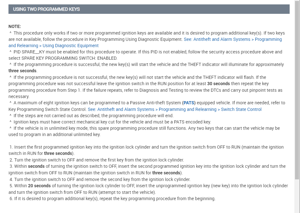

Okay, I can see I need to follow instructions from the third photo you sent. thank you. I'm now going to see if it works.
Nov 11, 2021 at 5:33 AM

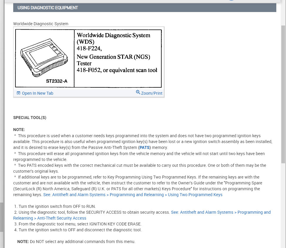

Okay. If you only have the 2 keys that are no longer working, then you are going to have to have 2 new keys programmed as you stated. I would suggest sourcing a lock smith that can program these as they will come to you.
Let us know how it turns out. Thanks

Correct. In order to do the self-program method, you have to have two functioning keys and then you can add a third. Then if you have any keys that are no longer working, you cannot reprogram them again. Once they are programmed, they cannot be programmed again to this vehicle or another. However, in theory if you have a working key, you would have no reason to reprogram it so that point is moot.
So, if your keys are not working and you need to program new ones, you need a scan tool capable of unlocking the theft system so that it knows it is not just some thief trying to program a new key and steal the vehicle.
