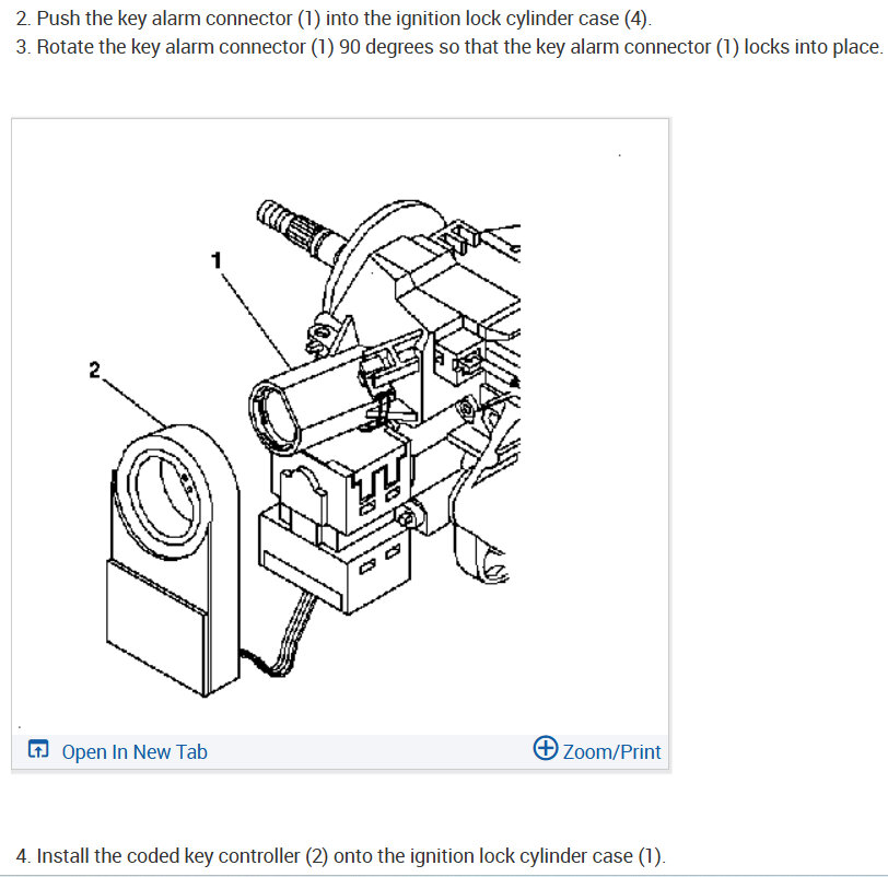

My ex-girlfriend stole my key to my car and in order for me to get the car out of her driveway I had to crack the ignition and when I did the anti-theft lock came on and now idk how I'm going to bypass the anti-theft lock even if I buy a new key I can't stick it in the ignition. Will it still have the anti-theft lock on it if I buy a new ignition?
Nov 14, 2024 at 12:35 AM
  • 55,443 POSTS

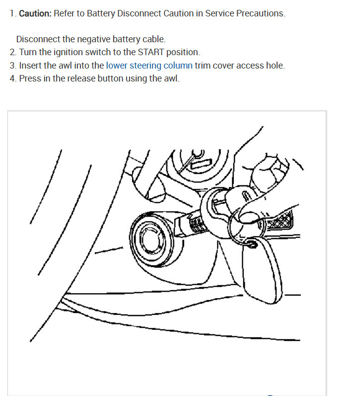

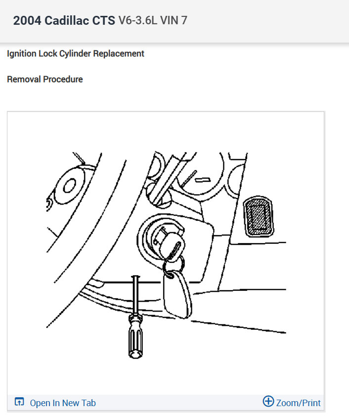

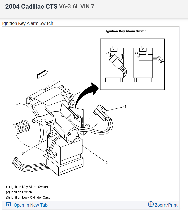

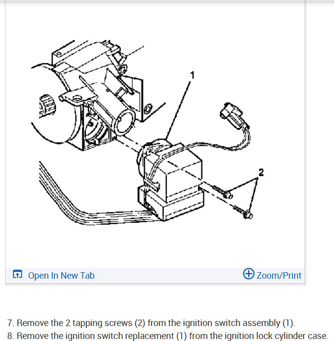

I am sorry to hear about your troubles, you can't bypass the security system. You will need to replace the lock and key and then do a relearning procedure. Here is how the job is done, if the column is too badly damaged, I would get a used one by searching eBay, if you upload images, I can help you decide.
