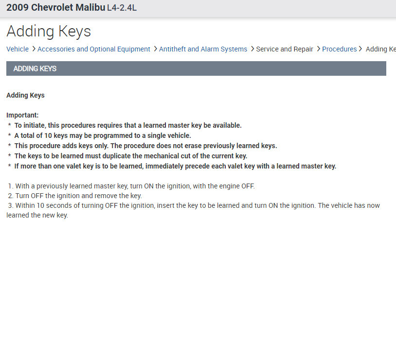

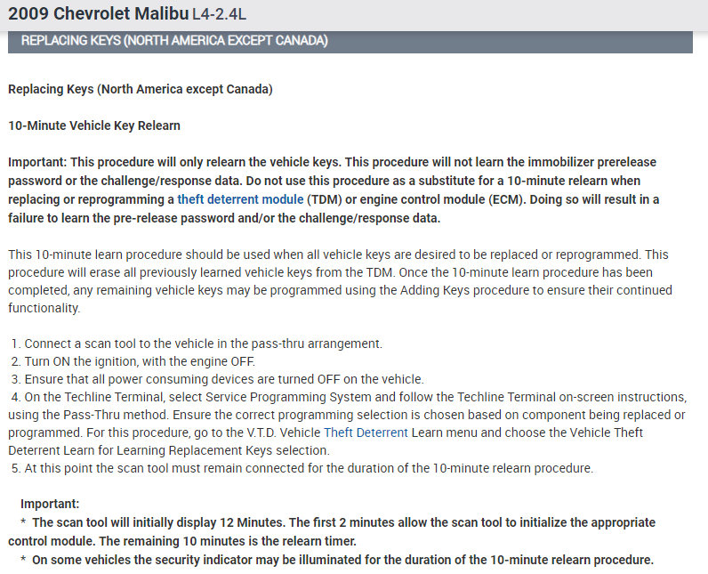

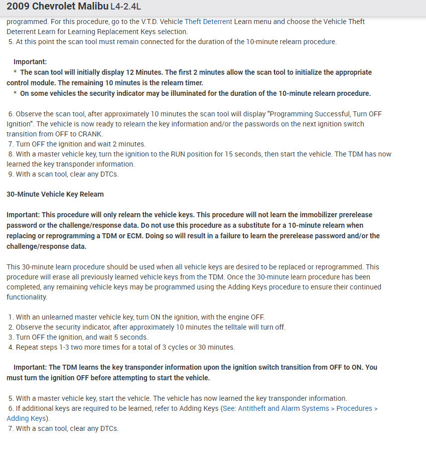

I'm trying to reprogram a pass lll key, but when I turn the ignition to the on position my anti theft light stays on .I've waited well beyond 10 minutes and it never shuts off!
Sep 16, 2021 at 10:46 AM
SQM
  • 6,383 POSTS
Do you have a functioning master key?
If so adding additional key is fairly straight forward.
Adding Keys
First with you existing master key, turn On the ignition (do not start).
Then turn off the ignition and remove key.
After that within 10 seconds of turning off the ignition, insert the key to be learned and turn on the ignition.
That will complete the process of adding a key (you can add up to 10)
