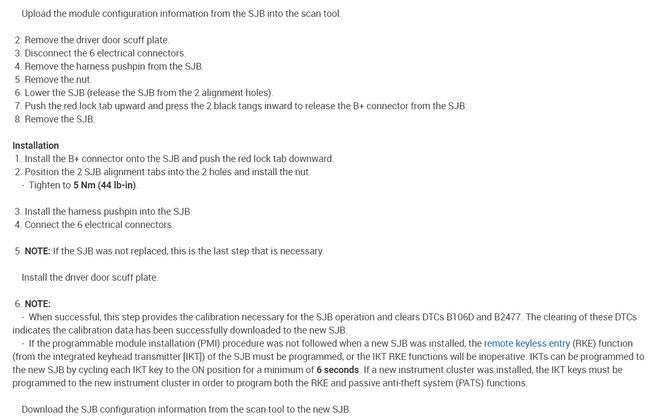

We need to know the code; I would do a CAN scan which will tell us what's going on. You can get a CAN scanner (Controller Area Network) which will work on most cars from Amazon.
https://youtu.be/u-4syLc-ifQ

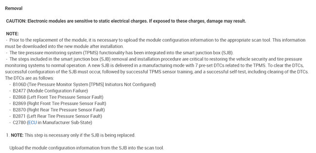

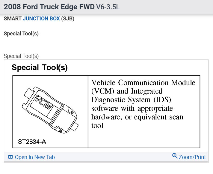

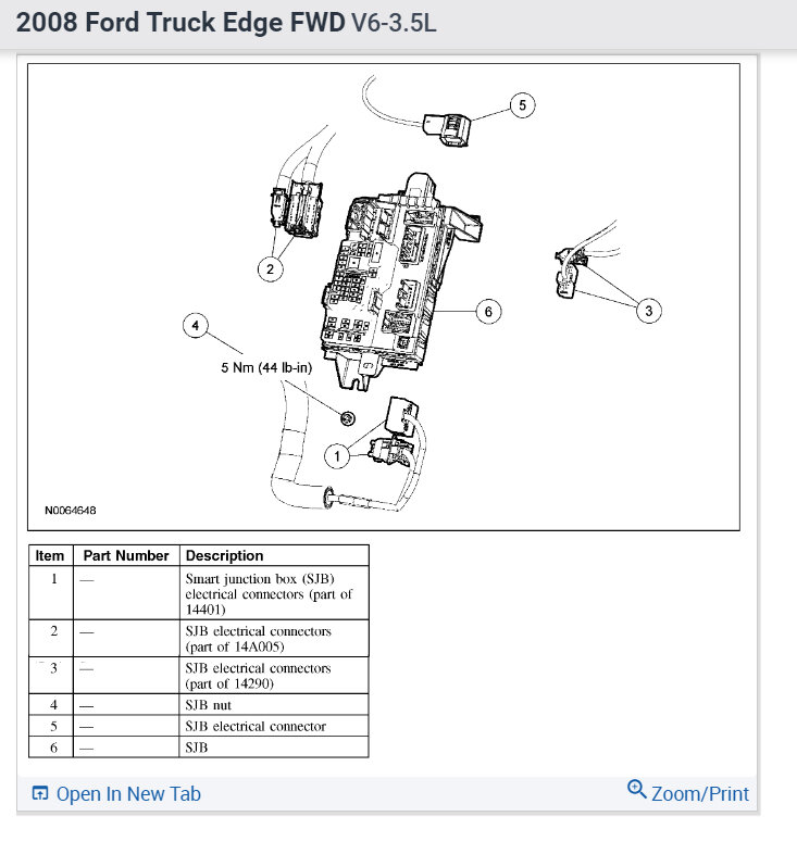

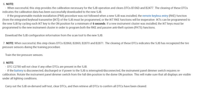

It sounds like the SJB is out which is common, here is how to replace it in case a code comes up for it. Check out the images (below). Please let us know what happens.
