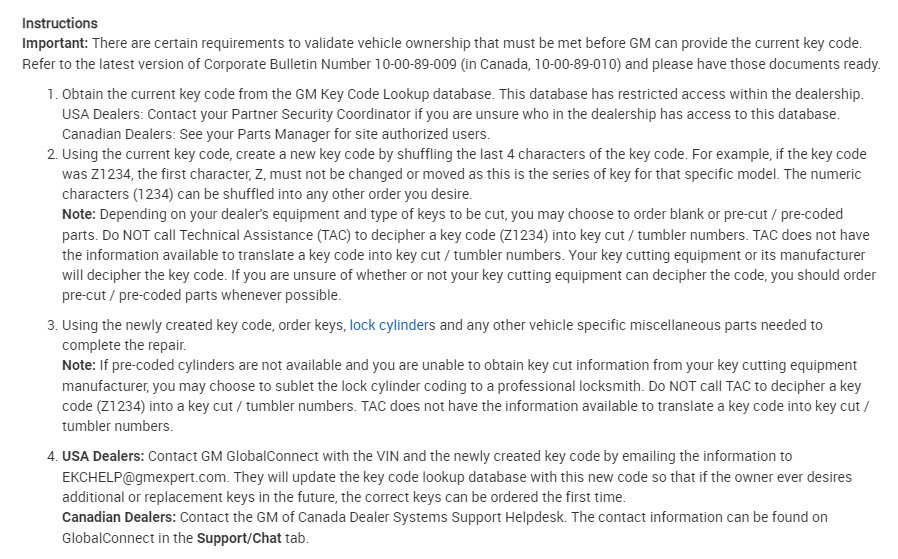

Without a key, it needs to go to a dealer that can get information from a GM database. I attached the directions below, so you know what needs to be done.
Try the key a few more times. Also, when you turn the key to the "run" position, does the light turn off after about 10 minutes?
See pic below.
