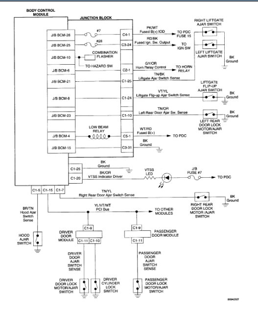

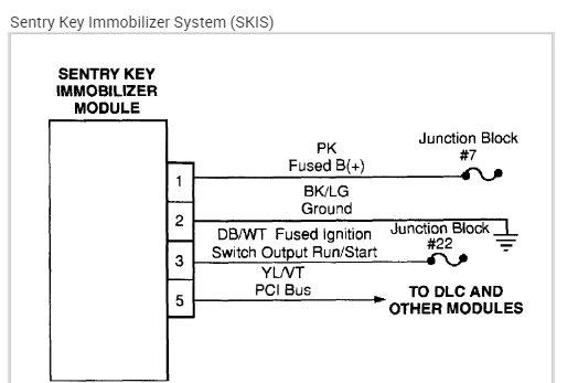

I bought this vehicle with this problem, so I went through all the reset procedures,didn't work. i think it has to many sensors giving a signal at once, so I want to exactly where the anti theft module is located,either on the vehicle or in the PCM,or BCM. Also if I could get a copy of the complete schematics of both.
Thank you,
Jeff

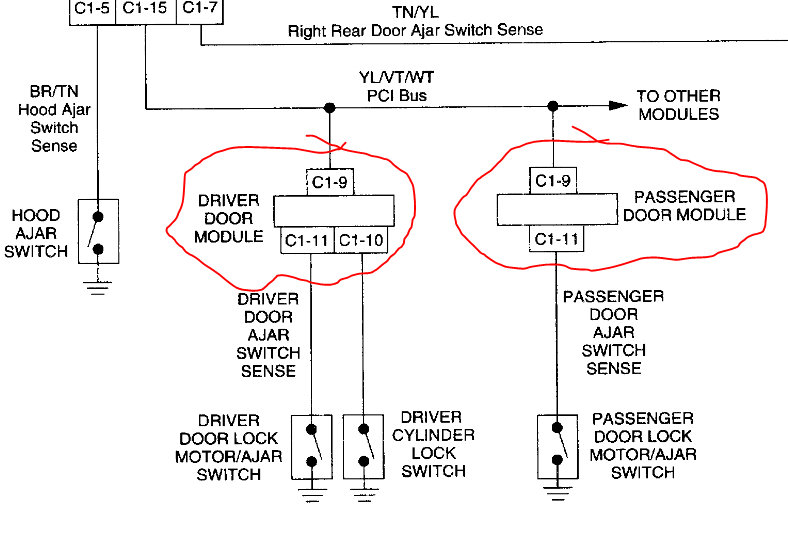

The information for anti-theft goes through the BCM. There are two door modules you should check first for this reason. Here is a tutorial showing you how to check wiring:
If there is the slightest voltage drop in either of these modules the vehicle will think it's being stolen/broke into. I've attached pictures/diagram below (circled in red the door modules).It will give false readings to the BCM. Hope this helps and feel free to ask any questions.Thanks for using 2CarPros.
