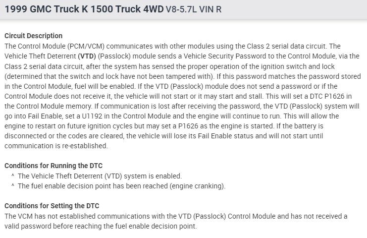

Will not start, code P1626
1999 GMC TRUCK
126,000 MILES • 5.7L • V8 • 4WD • AUTOMATIC
PIRATESVEN
Scan tool identifies anti theft fuel enable circuit code P1626. Truck sat with a dead battery 6 months or so. Will crank and run for only a few seconds. I've tried doing the ten minutes on/10 seconds off. Disconnected negative cable from the battery. Pulled security fuse. Locked/unlocked driver's door with key. Security light will not go off and still won't start.

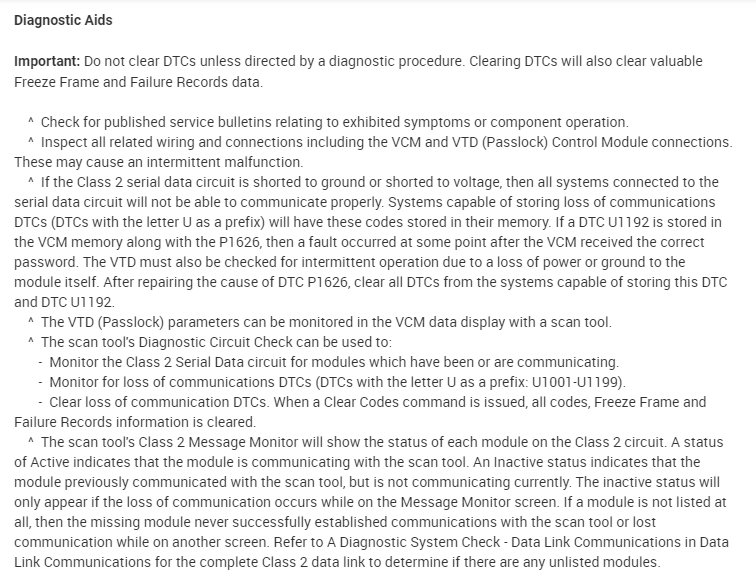

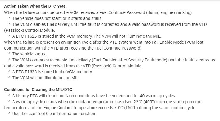

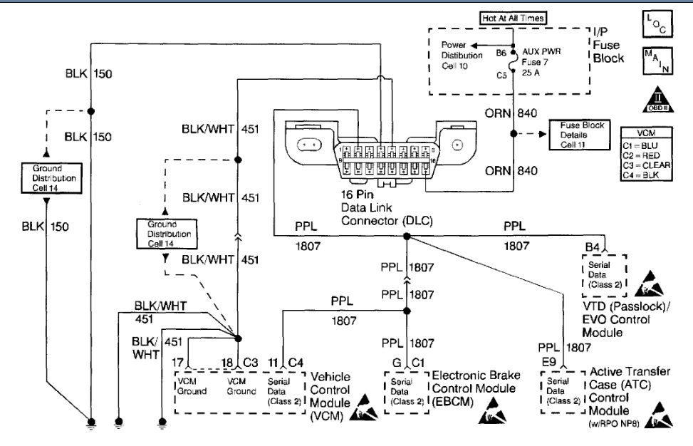

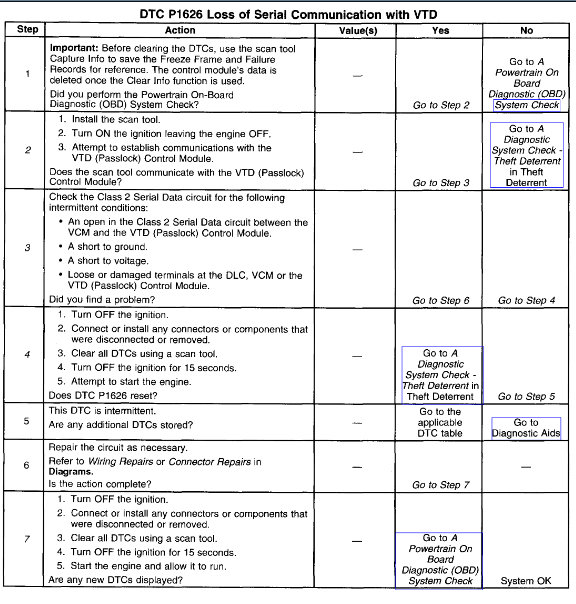

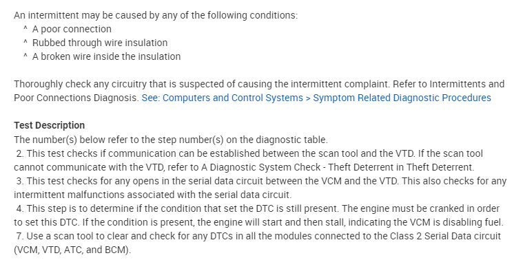

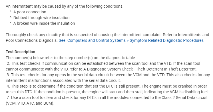

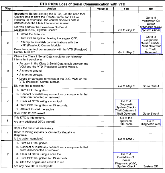

Here is a tutorial showing how to reset the anti-theft/security system.We'll try this first.After reading scroll the page to find GMC specifics.
https://www.2carpros.com/articles/how-to-reset-a-security-system
If this doesn't work I've also attached step-by-step testing pictures related to the P1626 code.I will required a GM Tech 2 scan tool. Hope this helps and thanks for using 2CarPros.
