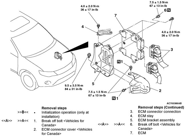

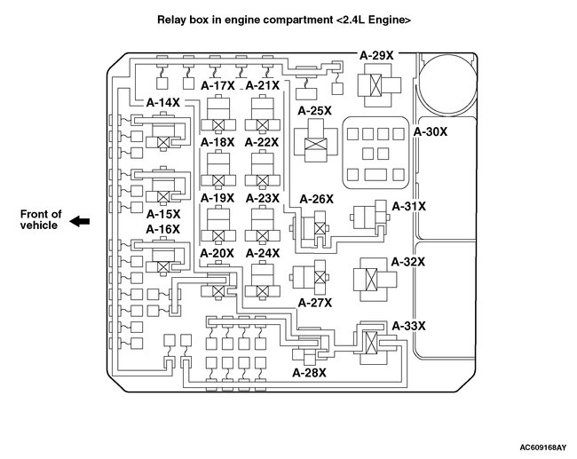

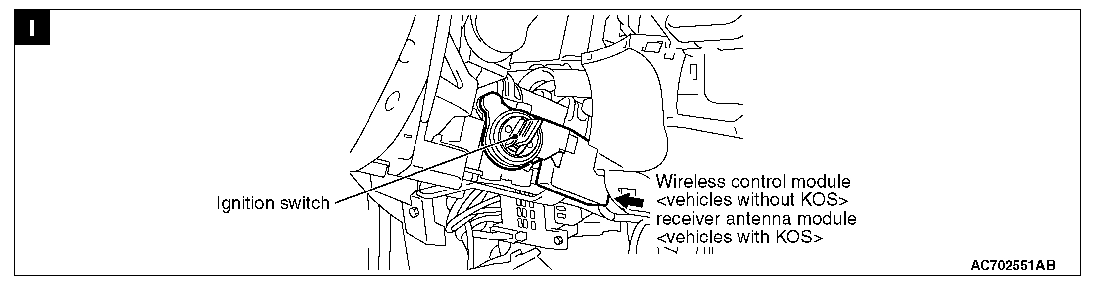

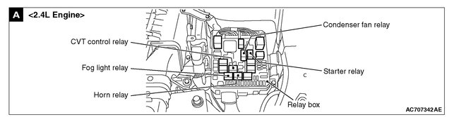

Looking for the horn relay, starter relay and PCM/BCM/immobilizer. Thank you
Oct 13, 2018 at 3:22 PM
  • 110,241 POSTS

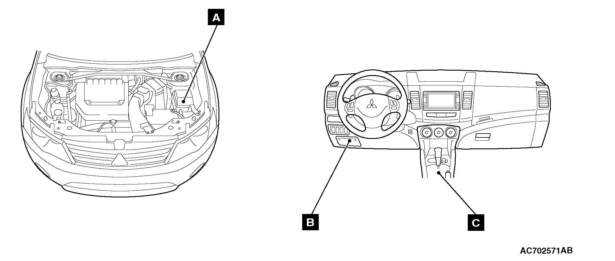

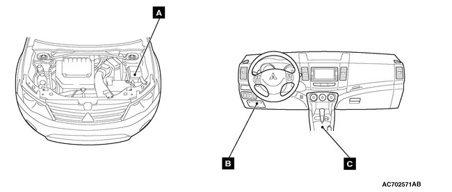

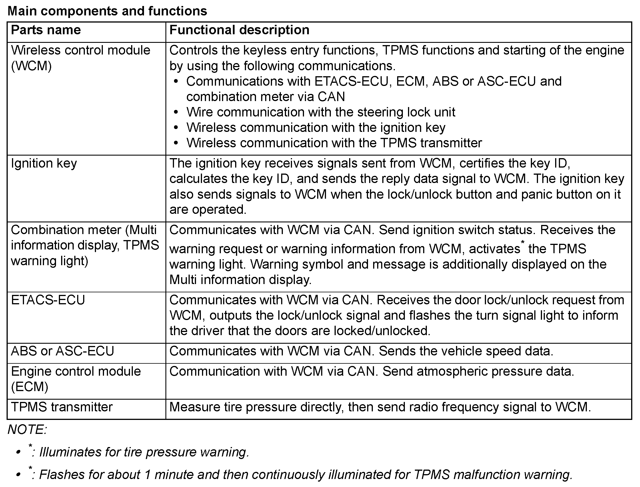

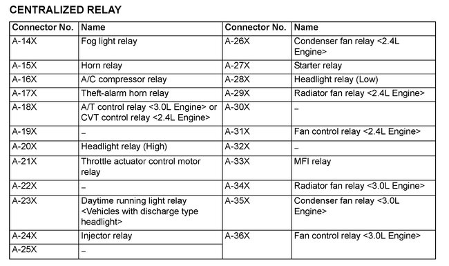

Picture 1 shows where the relay box us located (letter A). Picture 2 shows the locations of the horn and starter relays in the box. Picture 3 shows the body control module /ECU location. The next two pictures (4-5) are the wiring schematic for the immobilizer circuit. Picture 6 defines the roles of the major components. Picture 7 shows the system's configuration and picture 8 shows the location of the wireless control module (WCM).

I have to ask, why do you feel the anti theft is the issue? If the light is going off, it sounds like it is working correctly. Have you checked to see if there is both spark and fuel to the engine?
Here are links that show how to check both:
To answer your question, the fob battery or WCM should not cause a no start. However, the immobilizer can, but since the light goes out, it does not sound like the problem.

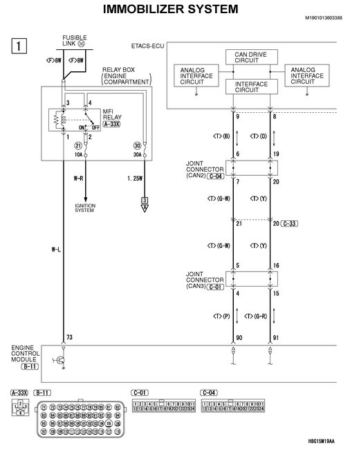

Something is not right which will you choose to go first between the WCM, ignition switch, and immobilizer? Joe, keep me going I will nail this one and comeback with the answer.
Oct 16, 2018 at 2:20 PM
  • 110,241 POSTS

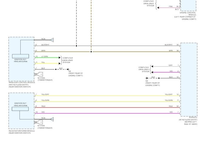

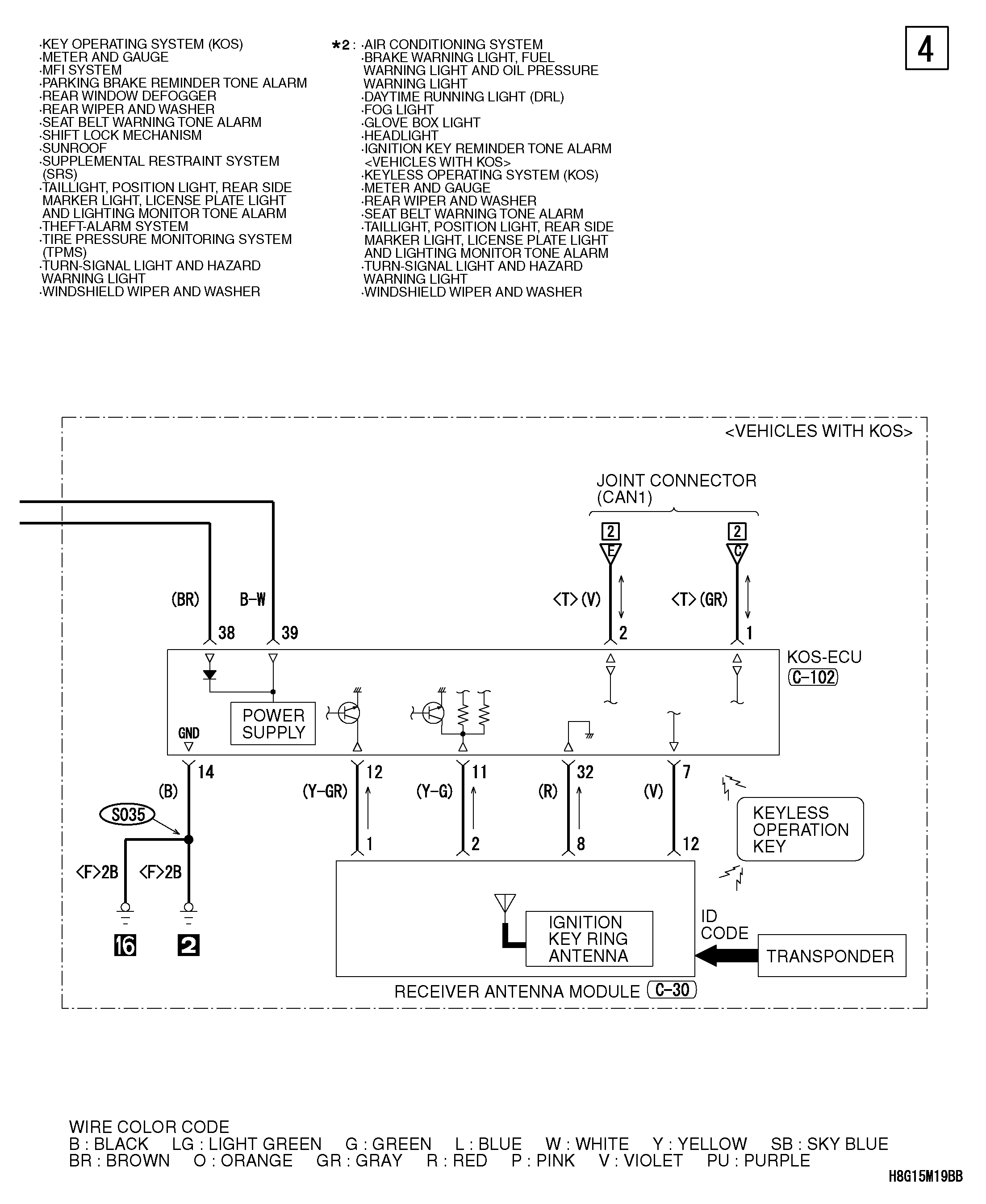

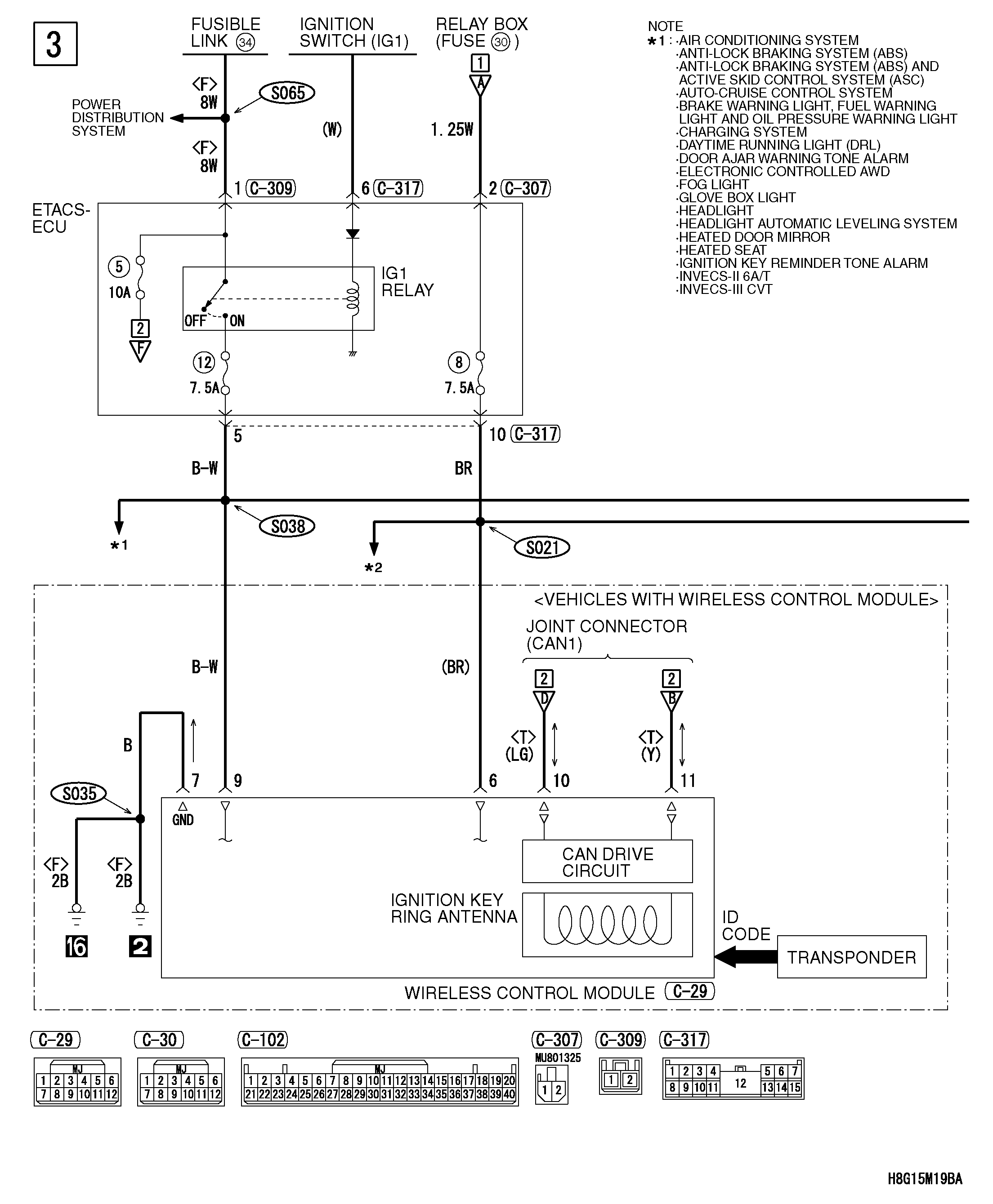

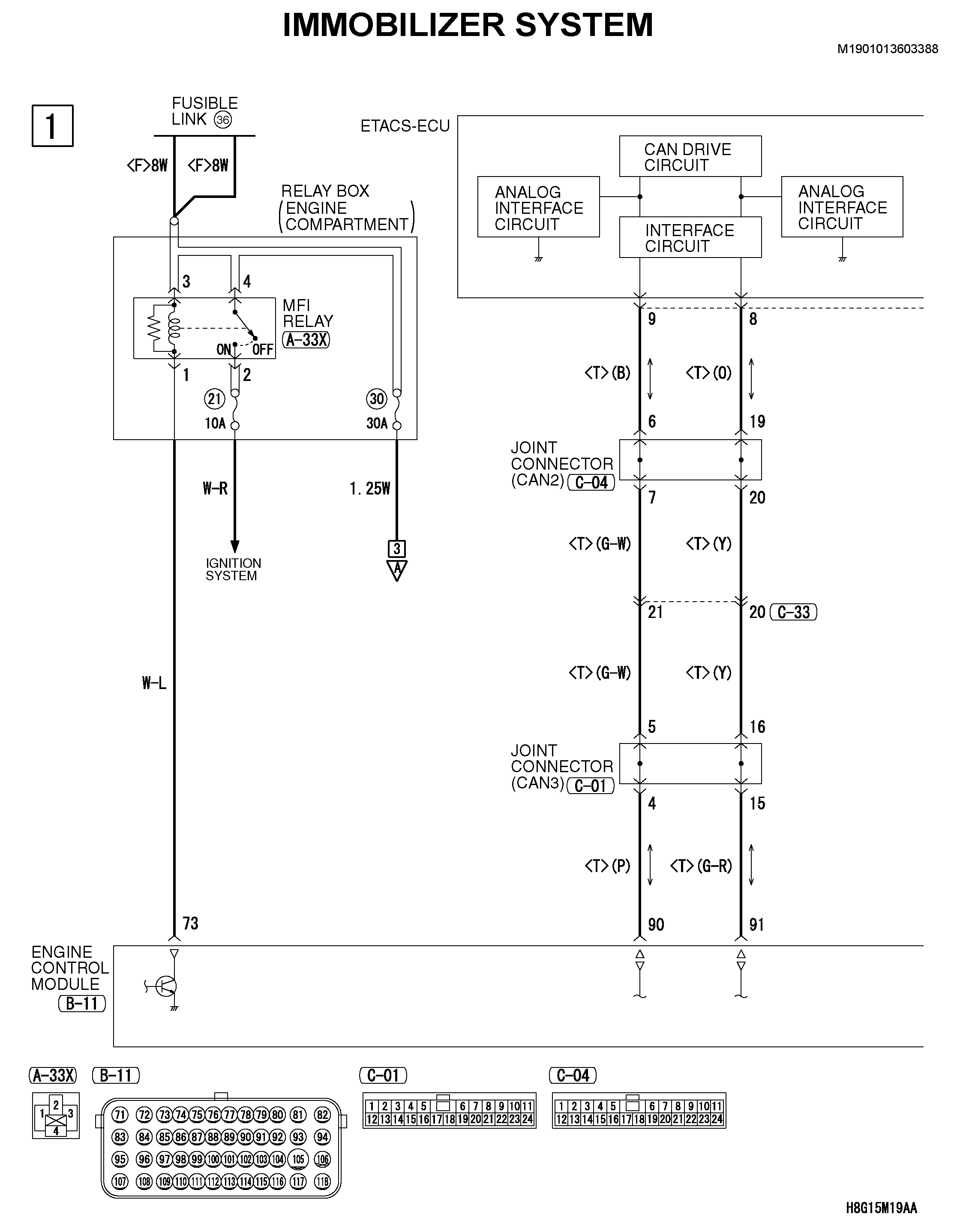

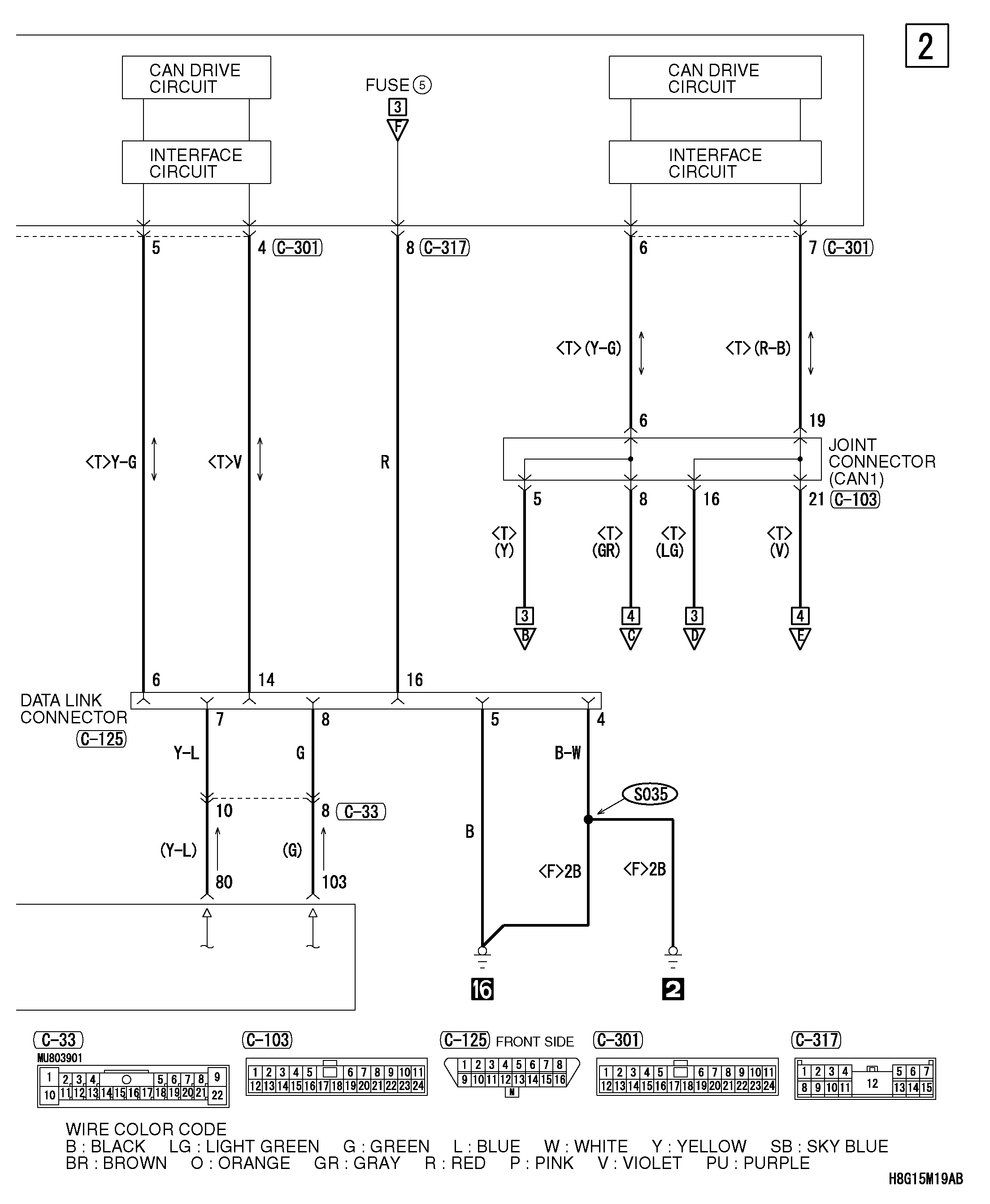

The FOB is recognized by the WCM. I attached all the schematics for the immobilizer system. Let me know if anything there is helpful. This could be a simple grounding issue.
Oct 17, 2018 at 9:34 AM
CATAFINA
  • 98 POSTS

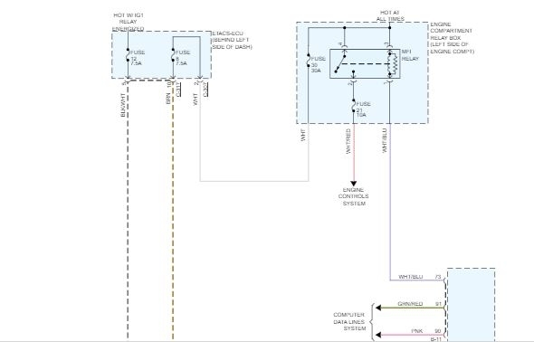

Joe, can you point me to grounding point S-035 location/where I will start there and the MFI and Ignition relay? If you do not mind? Thank you it is very helpful.
Oct 17, 2018 at 10:35 AM
  • 110,241 POSTS
Not a problem. See attached picture 1 for under hood relay box orientation.
Relay A27X is the starter relay Relay A33X is the MFI relay.
As far as the ground you asked about, that is the DLC ground. There are two, pins 4 and 5. One is solid black, the other black/white tracer. Location is front left side of center floor console. See the partial picture attached.

Joe, I can hear the fuel pump On perhaps the injection pulses is eliminate and have power to the COP-maybe I'll find power for both and see if I can start it-you think it will work

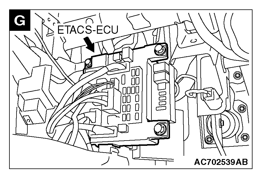

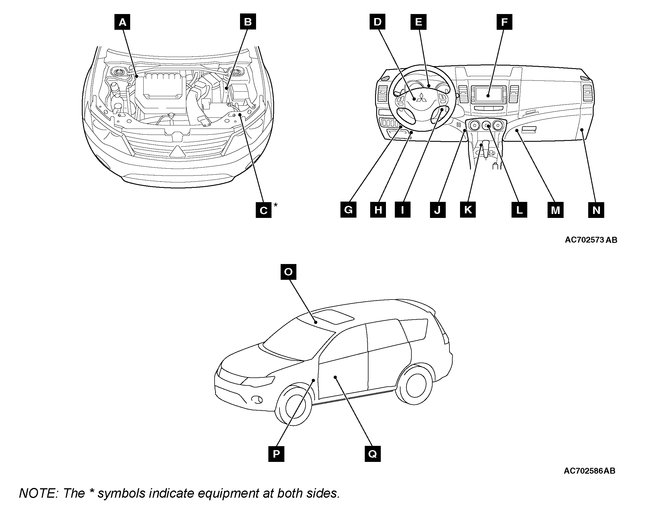

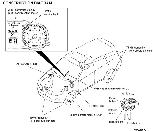

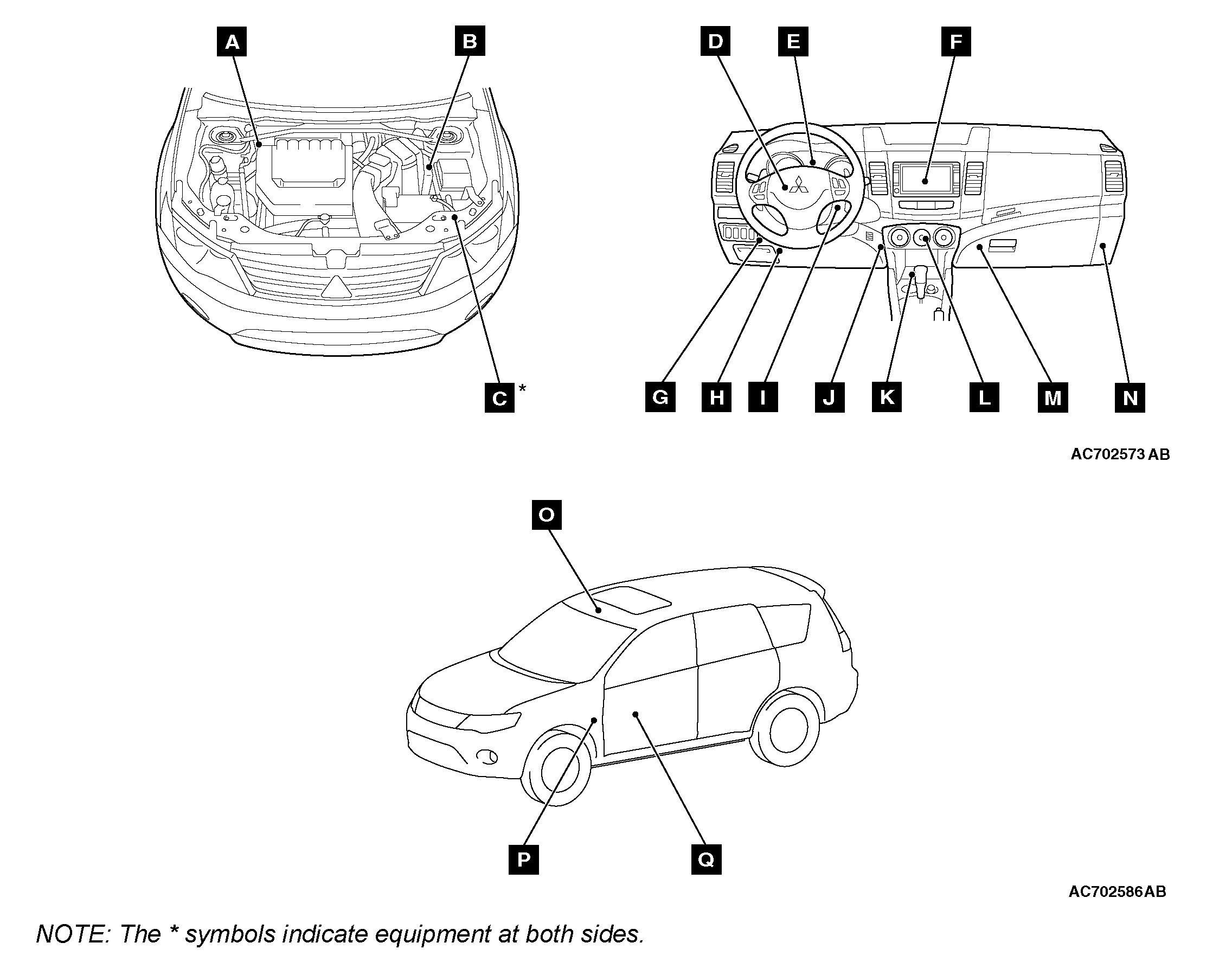

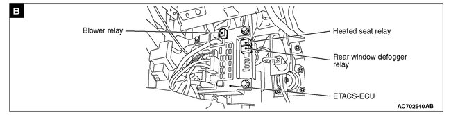

Where,s the ECU/TACS (body control module) located
Oct 18, 2018 at 11:12 AM
  • 110,241 POSTS
It is on the lower left side of the dash. See the two pictures attached. Picture 1 (locate letter G). Picture 2 shows the component.

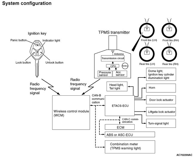

Yes, they should. If I had to guess, I have a feeling there is an issue with the ETACS. Honestly, at this point I think I would take it in and have it checked with the right equipment. Does anything with the fob work? If not, there could be an issue with the WCM.

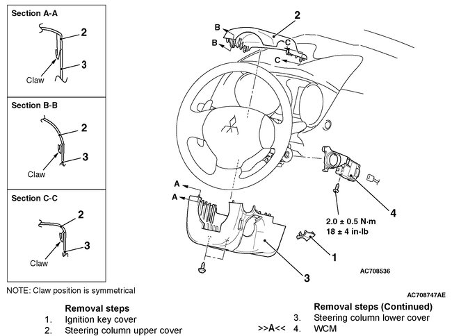

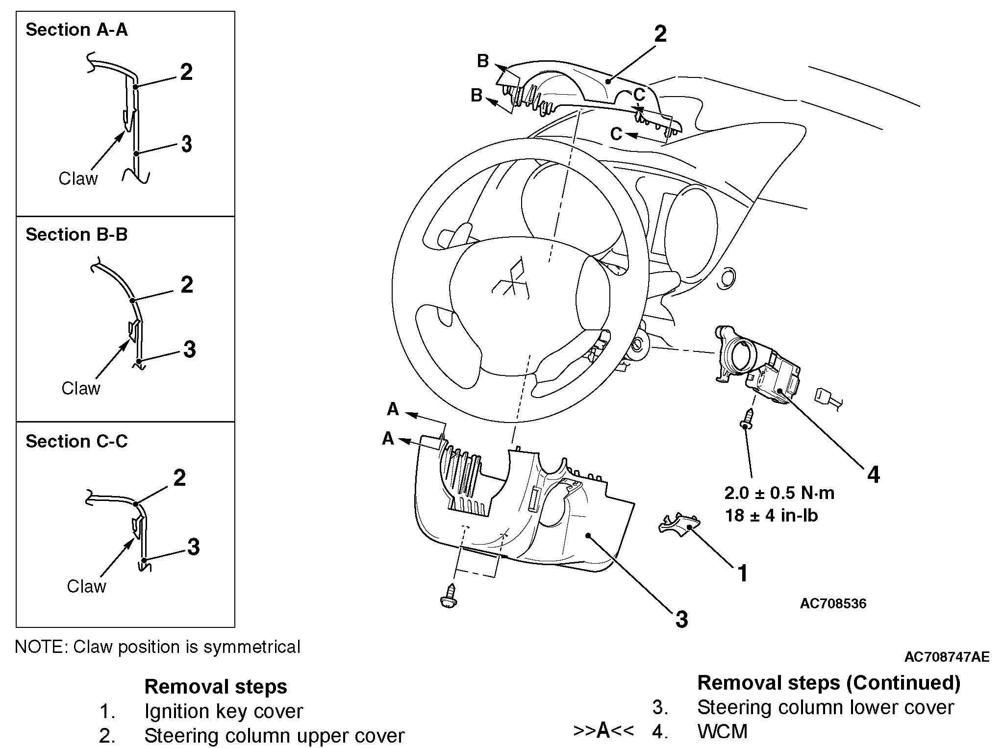

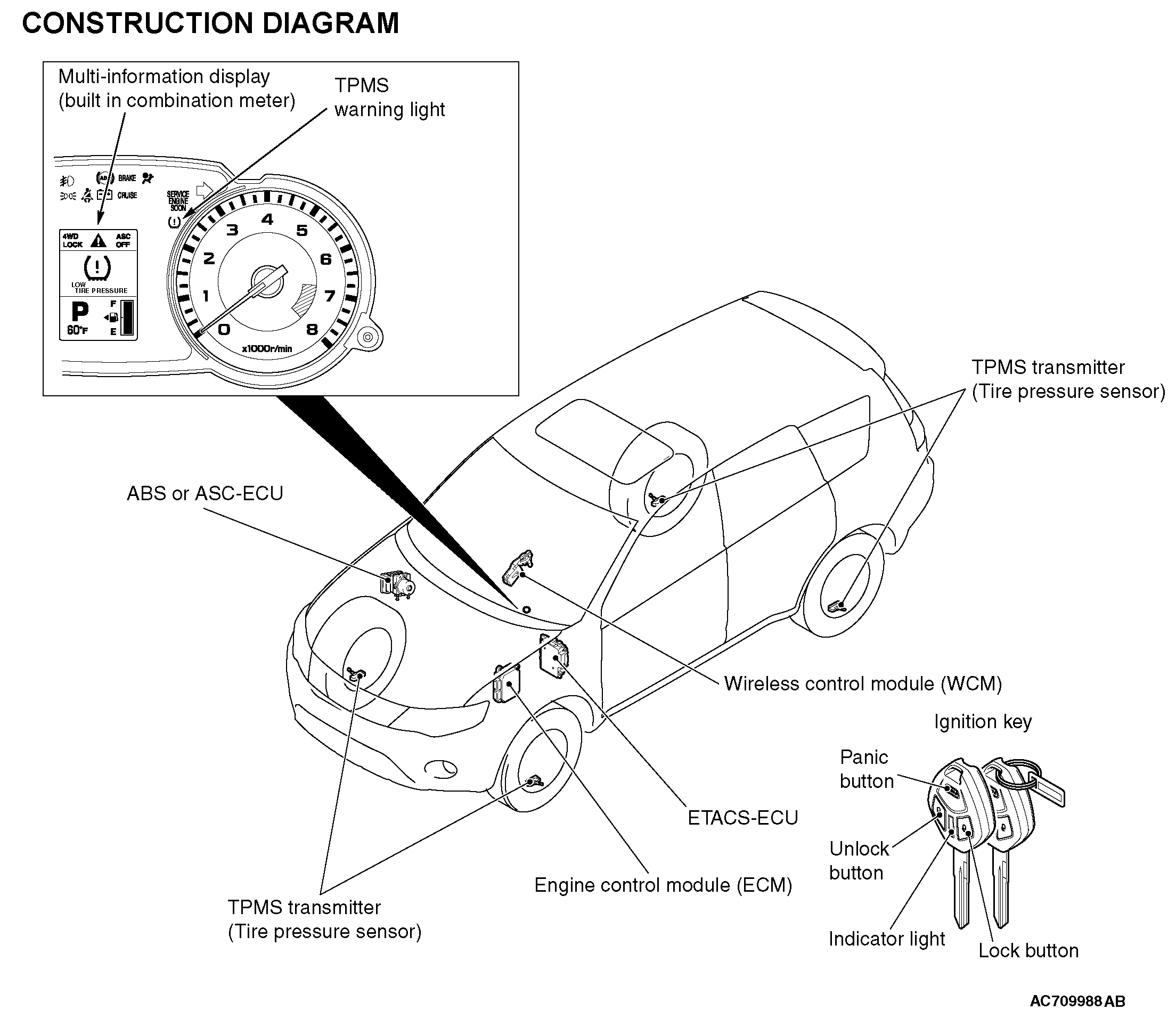

Where is the WCM located at?
Do not know if the key fob is working okay. One of them is not working and the other key I am using to troubleshoot. Both key fobs battery is been in use since the car been bought never changed. Should I start with battery first then go from there?
Oct 19, 2018 at 12:41 PM
  • 110,241 POSTS
On the dash near key. See attached pictures.

Does it have an ignition relay? Have power to injectors and coils all of them now. What part of the system pulses it the ETACS or WCM?
The key fob only lock/unlock the door-when lock the anti-theft lite comes on then blinks while lock.
Oct 20, 2018 at 9:05 AM
CATAFINA
  • 98 POSTS
Ignition relay and computer control relay Please!
Oct 20, 2018 at 11:42 AM
  • 110,241 POSTS
No ignition relay. The MFI relay is under the hood.

Anyway, I think the body control module (etacs) has failed. It doesn't happen often, but it does happen.

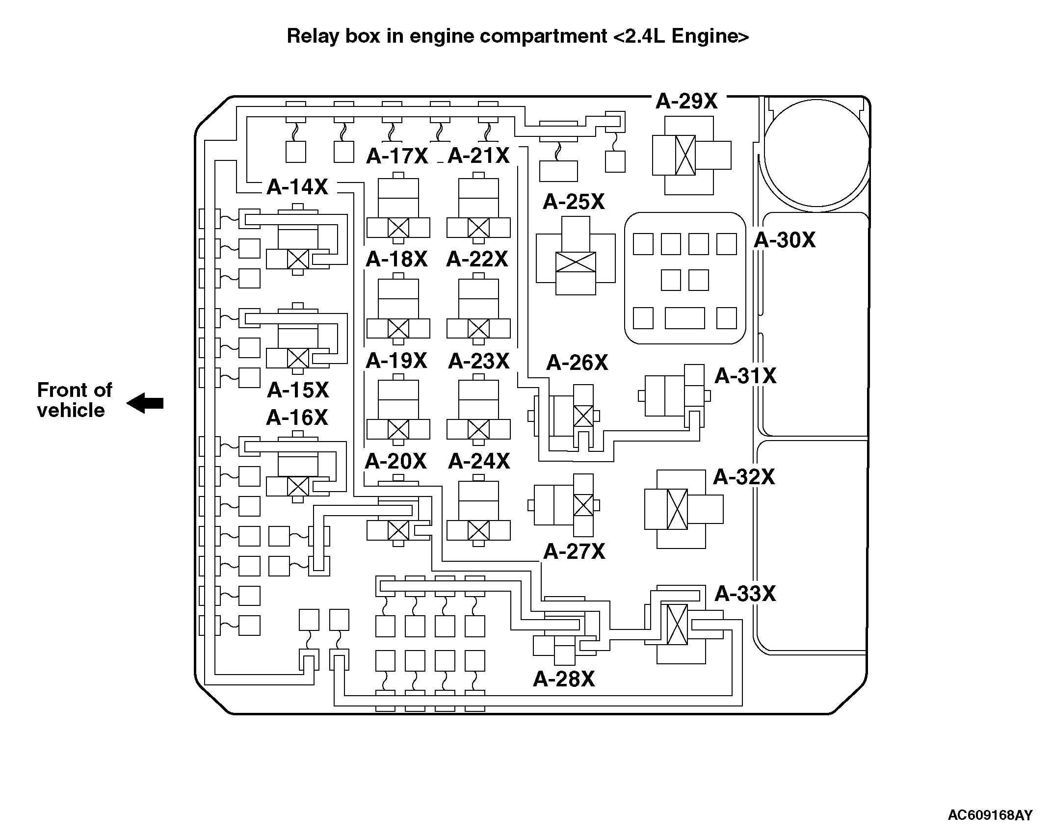

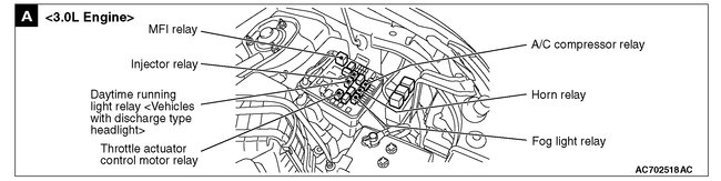

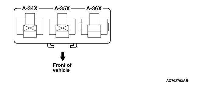

Joe. can you check again for the ignition relay 2.4 liter and where is it located. It powers the WCM and also the MFI powers the Ignition system
Oct 27, 2018 at 4:15 PM
  • 110,241 POSTS
Raz:
Here are the relays.
Oct 27, 2018 at 4:53 PM

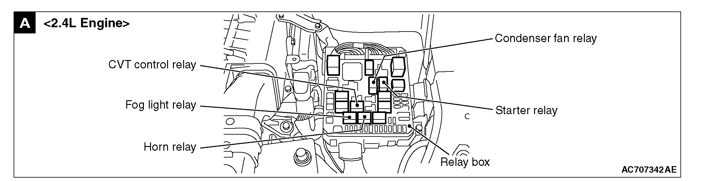

This is the engine compartment fuse/relay box-the relays boxes you given me is entirely different then what I have. After checking most of it -its pointing to the ETACS
See below-this what I have
Oct 29, 2018 at 5:58 PM
  • 110,241 POSTS
Interesting. That is not the picture I have. I have a feeling it is the module.

That is what I have physically. What modules the WCM' ETACS or the PCM am prepared to change it no matter what lets get to the bottom of this getting too long on this.
Oct 30, 2018 at 10:15 AM
  • 110,241 POSTS

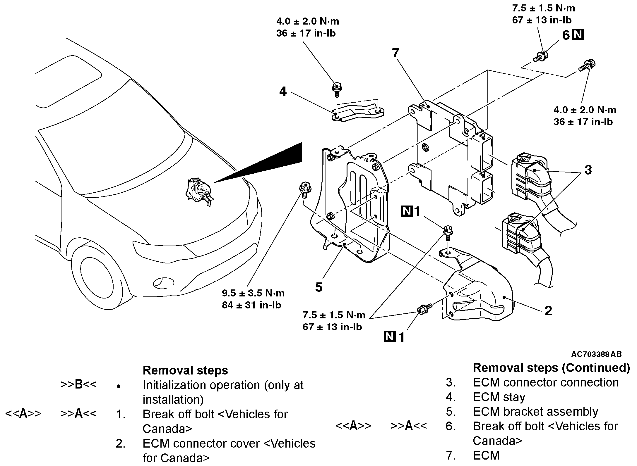

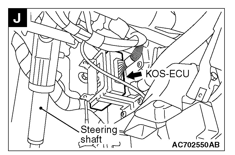

Pic 1 KOS module
Pic 2 and 3 WCM
Pic 4 and 5 ETACS / ECU
Oct 30, 2018 at 11:00 AM
CATAFINA
  • 98 POSTS
KOS module what does it really do
Oct 30, 2018 at 11:14 AM
CATAFINA
  • 98 POSTS
Looking for the KOS Module no where to be found underneath as picture describe/resemble nothing there-suppose to be there right side of steering shaft.
