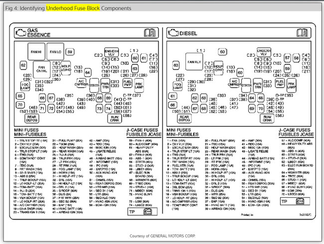

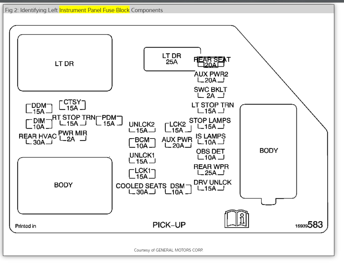

When you removed the dash did you plug back in the main electrical connectors? There are grounds wires as well that need to be hooked up so please recheck your work. Also have you checked the fuses with the key on.
