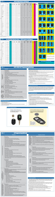

There are a few scenarios and failure points to this system, the most common being the key itself. There is both a chip and an internal battery that can fail over time just due to age and or physical damage. Here is a job aid that identifies the key style and the specific system that your truck has. You'll have to right click, then enter it to a new tab to view. Hope this helps!
