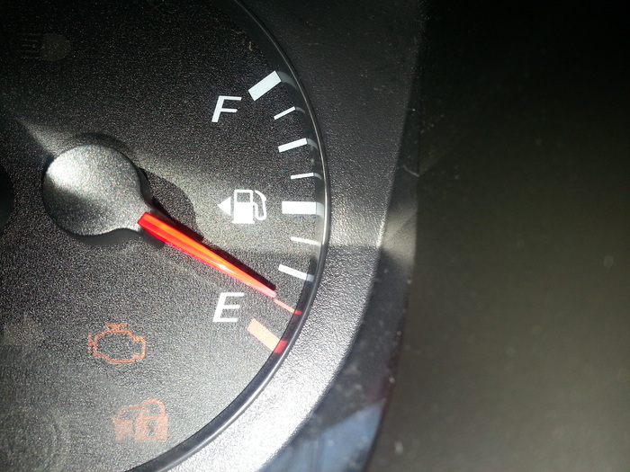

I have a 2007 chevy Impala. There is a symbol that pops up whenever I try to start the car. Ithe symbol looks likes a car with a lock on it. The car won't start but it does try to start. I read something that says it may be something with the cars security system. I really need to know what that means. I just spent 6000.00 on it yesterday.

as i stated, do you have another key??? it is a security issue and most common is the key wearing out

it is a security issue. it does not see the password and will not let it run

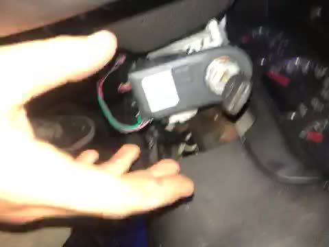

most likely will need a new ingnition swithc/tumbler assembly and the security system would have to be re set.

i reccomend dealer as they will be the ones you must secure the parts and they are the ones who will unlock the security.

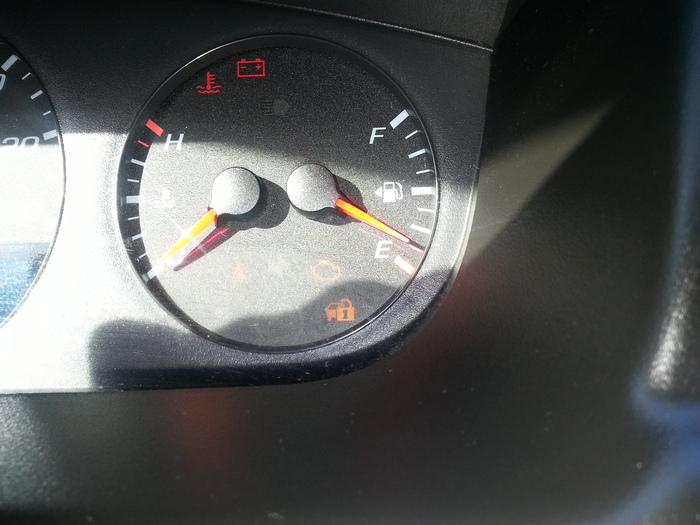

Replaced countless parts including battery starter and anti theft immobilizer module. Taken it to several mechanics. No success. One night I was able to do the 10 minute set of 3 thing and get the light to turn off each time. But my battery drained right before the third try. Replaced it with a brand new battery only for it not to work anymore. Very frustrating as I lost my job over this issue and soon my house. I am to the point I can’t afford anymore parts or work done to it. Although everything runs perfect other than the security won’t let me turn it on. Please help!

Is the security light staying on now? What happens if you allow the key to stay on for about 10 minutes. Will the light go out? I noted you are a mechanic. Do you have a scan tool that can scan the can bus system?
Mar 12, 2021 at 1:02 AM (Merged)
When this indicator is on there are normally codes that go along with it so let's start there.
Once we know the code we can take the next step but i would try and put the key in the ignition and let is sit with it in the on position for about 30 minutes and just see if the light turns off. If not, then we need the codes and go from there. Thanks

It is always been solid on since the problem came out of no where. It was going out after I replaced the anti theft immobilizer but my battery lost juice shortly after. Didn’t have a charger at the time but had a brand new battery that I swapped out with and now it won’t go out no matter how long i wait. I don't know if I’m doing something different or what. And unfortunately I do not have that tool, I’m limited on supplies and when it comes to security systems I lack a lot of knowledge. Thanks for your quick response and assistance with this frustrating issue.

So I’ve replaced anything and everything for the most part.I went through the 30 minute relearn cycle successfully twice now and when it came to the turn that was supposed to fire it up and be completely successful nothing happened, it just clicked and that’s it. so I thought well maybe a fourth time will work but now the light is not turning off again. I didn’t do anything differently since it was turning off and haven’t touched anymore parts. I’ve been working day and night on this piece of junk to no avail. Currently getting evicted over this and just really needing it fixed soon so I can at least have a car to move out with. I have no more money for tow bill or mechanical help and I’m beginning to lose hope. Crazy how something so simple could wreck such havoc on a persons life. Heck, it would’ve been better if someone did steal my car. Thanks GM you’ve done it again!

You will need to use a dealer level scan tool and the access to GM to make all of the system operate.. The 30 minute relearn only works when everything is already initialized and working and you only add a key or change the cylinder. As you have replaced multiple parts that all need to be programmed to work together, the scan tool is the only real option. No DIY way around that. Same routine on all makes and models these days, with some being far worse.
