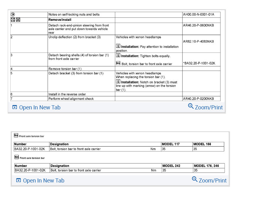

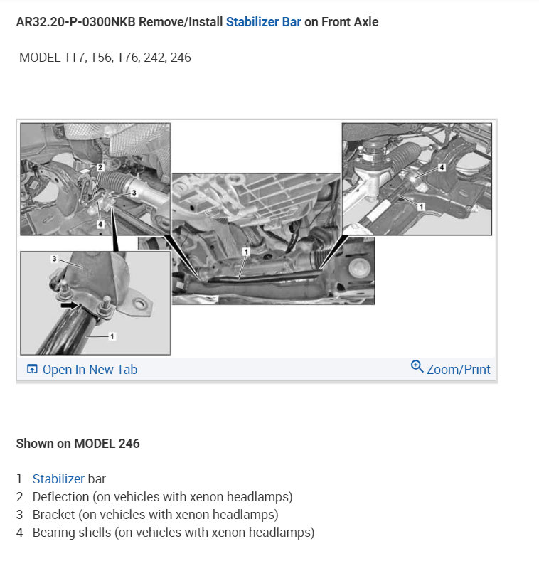

Sway bar snapped off
90,000 MILES • 2.1L • 2WD • AUTOMATIC
IBBOLUFC
Sway bar completely snapped off driver front side.
Jul 7, 2022 at 8:06 PM
  • 55,721 POSTS
Yep, it happens, all you can do is get a new one and install it. Here are the instructions in the diagrams below. Check out the diagrams (below). Please let us know if you need anything else to get the problem fixed.
