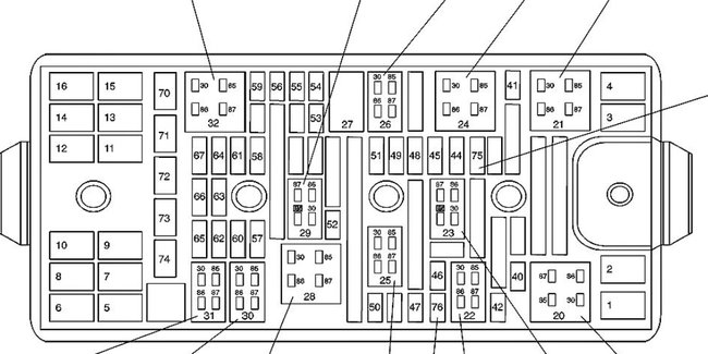

Let's first start by checking the fuses. Here is a tutorial showing how to check a fuse:
I've attached a picture of the fuse box. The fuse box is located under hood. Check fuse location number 56 and 59. Keep us updated after performing the fuse check and we'll go from there. Hope this helps and thanks for using 2CarPros.
Sep 30, 2020 at 3:28 AM
BISHOP BILL
Still have the same issue. fuses are good.

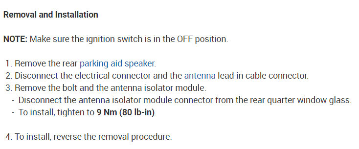

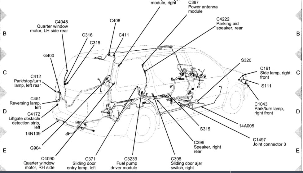

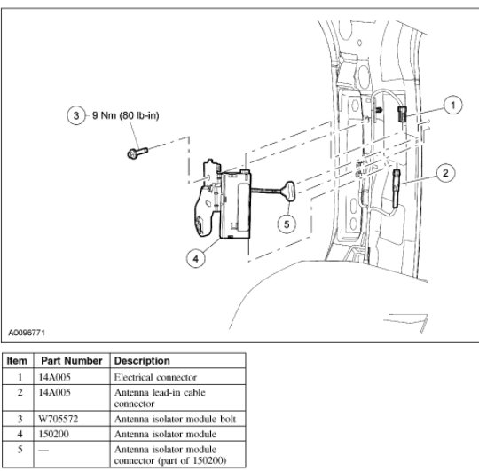

DANNY L
  • 5,648 POSTS
Hello again.
It sounds like you might be having a problem with the antenna isolator module. I've attached pictures below of the location and how to replace. Hope this helps and thanks again for using 2CarPros..
Danny-
