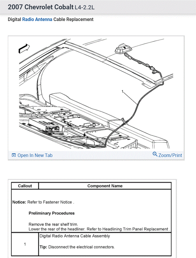

Need to replace antenna cable but can’t find a route diagram.

That one goes from the rear shelf, along the B pillar, and under the headliner. Take a look at the pic below. It provides directions for replacement.
If this isn't what you are looking for, let me know.
