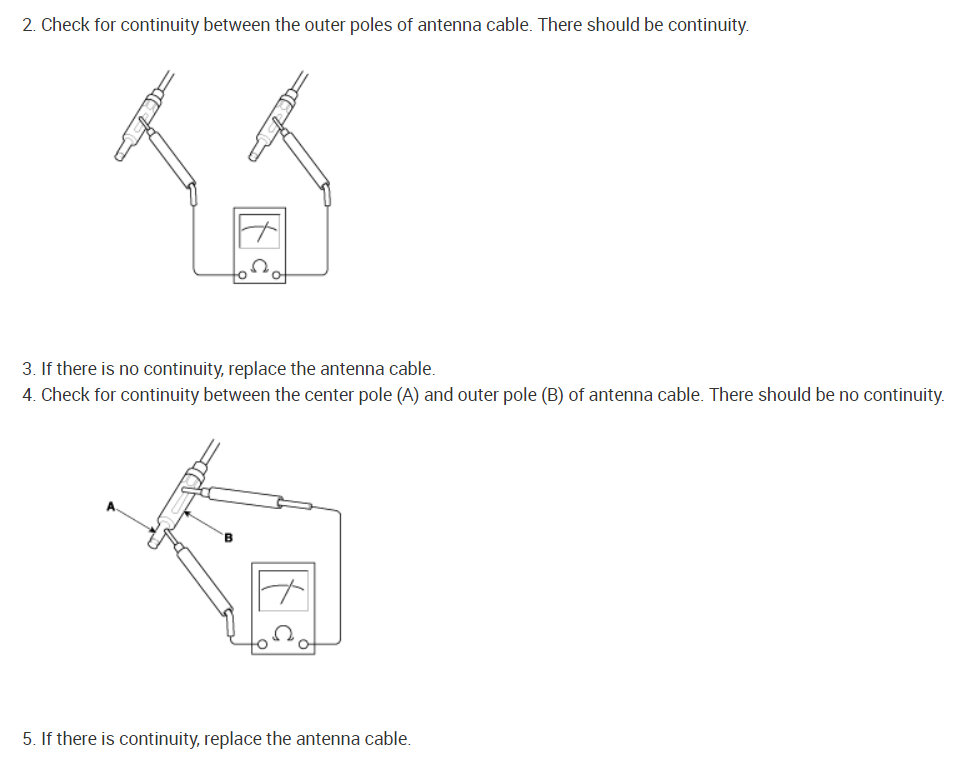

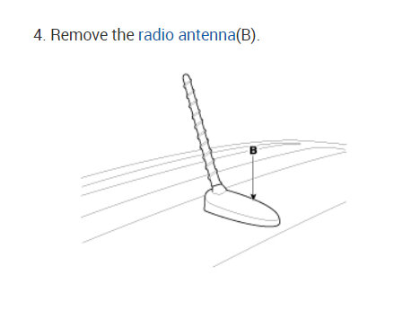

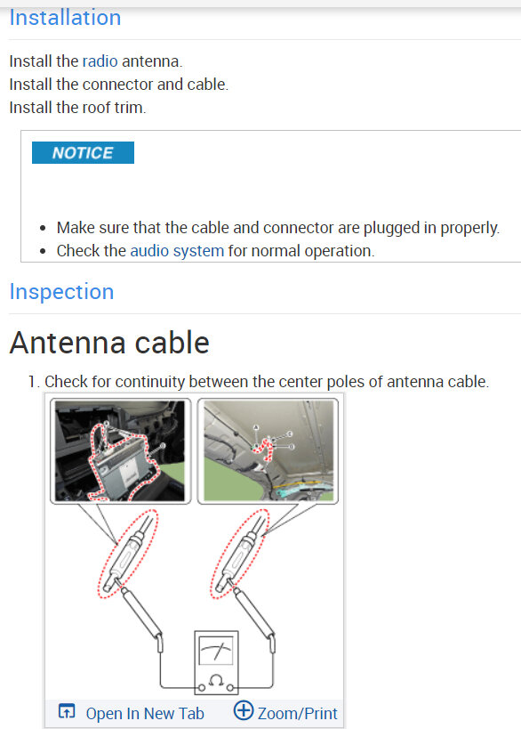

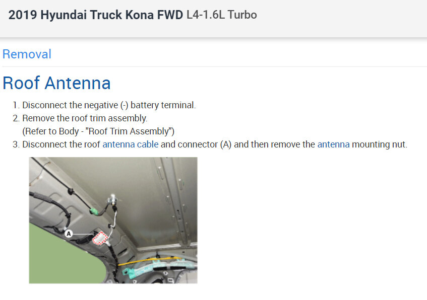

I want to replace my antenna with a shark fin but I can’t find the right part.
Sep 7, 2024 at 10:20 AM
  • 55,423 POSTS
Here it is on Amazon for $17.00:
https://amzn.to/3z8ZOJw
Here are the instructions on how to change the antenna out. Check out the images (below). Let us know if you need anything else.
