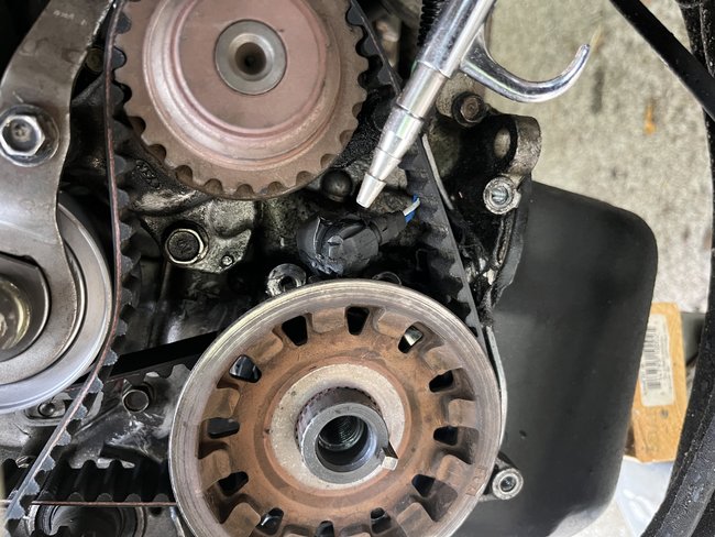

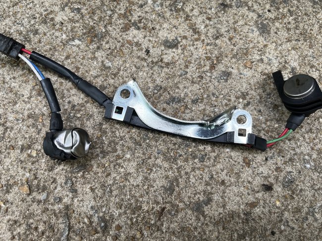

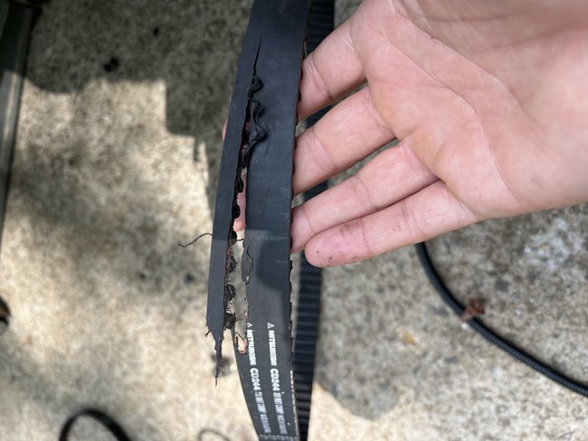

So, I went to take a video of the car cranking but when I was doing it, I heard a clunking sound coming from the timing belt area. Once I got everything torn back apart, I discovered that the crank position sensor had been destroyed in the same fashion the last one did as well as the timing belt being shredded again. I'm assuming the sensor is what caused the belt to shred but I'm not sure what's causing the sensor to break free and get damaged.

Definitely, the was a timing issue. How was the sensor broken? Did it come unattached or did it stay attached and something hit it? Was it the CKP or TDC sensor?
Also, was the timing belt broken? I'm asking because this is an interference engine.

Here are some pictures of the sensor and timing belt.
May 20, 2022 at 12:30 AM
  • 110,240 POSTS

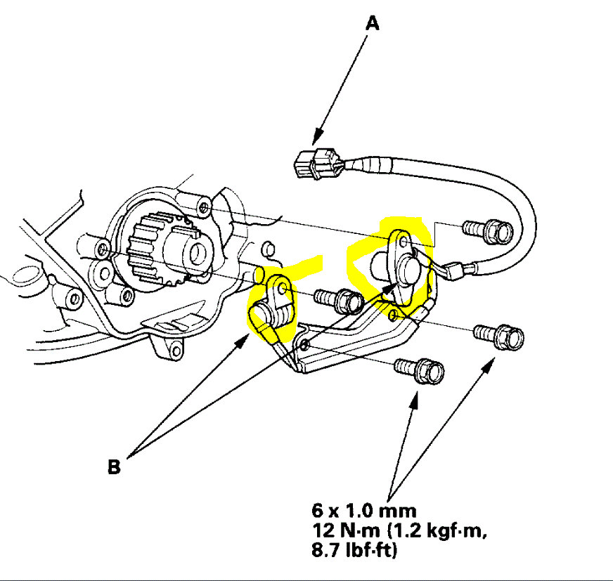

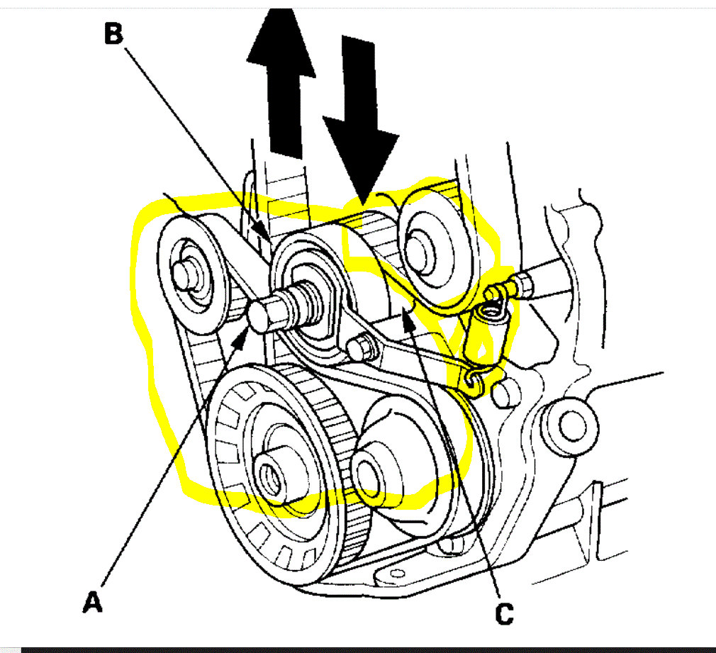

That is definitely an issue. Is there any play in any of the pullies, including the balance shafts? Also, is the tensioner fully secured?
Looking at your pics, it looks like the TDC sensor is being hit from the bottom, but I can't tell for sure.
See pic below.
