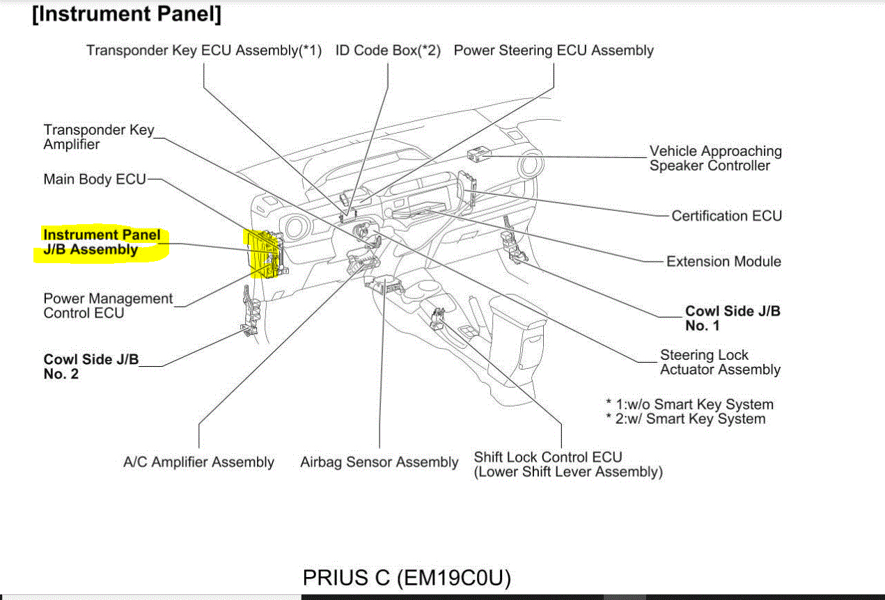

This may be a bit tricky. Let's start with checking the fuse box at the end of the left side of the dash. See if the sound comes from there.
If that doesn't help, in that box, locate the brake light fuse (7.5amp). Remove it and see if the sound goes away. (See pic below for fuse box location)
See pic below. My manual doesn't provide the fuse layout. Also, when that fuse is removed, the brake lights should not work. Don't drive it until it is reinstalled. I'm just trying to determine if the beep you hear is being powered by that circuit.
Also, let me know if this happens in any gear or is it specific to reverse, if there are any warning lights on, and if you have had the computer scanned to see if a code is stored in the ABS module.
See pic below .

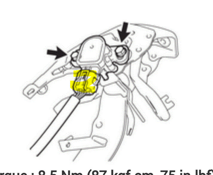

Are you referring to the park brake switch? If so, it is located at the top of the brake pedal lever. See pic 1
Locate the switch and see if that is where it is coming from.
Feb 9, 2022 at 6:21 AM

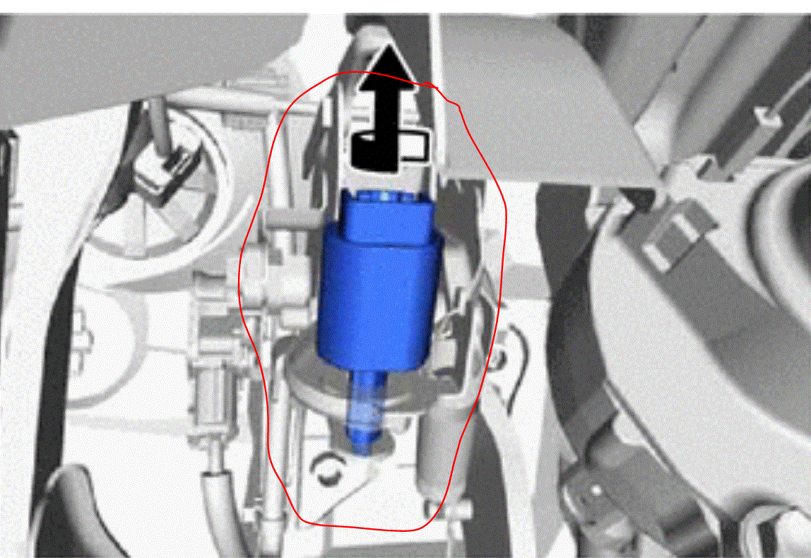

Here is what I need to try. There is a chance the brake light switch is causing a short. I need you to disconnect it and see if the sound stops. Do not drive it with that off. It needs to be reconnected before driving.
See pic below. The switch is at the top of the brake pedal.
Feb 19, 2022 at 11:51 AM
