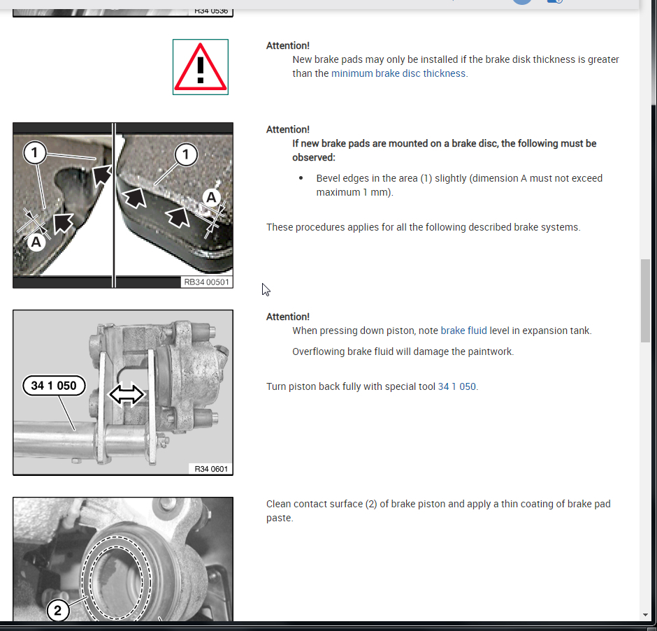

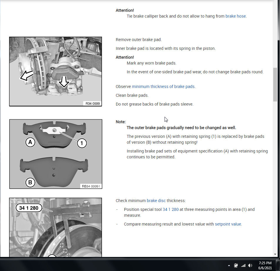

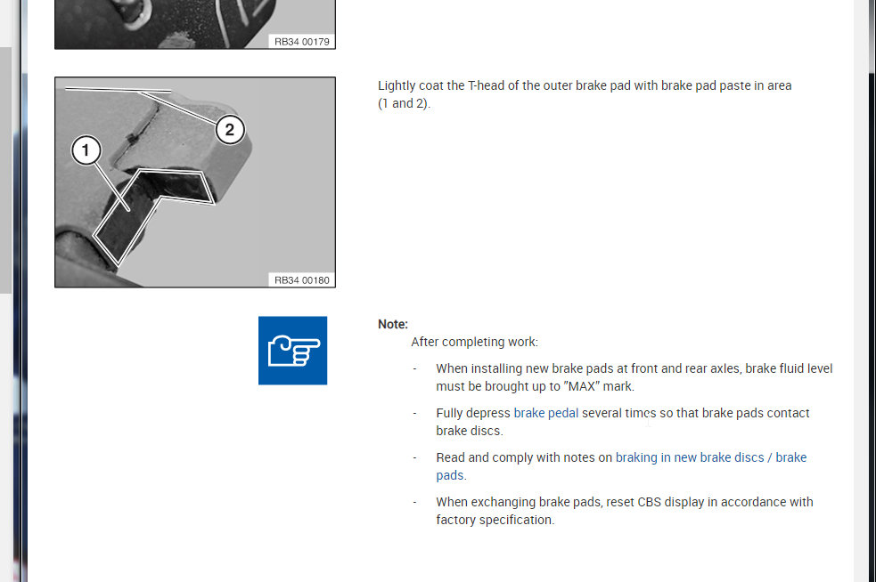

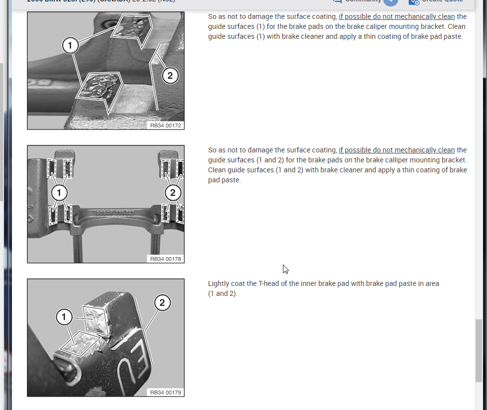

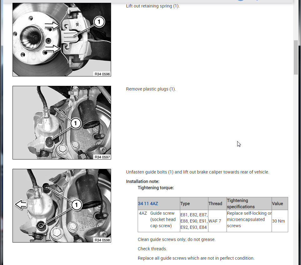

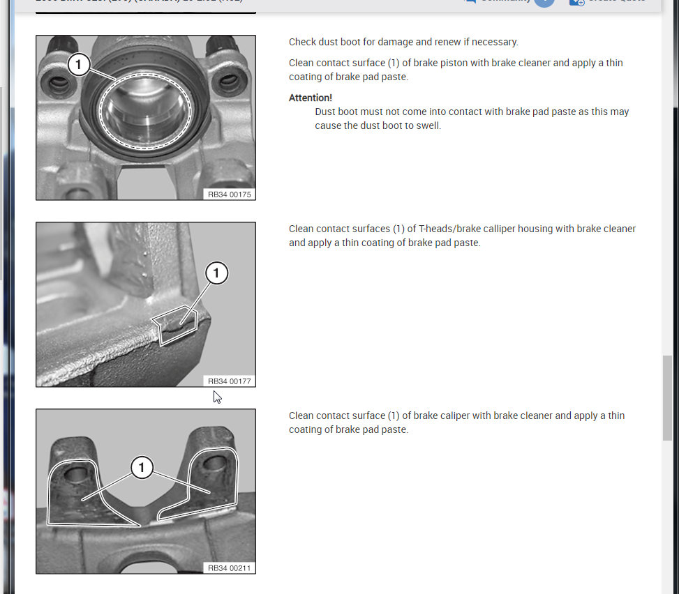

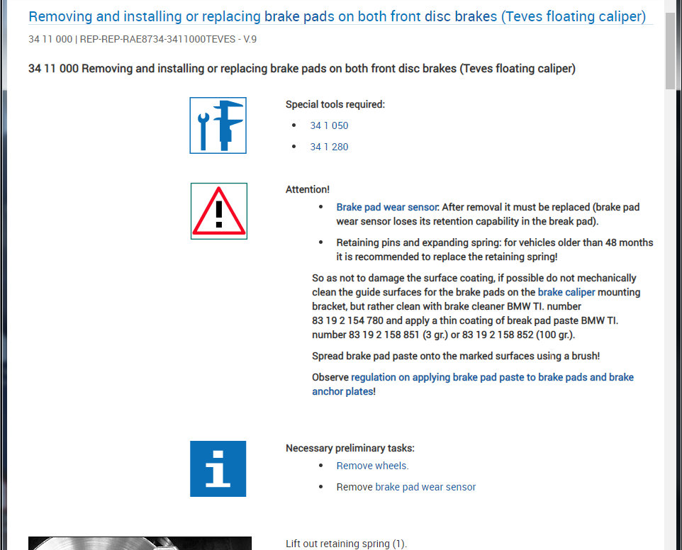

The shop says I need new brakes I want to do the job myself can you help me please?
May 16, 2017 at 6:47 AM
Here is a guide that will help with step by step instructions on how to replace front pads and rotors:
Here is a video on an M3 which is going to be similar:
https://www.youtube.com/watch?v=3VWVmqKiScI
Below is the process from the manual that will give the additional details to accomplish this.
Please let us know if you have other questions. Thanks
