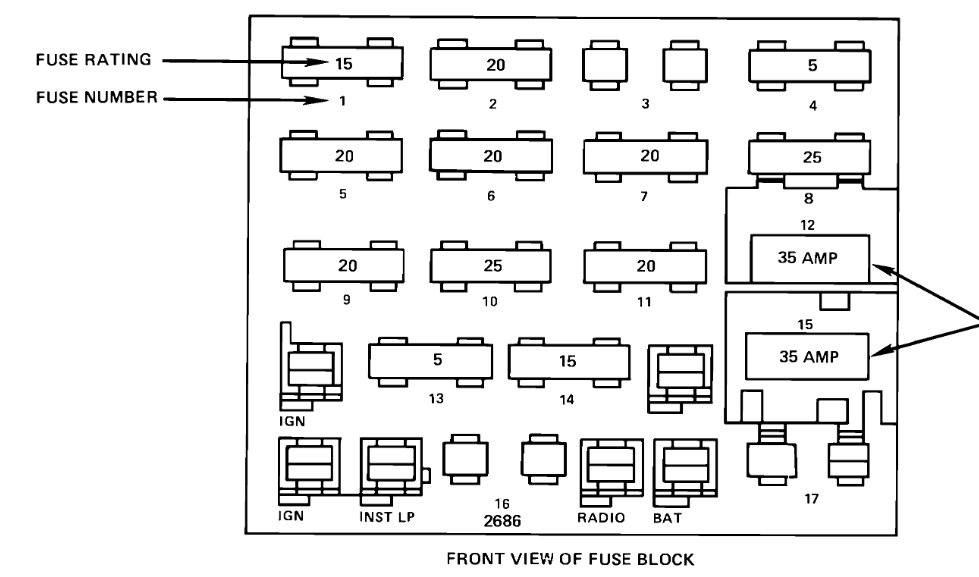

Not getting power to half my fuse panel even with key on

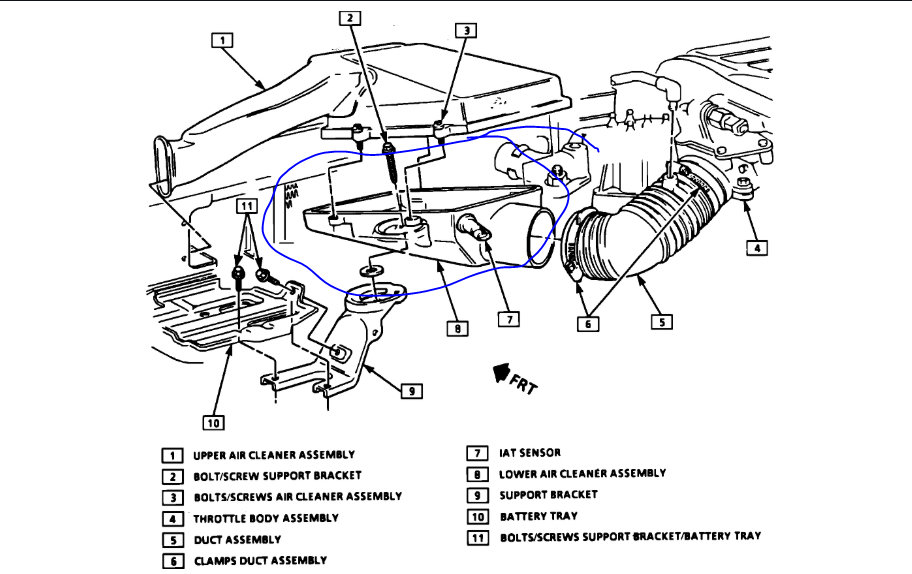

Okay, how much fuel pressure? Try spraying some starter fluid in the air filter and see if it starts and stalls.
Nov 16, 2019 at 1:18 AM
LISA MARTINEZ
  • 23 POSTS
60 psi after fuel filter under car and 42 at Shrader valve. And can hear fuel pump prime when turn key to on not start.
Nov 16, 2019 at 1:32 AM
LISA MARTINEZ
  • 23 POSTS
Spray staring fluid where air filter is in box?
Nov 16, 2019 at 1:35 AM
I attached a picture for you.

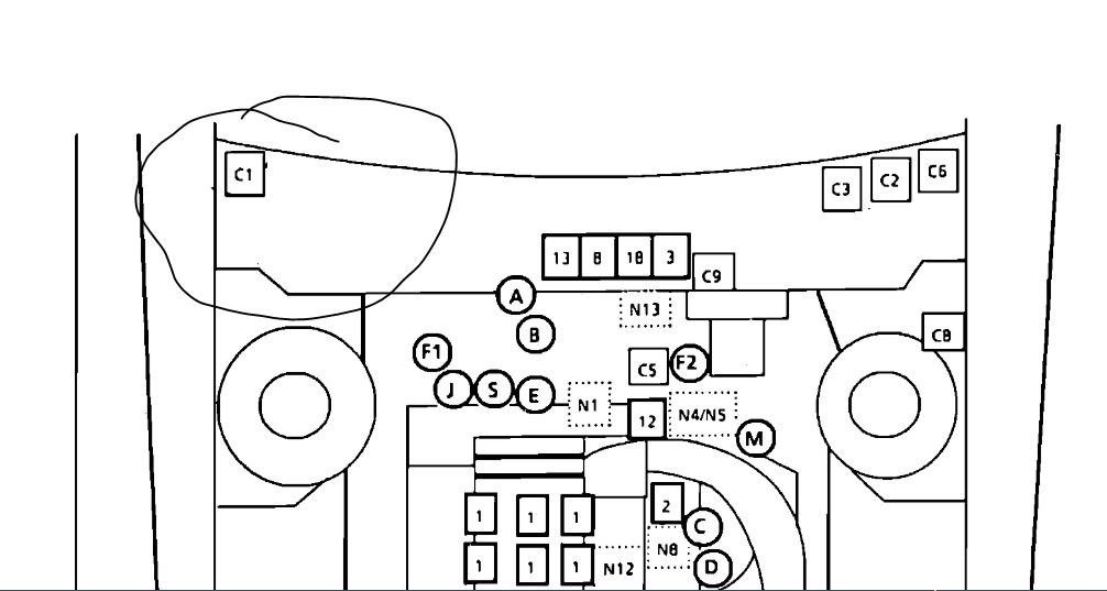

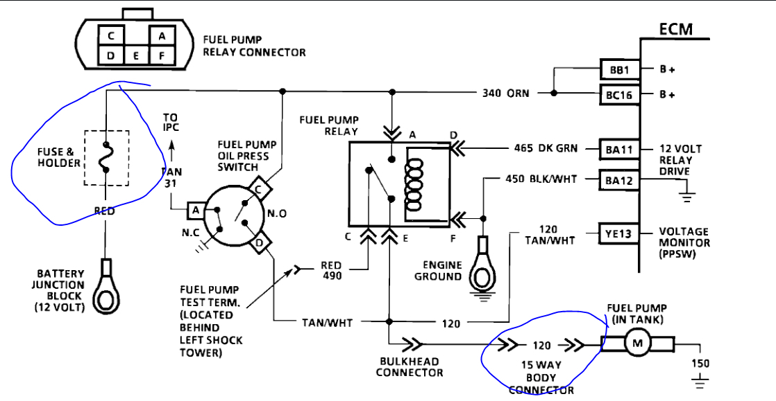

Okay, you need to verify power to the pump before assuming it is the pump.
I attached a diagram for you to view. Check the fuse I circled. It is off the starter motor.
If you have power to the pump, then yes, it needs a pump.

Figured if I can hear the pump it getting power, now I can really hear it. Connector to fuel pump is easy to reach under trunk. It has three wire , purple, light blue and a black or big green.
How would I test with multi-meter?
Nov 24, 2019 at 8:07 AM
The purple is the sender. Check the other 2 wires for power.

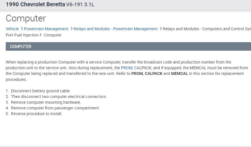

Okay, good chance the ECM is the issue. It is what controls firing the injectors. If you have power to the pump and it is running and there is no fuel in the engine, then we are down to the ECM.
Dec 16, 2019 at 3:52 AM
LISA MARTINEZ
  • 23 POSTS
Is there any way to test computer, to verify it's the computer and not the wiring going into it?
Dec 16, 2019 at 1:02 PM
No, specialized equipment is required for testing the ECM. You can only test the inputs and outputs to verify it as the failure as you have done.
